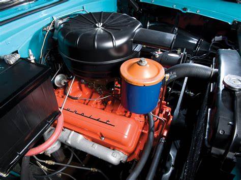

  23. LOU WELLS
    Joined: Jan 24, 2010
    Posts: 3,957
    LOU WELLS
    from IDAHO
    The 1955 Chevy 265 Is Unique In That The Block Does Not Have Provisions For A Oil Filter And Is Optional And Mounted On The Intake Manifold...Which Is Also Unique.. th.jpg

  25. Speed Gems
    Joined: Jul 17, 2012
    Posts: 7,345
    Speed Gems
    Theirs a good thread on early 265's on here, if I can find it and the pictures aren't all gone.:mad:
