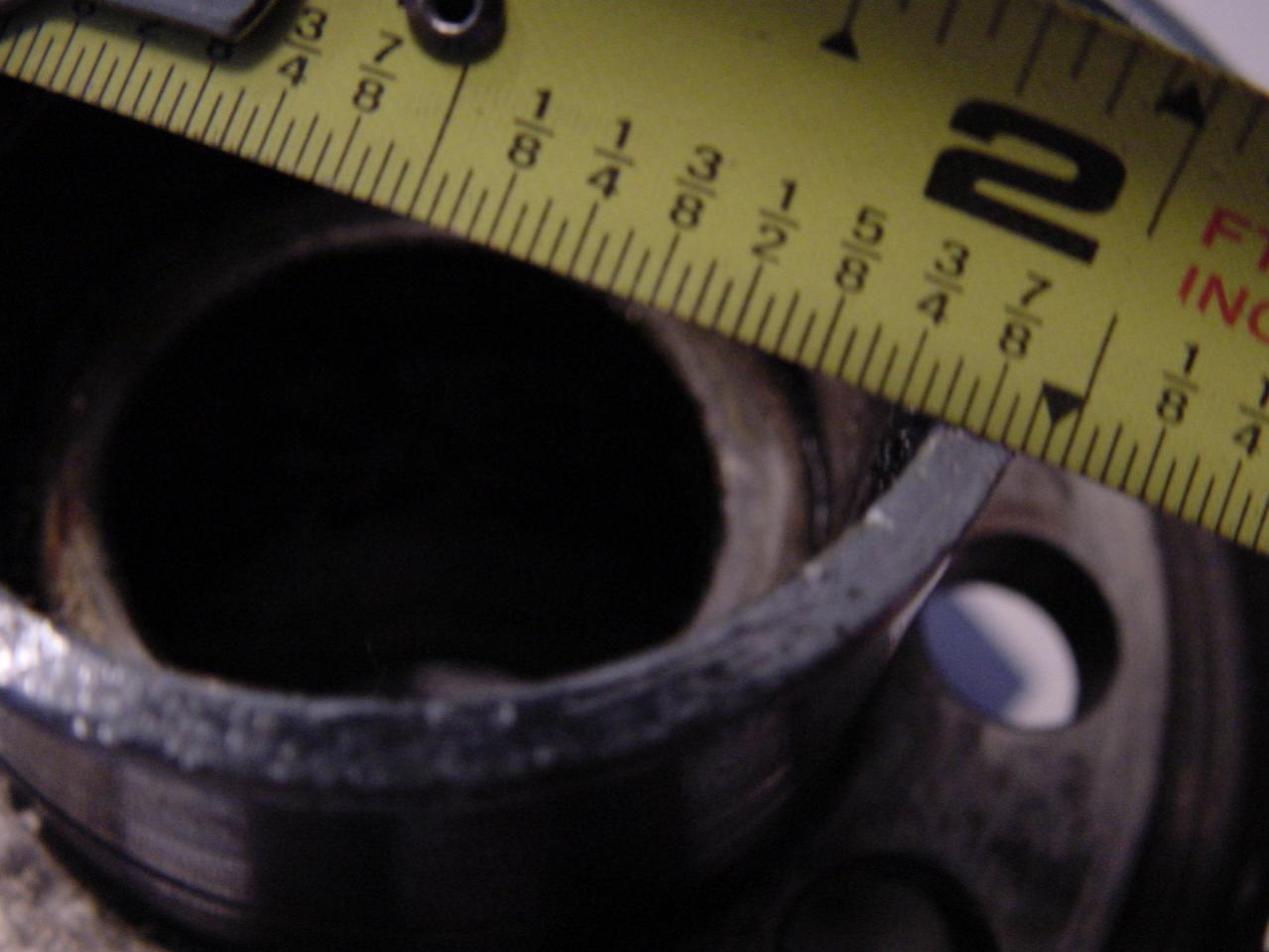

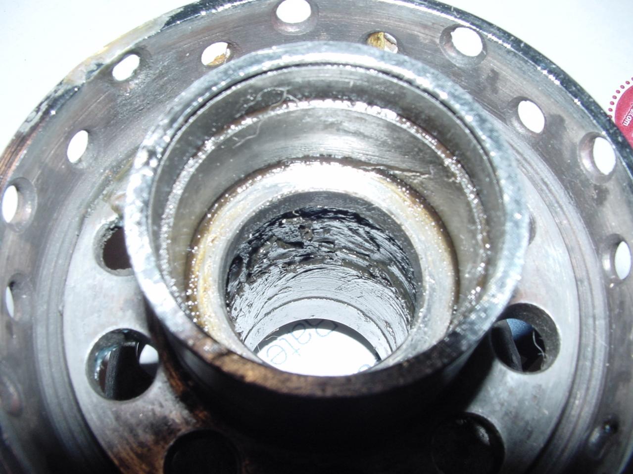

    Ok ,,seen alot of post on such but,,trying to understand it all. These spindles are made for 3/4 inch axles so I figure one end should be no issue with the hubs stock bearing ( outside side ) But for the inner I'm thinking all I have to do is fine a bearing that fits the inside of the spindle and fits inside the hub right?? :eek:

    cool,, the hubs is about 5-5 1/2 end of bearing to bearing ,, not sure how wide stock Ford hub is,,figured I could put a spacer on the outside end to take up any shortness ?
    And have to find out what size the inner bearing is

    dragster front wheel :) these are easier ( in my opinion ) to work with than the VL hubs.
    They ride on a 3/4 axle so i figure im already set on one end just a matter of matching up bearings for the inside

    anybody know what size the inside bearing is ?
