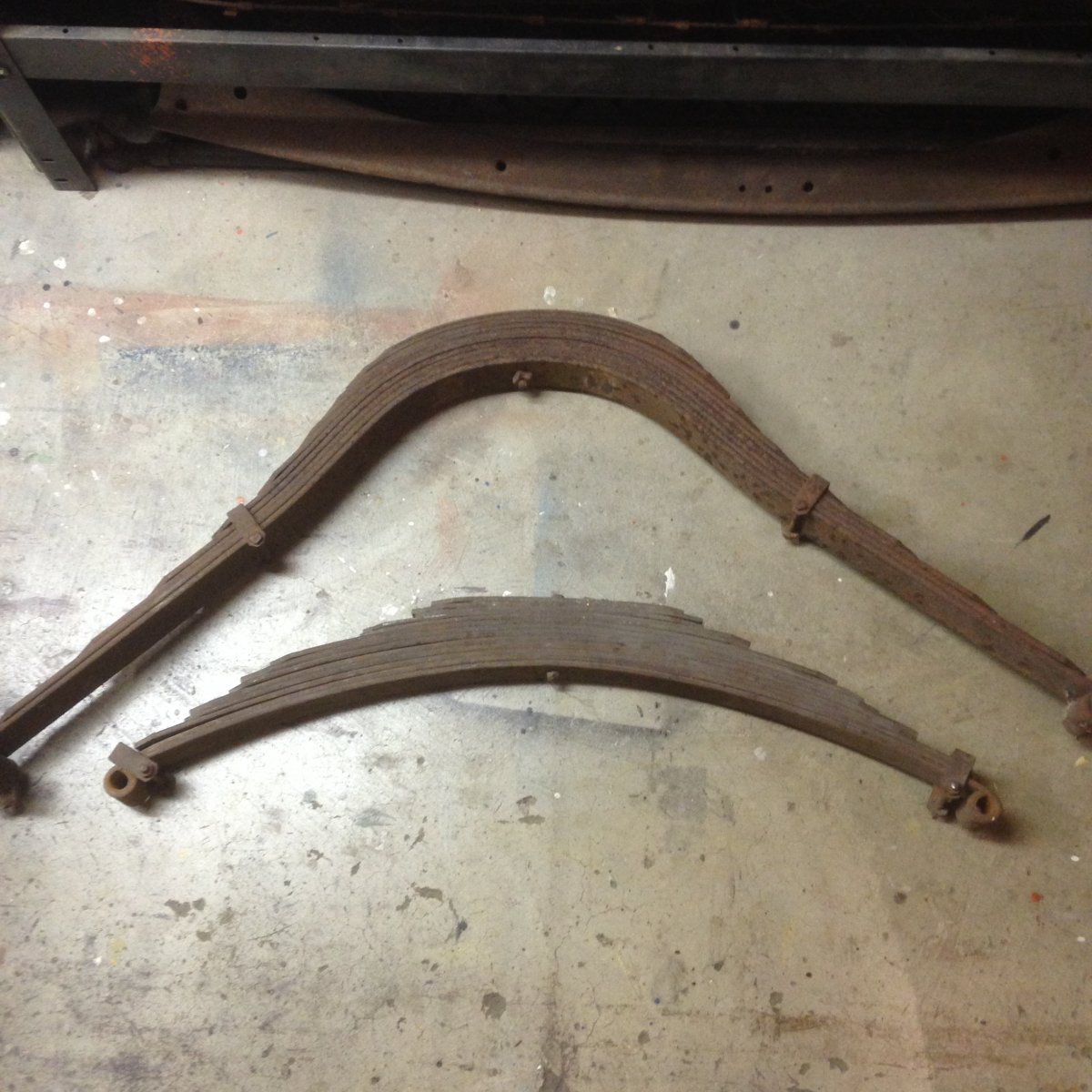

    Man I’m stumped. I started with what appeared to be a model A front sprongnwith some extra leafs. Figured AA or accessory pack.
    Well it’s on an A axle and the shackles are pushed down to somewhere in the 26-30 deg range nearly bottoming out the travel of the shackle.
    Not only that but it sorta kinda high for a pack with 7 leafs and a reversed main.
    I’ll try to find a photo of what I started with as I’m sure that’ll help

    Bottom one obviously ;)
    The extra leafs over what stock p***enger car should be were duplicates it’s pretty easy to see the steps were they are in the photo
    -I’ll add they are all stamped ford

    This is it on the car. Dropped A axle, 46 wishbone, speedway hangers. Nothing that hasn’t been done a million times before. DAEDB6EC-0EF5-4FFD-8839-EA6AF6968EC4.jpeg I pulled a bunch leafs, radiused the leafs on the ends- rounded the tips and rounded the contact side of the edge- reversed the main and cut the one just over the main back to clear the reversed eye.
    I’ve got a lot of hours in this spring pack so I’m hopping I’m just out the time reversing an improper main and not the whole thing.

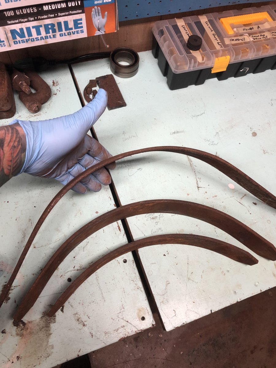

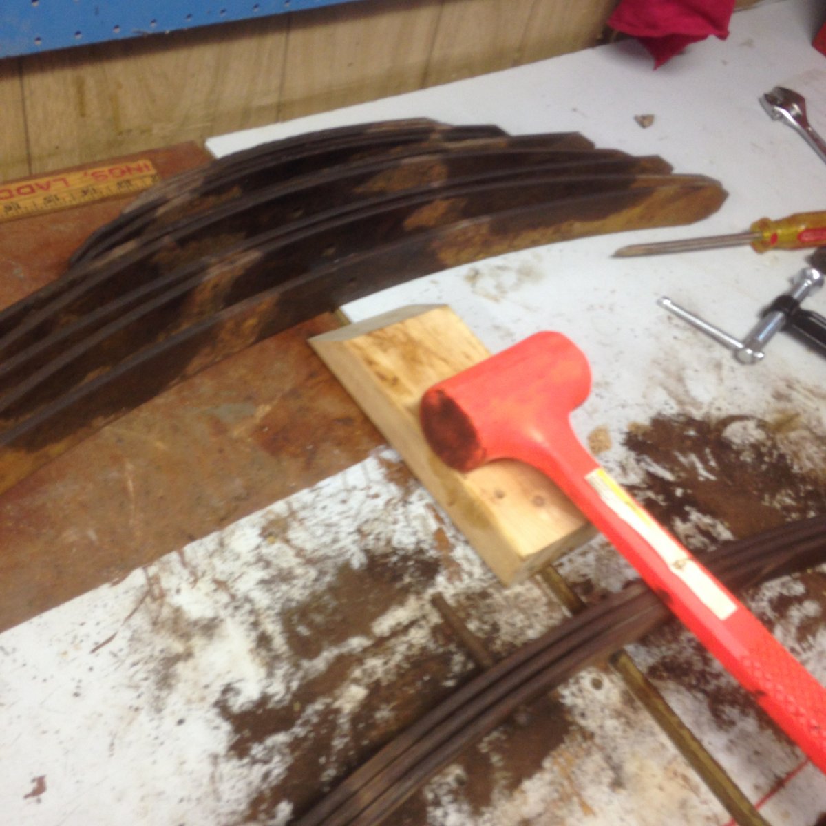

    Photo from taking the pack apart. I went threw a few more photos to confirm they were all shaped the same with the slanted corners. I still have all the leafs I pulled in the shop somewhere but this photo shows it well enough I think.
    The pack had 13 now is has 7

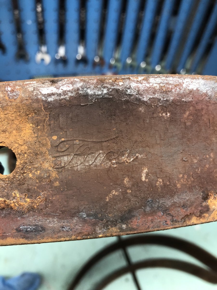

    Where would someone look for a model A stamp on a leaf? I’ll find the lose ones I took out and look at them later

    Also dig threw the pile of leaves I removed from the front and back and the only one I found stamped ford was from the back. Maybe I just found them on the back ones.
    83CA7544-7BF7-48CF-B542-76A1A1CBBC13.jpeg Stamped both sides of the tie bolt on the top of each leaf. 2EEEB6BD-6C63-45B4-8C28-B48B4FC2DF17.jpeg the one I’m holding is the one I photographed so it’s a few in, it’s not like it was just the main or top
