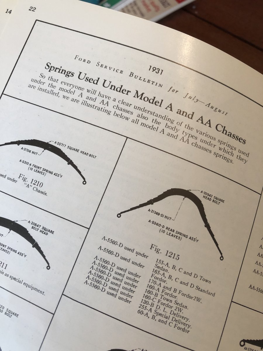

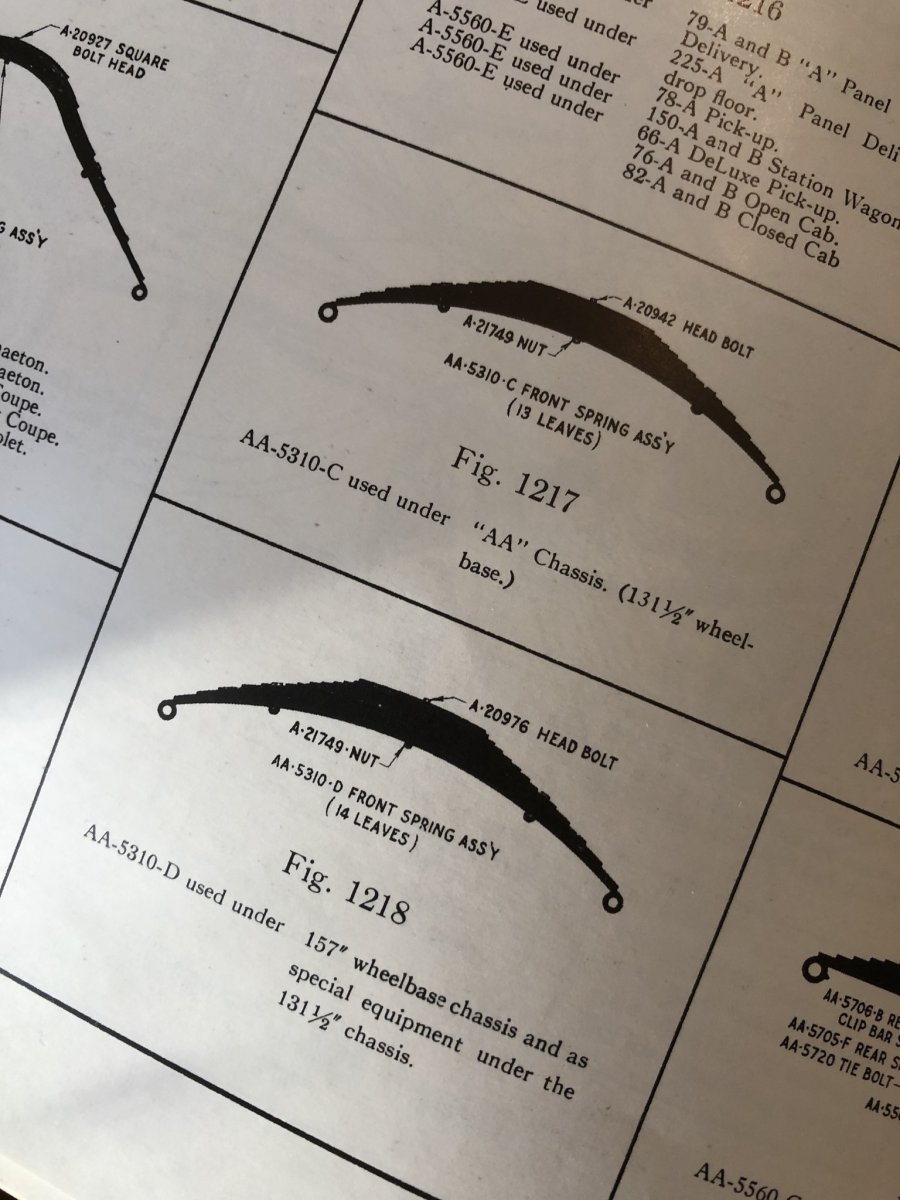

  15. Tim
    Joined: Mar 2, 2001
    Posts: 21,575
    Tim
    from KCMO
    Thumbing threw a book I found my front spring! 7C5E12F6-F85C-4A05-AB19-8D4CA7A47497.jpeg 270FC775-68DF-417E-A15A-26CBDCCB407F.jpeg D9B0D61A-A96B-41BC-877A-C9E838335148.jpeg so BIG model AA
