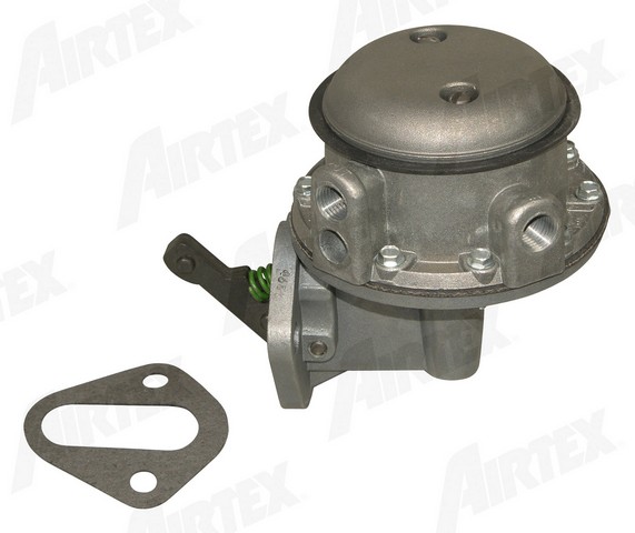

    Which is the better of the two mechanical fuel pump styles? Is it just a matter of preference? I do like the one that has both inlet and outlet as threaded, and would prefer that.

  2. One can be rebuilt and one can't. The later model pumps wee made to be throw aways while the earlier model pumps were designed in a time when [people regularly rebuilt things as opposed to just replacing them. I am not sure that you can get diaphragms and springs for them any more though.

    I wonder, can you clock the rebuildable one as you need it?

    The rebuildable ones are the way to go--they can be clocked as well. There are some for 5/16" fittings and some with 3/8" . We use the ones with 3/8"

    Is the bottom one a Carter?

    That specific one is an Airtex, but I have seen them as AC Delco as well.

    I always try to use the rebuildable style pumps for just that reason; you can re***emble them to point the fittings where ever it works/looks best. Plus they fit the look of an early engine better.
    There are adapter fittings available for AN, tube flares and all kinds of stuff......
