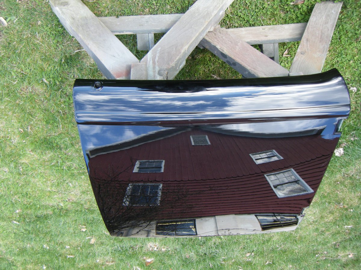

    make it shiny.......black is all about the colors its reflects. DSCF4969.JPG DSCF4971.JPG
    snopeks garage and heavydumper like this.

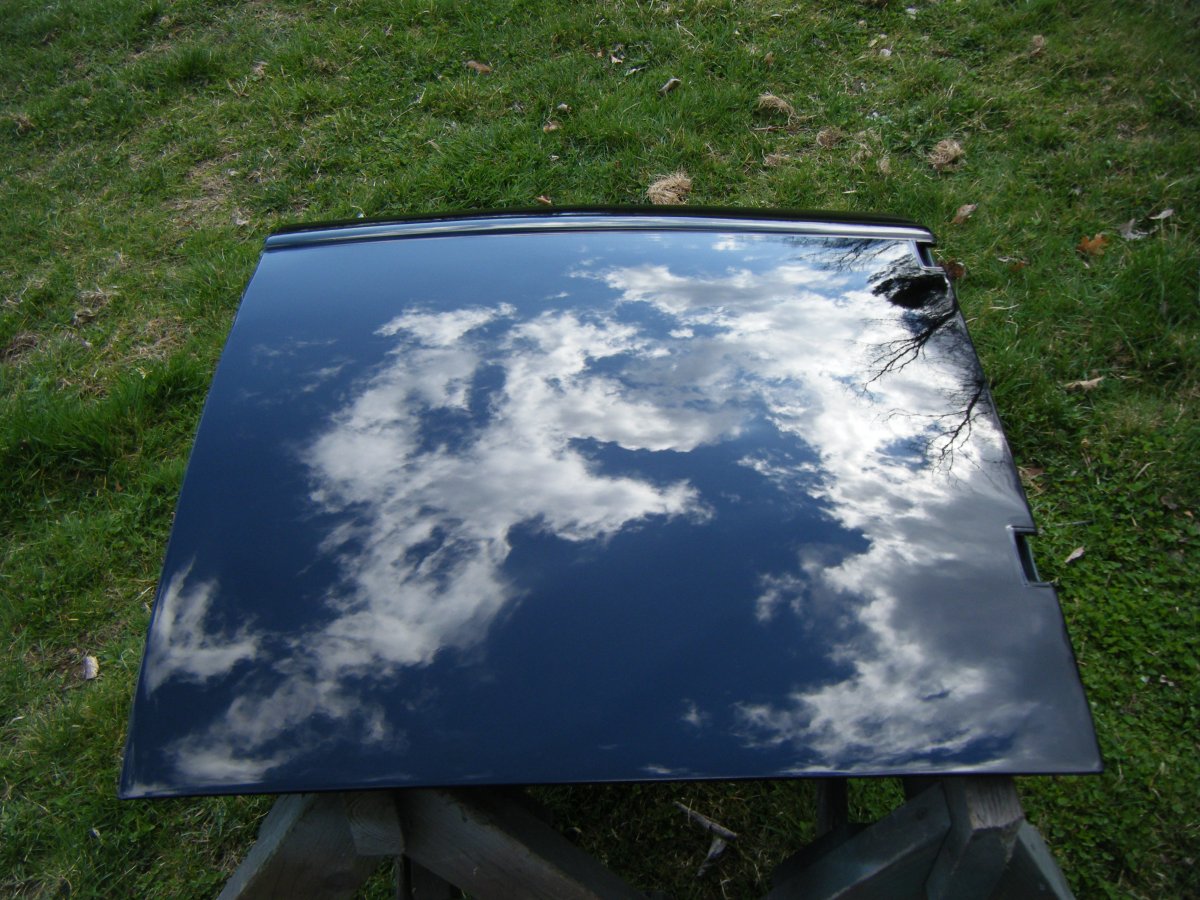

    these were all shot with ppg 9300 [?]dcc acrylic urethane. DSCF1979 copy.jpeg
    snopeks garage and kidcampbell71 like this.

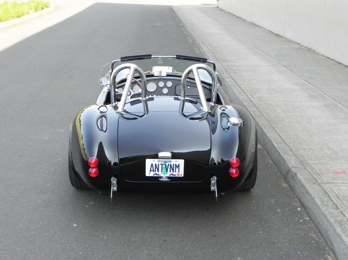

    I painted my last car, FFR Cobra a Sherwin Williams "Deep Black". I've never seen a black that deep before. It kinda messed with your eyes. It was hard to focus on the paint since your eyes wanted to focus in on the background reflection. Many long hours of buffing with very bright lights to get it just right. Pictures just don't do it justice. rear up.jpg
