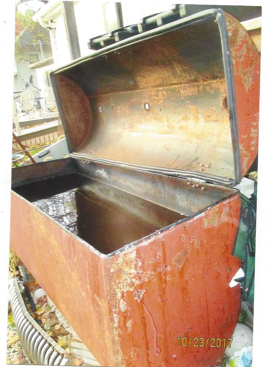

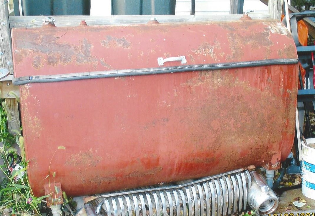

    Update. Here is my tank. An old fuel barrel. I cut the top so it hinges. I used an old seal off the rear hatch off an Explorer. It blends right in with my gas pump. Scan0489.jpg Scan0488.jpg Scan0487.jpg

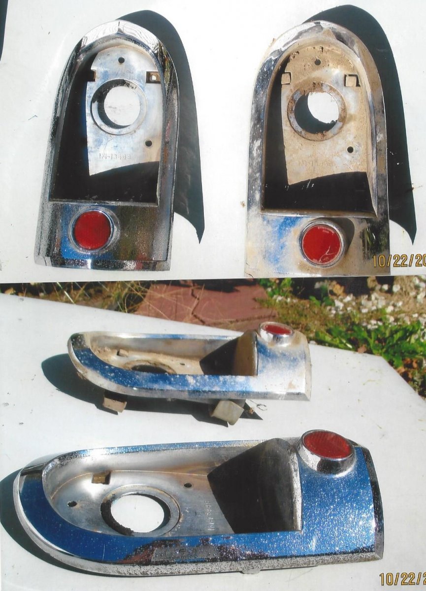

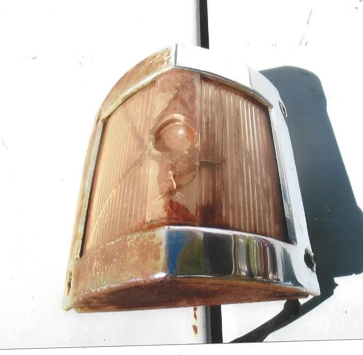

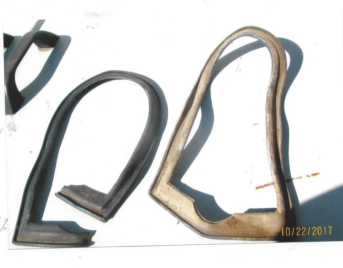

    Okay, I learned it does NOT work on rust. But it does strip paint and nasty under coating off of a guys 58 Pontiac hood. I let it soak in the tank for a week and then rotated it. My friend was real impressed as it saved him lots of time. We have his fender in there now. @alchemy To Neutralize it, Bill said to use vinegar. Here are some pic`s of some really dirty pieces I let soak in the tank for 10 minutes. I pulled them out of the tank and rinsed them in a bucket of water and wiped them off with a beach towel. The really nasty ones, I went over with fine steel wool to clean them up a bit. Spent very little time doing this. I spent about 4 hours claning lots of bits and pieces I had laying around. Mostly hood and trunk emblems. And tail light housings. Scan0490.jpg Scan0491.jpg

  23. stanlow69
    Joined: Feb 21, 2010
    Posts: 7,346
    stanlow69
    So what do you think. I was impressed. Scan0492.jpg It also works on worn out rubber tail light gaskets.---------It does eat up aluminum.
