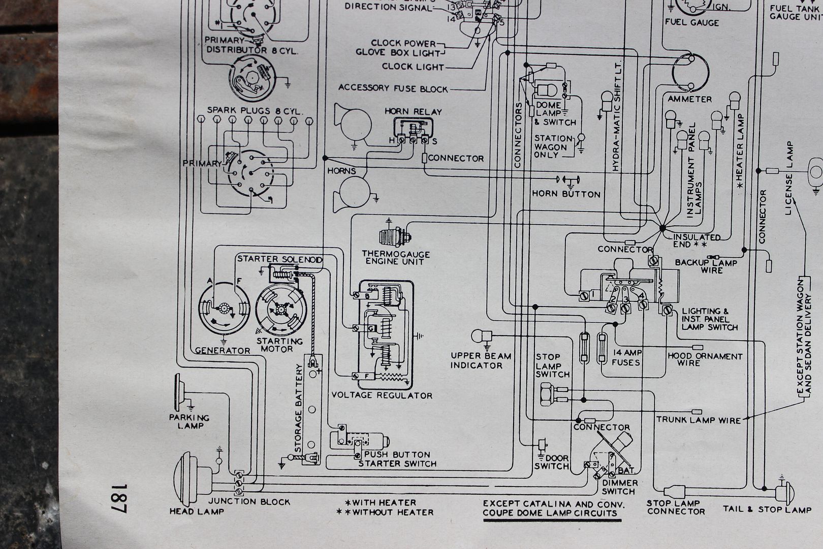

    I'm rewiring my 52 pontiac catalina, and I need help with the signals. There are 6 wires coming from the column, and it uses a 3 wire flasher. I know 4 wires from the column go to the front and rear lights, and 1 wire goes to the flasher. That leaves 1 wire from the column, and 2 wires from the flasher to connect. I know 1 goes to the brake light switch, and one is power to the flasher, but i, don't know where the extra wire goes, any help is appreciated.

    Maybe this will help.
    In Quarters:
    You should be able to save and print (or have it printed) the full page.
    There are extra wires shown as they showed both six and eight plus all models on one page in this diagram.
    Hope that helps.

    I think the 3rd wire from the flasher goes to the indicator light.

    That schematic does not show director tonal signals.
