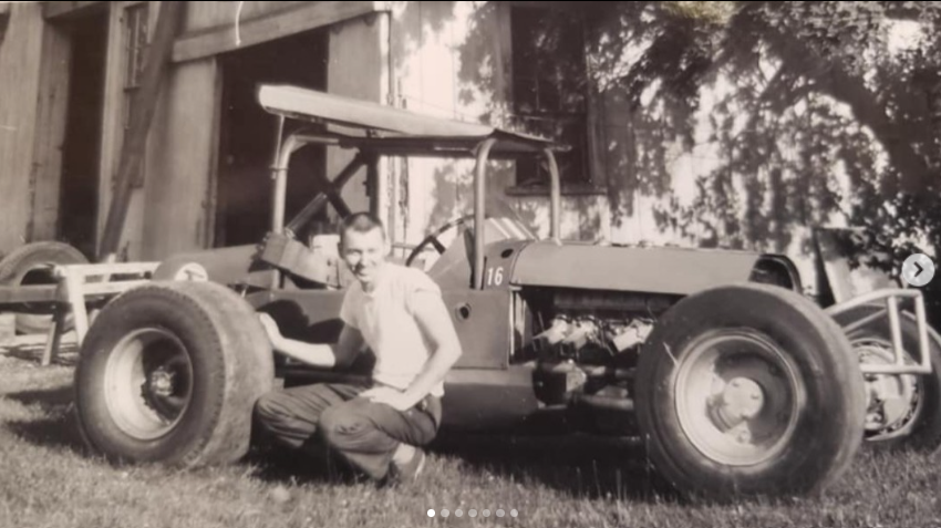

    I've recently acquired this killer Modified dirt car from the 50s-60s and I'm looking for information or input on the engine and intake that would have been used in it. I have one low res old photo with the engine still installed and it looks to be an inline stovebolt, I suspect it's a GMC, with an aftermarket 3 carb setup which I think is a McGurk. I know these are hens teeth but I have real American Doll Hairs I'm willing to part with if anyone is willing to part with their Prescious. FB_IMG_1742346902630.jpg Messenger_creation_3F26ECDA-BB23-4083-B667-572EE6BE3A56.jpeg Messenger_creation_DA12999A-FDE2-4438-B0B8-24E93DFC1F82.jpeg

  3. Moriarity
    Joined: Apr 11, 2001
    Posts: 41,117
    Moriarity
    SUPER MODERATOR
    I think that before you buy an intake for a GMC you need to determine if that is what the car had, could be a Chevy. perhaps you can measure the port spacing on the exhaust header. Or buy an intake / exhaust gasket and match it up

    I think that is solid advice. I've been trying to get some specs on those measurements. The gasket is a good idea, without those heads to measure, I am just guessing. One thing I read said that the Mcgurk Chevy intakes only had locations for 3 carbs and not 5, and I've seen that in pics of each. If I zoom in as much as possible, the one pic I have shows stud locations for 5 carbs. That and what I've heard is that the GMC was preferred for race engine builds. Thanks for the input!

  9. 302GMC
    Joined: Dec 15, 2005
    Posts: 8,612
    302GMC
    from Idaho
    McGurk didn't make that intake for Chev 6, only GMC.
    Count the freeze plugs on block. GMC has 5, Chev 2.
    Read the code stamped behind dist. - GMC engine size is the 1st 3 digits of engine #.

    Rather than look at the intake setup......the exhaust header may be the real key to investigating the engine. There seem to be four (4) exhaust ports and they have some sort of flanges on the ends of the pipes. What inline engines of that era had four exhaust ports ? I looked at Hudson, but it has intake and exhaust on p***enger side. What about Buick straight eight ? GMC or Chevrolet inline 6 engines did not have four exhaust ports spaced the way yours are. Also.....Mopar straight six......Pontiac flathead six.....Ford flathead six ......?? Great looking project by the way. Keep us in the loop. Have fun
  18. Moriarity
    Posts: 41,117
    Moriarity
    SUPER MODERATOR
    chev and GMC sixes have 4 exhaust ports, some are shared but there are 4 openings
  19. tractorguy
    Joined: Jan 5, 2008
    Posts: 1,096
    tractorguy
    Yes......I knew tha and misspoke because I was focusing on the separation in the ports which seemed equal and consistent rather than the spacing of the ports on the GMC and Chevrolet......someday I will hopefully learn more about effective communication !

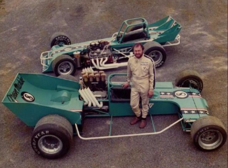

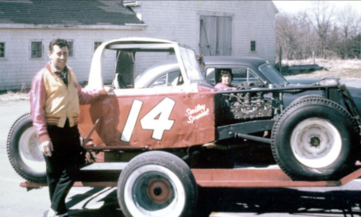

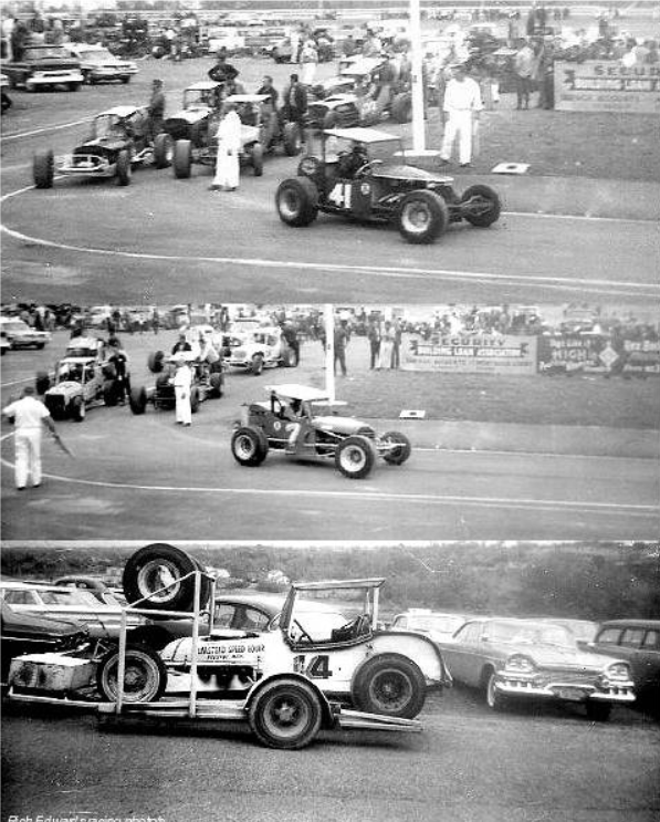

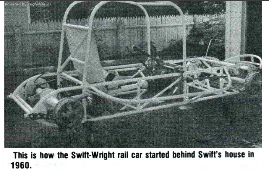

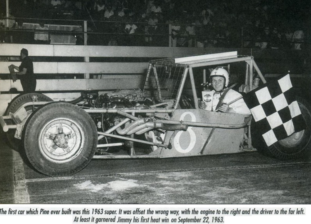

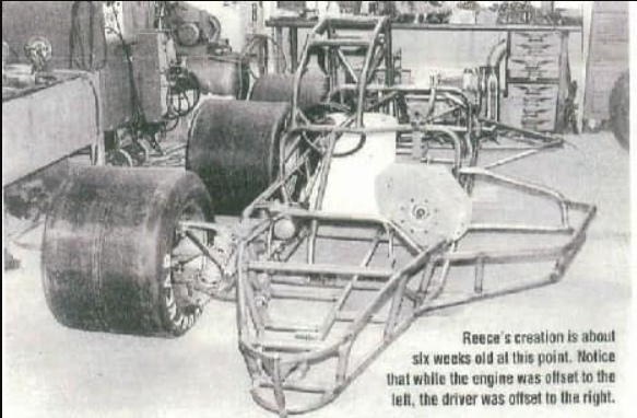

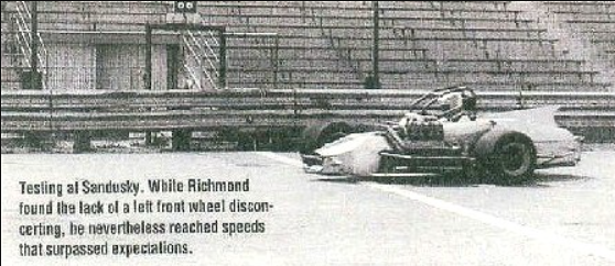

  21. Pushing vintage race cars in the Rotterdam Sqaure Mall for the Fonda speedway car show.
    That's a Super Modified also known as a Super Mod however depending on the part of the country you lived they went by other names.
    In the Northeast/West Coast they were known as Super Modifieds, Super Mods, or simply Supers.
    Some places called them Bug or Cut Downs (this was common in central/western NY.
    I have heard them call Seekters (mostly Florida)
    I have even called them Sprint Cars I think this is where the confusion comes from of calling Big Cars (Champ Car/Indy Cars) Sprint Cars.
    If you talk to any old-time open wheel racer, they will tell you there were Midgets and Big Cars until the mid to late 50s
    Sprinters didn't come along until the mid 50s.
    They also look very different depending on what part of the country you live in
    In California they were basically Sprint Cars with a narrowed T coupe body
    Supers started out as stock cars with the fenders removed, then the bodies being shorted narrowed eventually hand formed, engine set back laid over moved to the left, starts were dropped transmissions gave way to in/out boxes, and early on they got tube ch***is.
    Bud Hinman with his Super Mod
    Oswego Speedway "The Steel Palace" car mid to late 1950s
    Noland Swift's 10-Pins Oswego 1960
    Jim Shampine Oswego 1964
    Oswego 1964

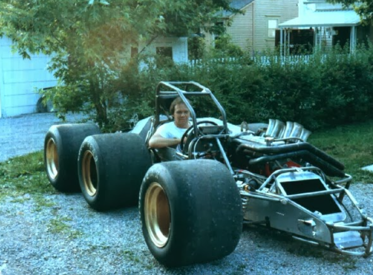

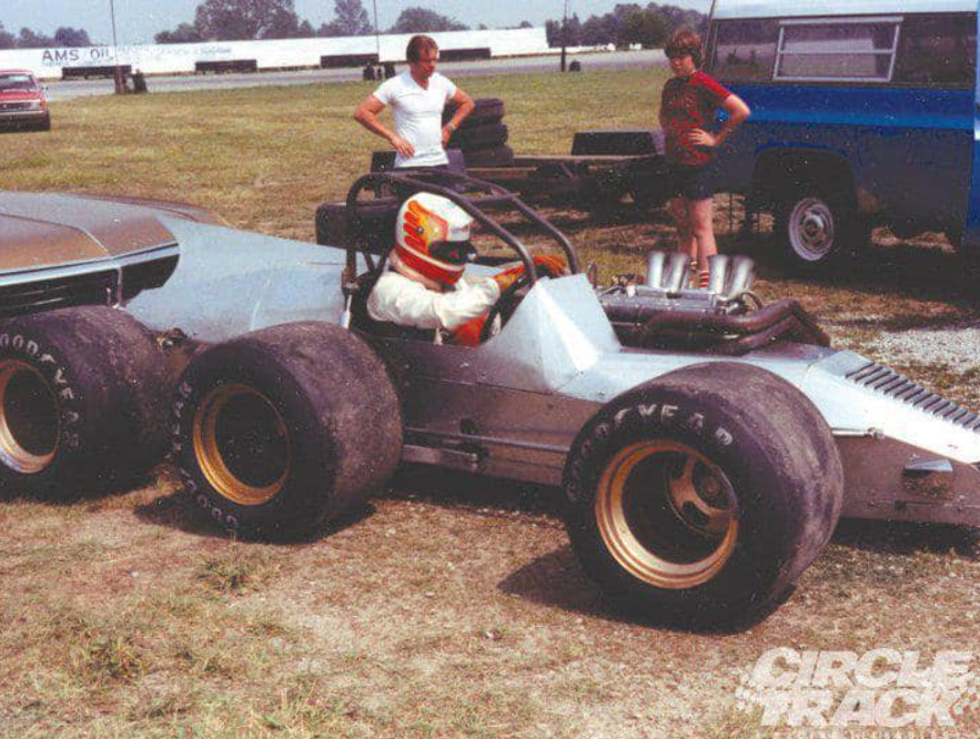

    Then things got weird...
    upload_2025-3-21_5-36-15.png upload_2025-3-21_5-36-41.png upload_2025-3-21_5-37-21.png upload_2025-3-21_5-37-56.png
