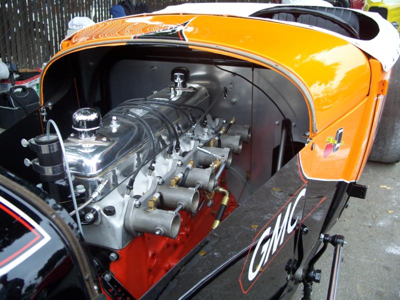

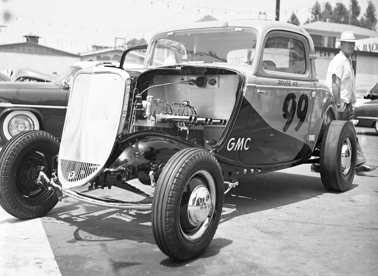

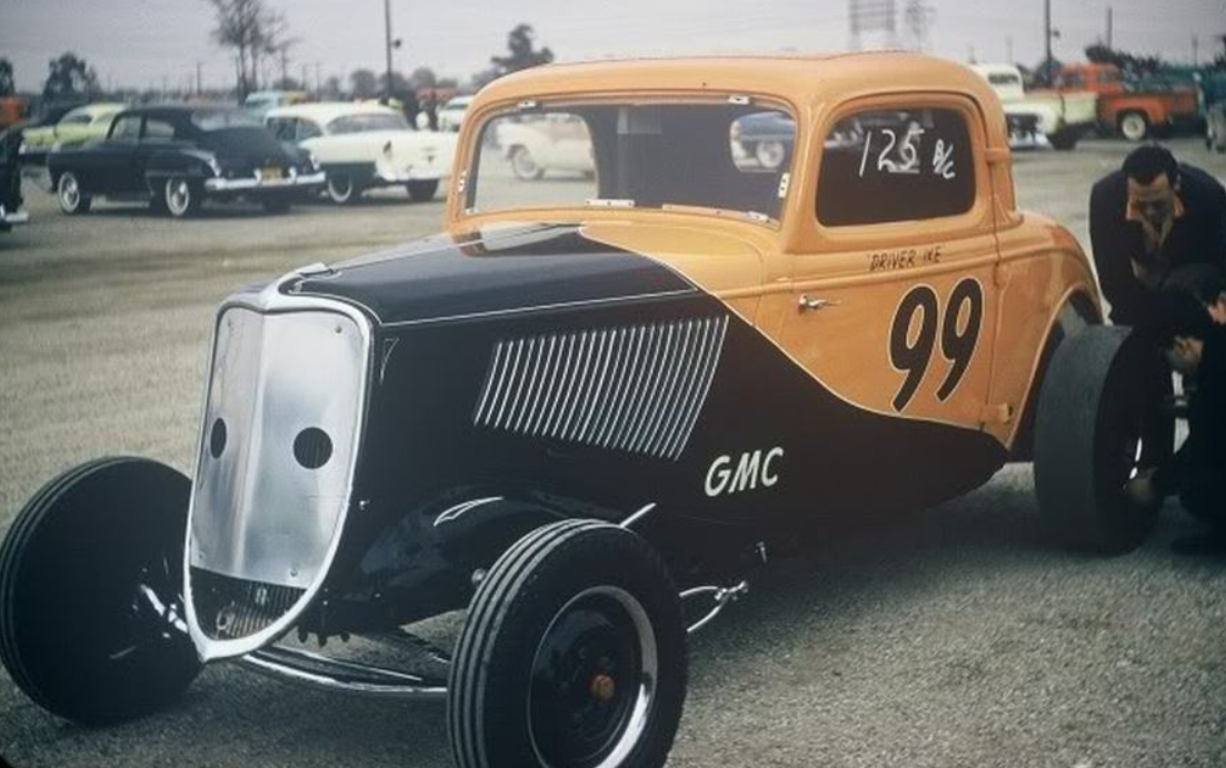

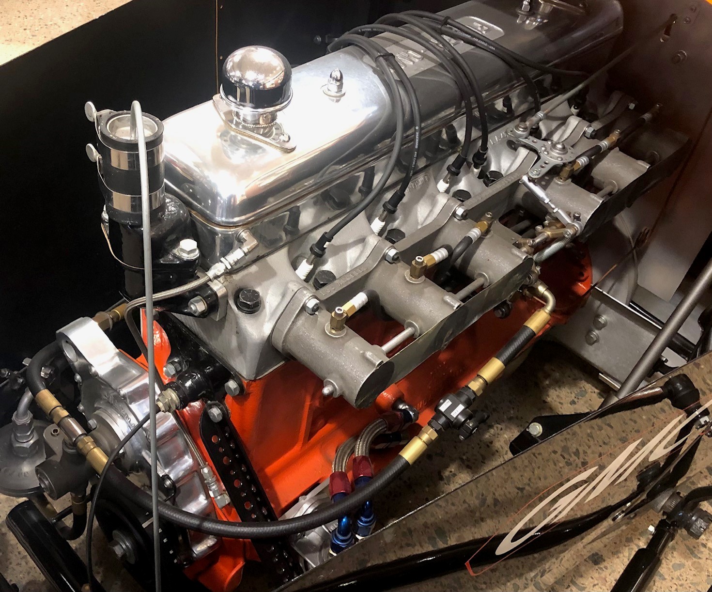

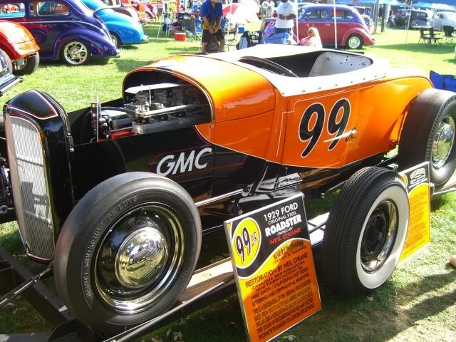

  6. @anthony myrick does have a good idea, Dale Lambrose roadster the sister to the Iacono coupe.
    Both cars raced with G.M.C.s with Wayne 12-port heads Hillborns and Uber rare Wayne timing covers-
    upload_2025-4-4_14-29-53.jpeg upload_2025-4-4_14-30-24.jpeg upload_2025-4-4_14-34-59.jpeg
    When the Lambrose roadster was first restored it was done with a stock head and a stock chrome timing cover until the parts could be found.
    G.M.C.s are expensive and always have been (most hot GM inline were BlueFlame 235/261s miss identified as Jimmys)
    However, you could always do a stock rebuild with a bit of a cam and a stock intake and have some fun with it.
    Cyclones are rare however there was one Facebook for about $400 two years ago, (I contacted the man but p***ed because I already had two and my property taxes were due)
    I am thinking that car weighs 2,500 pounds it doesn't take much power to scare you in car that only weighs 2,500 pounds.
    Not to mention if this car did race it is possible parts had to be changed to meet track rules.
    Going back to Fonda they had their own cl*** of late models (Points awarded as NASCAR hobby stock)
    These cars were more like sportsman cut front fenders 53/54 Chevy frames early Ford axles Flamke front ends.
    The rules were any post war body, engine and body had to match (Chevy in Chevy Ford in Ford) but any engine to 1960, quick changes legal.
    Other parts of the NY quick change rear were not legal in late models.
    Many of the Fonda late model guys had also had Timken all set up to swap in for tracks where Q.C. were not legal.
    Who's to say that it wouldn't be correct with a stock intake.

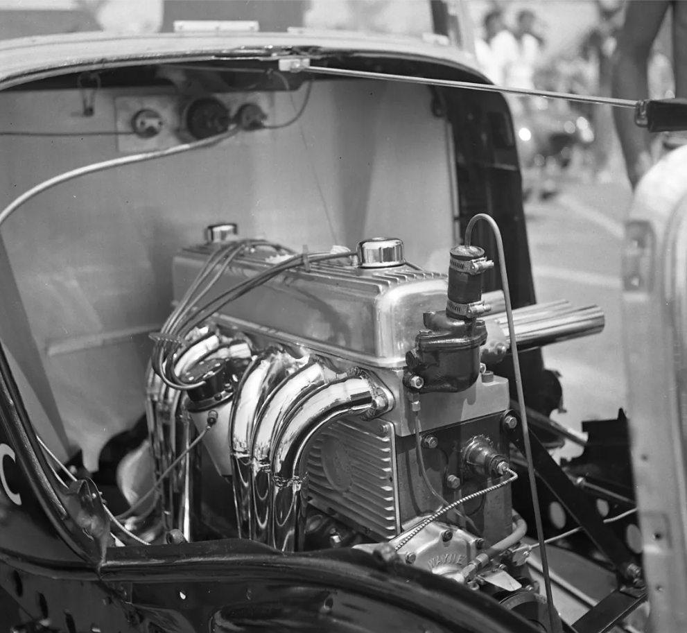

    Do you know what's going on with that water outlet on the head of the Lambrose roadster?

    A friend in Northern California has that part off Ike’s engine (see it on Ike’s coupe photo) and knew Ike. I believe he said it was a coolant bleeder as he ran alcohol and engine wasn’t a big problem. Ike didn’t use it in the dragster Pat Ganahl restored. The friend has Sonny Baleans GMC Wayne Head.
    The roadster has a Horning and possibly a different cam cover. Hard to read the name but possibly a Skinner.

    Methanol is a wonderful fuel for racing. In my injected 350, the radiator was from a 50s Chrysler product, a small honeycomb core, that we never had to use a fan. And most nights to get any temperature in the engine at all, 3/4 or more of the radiator was blocked off by a sheet of plastic. Racing at 150 to 160 f was the norm. Didn’t need much water flow, so a pair of -8 lines were enough for the water return.
    The old timers that ran flatheads early on, if allowed methanol, could keep them cooler. Just run a little bit rich.
  15. jimmy six
    Joined: Mar 21, 2006
    Posts: 17,403
    jimmy six
    Remember they were drag race cars…notice no water pumps..

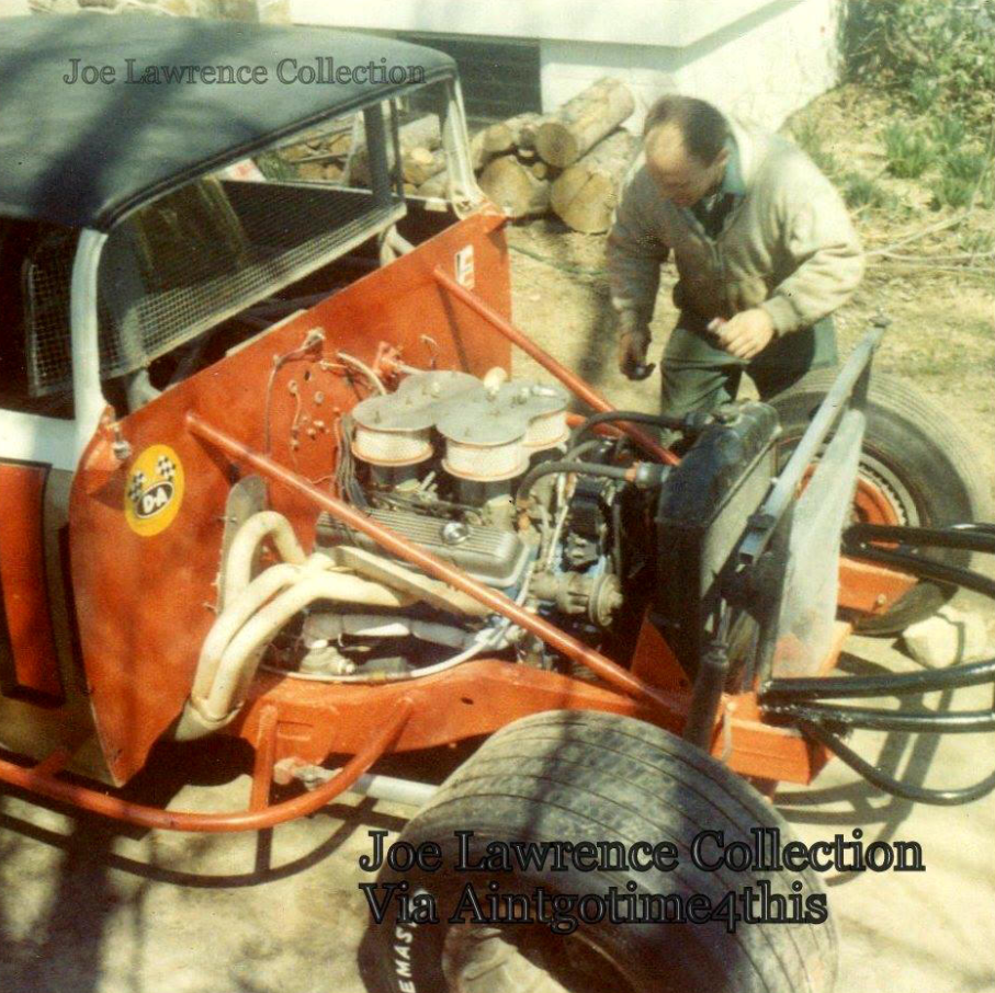

  17. I know where there is one for a Chevy it's a McGurk. I am keeping track of it!
    It was in this car Ray Kennedy's 261 powered Pontiac coupe, 1966 NYS (dirt mile) Fair winner Larry Nye driver.
    The New York State Fair race was flathead/inline only until the late 1960s (1968 I believe).
    Many of the tracks northern/central parts of New York state stayed flathead/inline into the late 1960s, as did one of the Connecticut tracks (Danbury?)

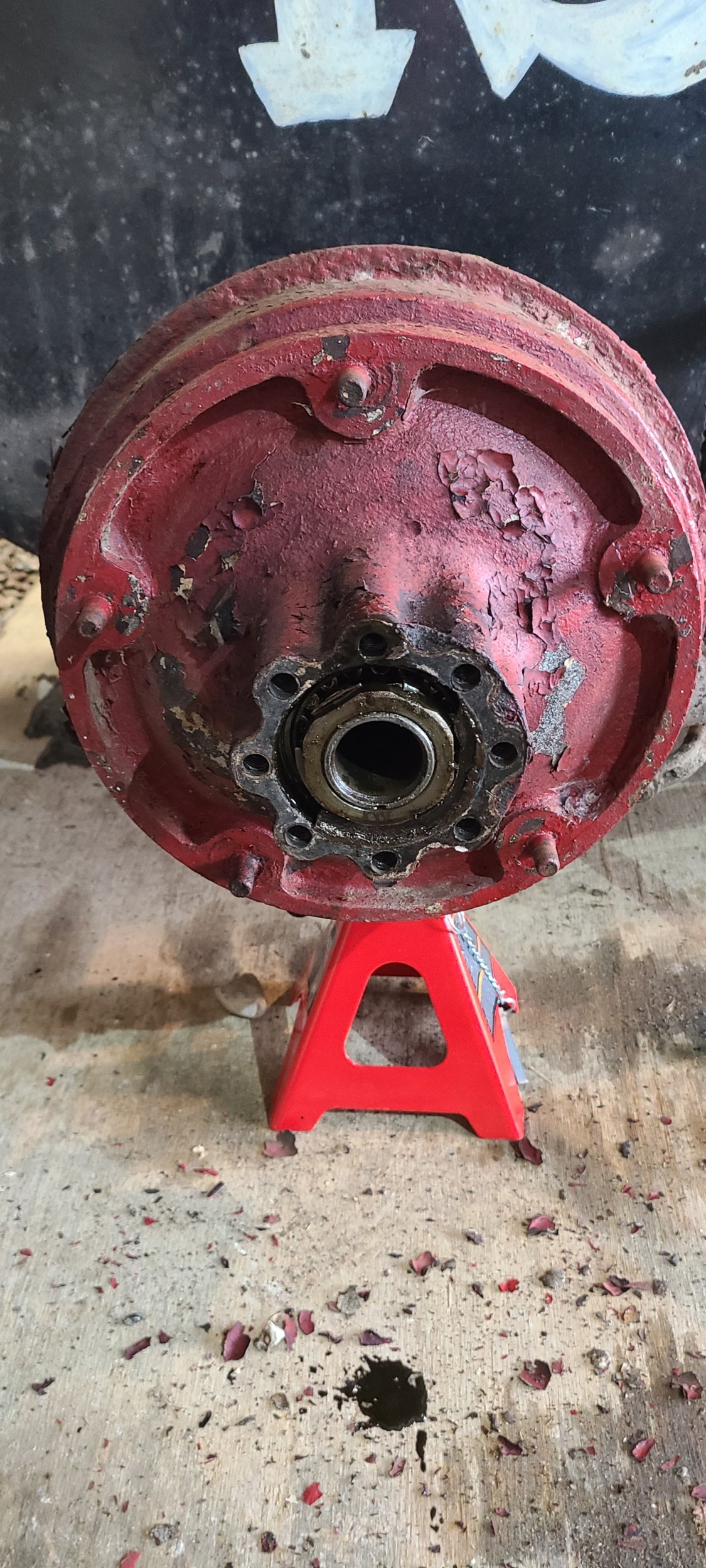

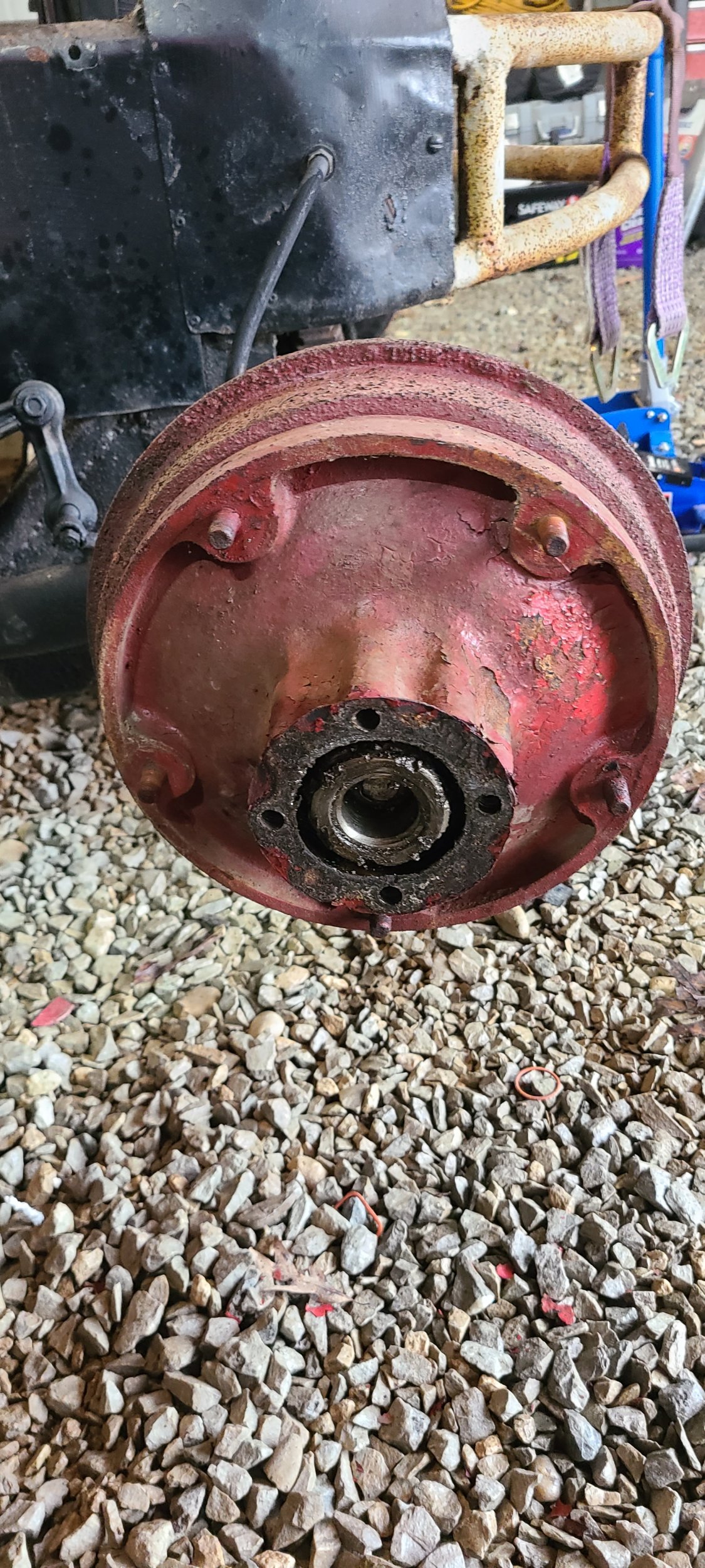

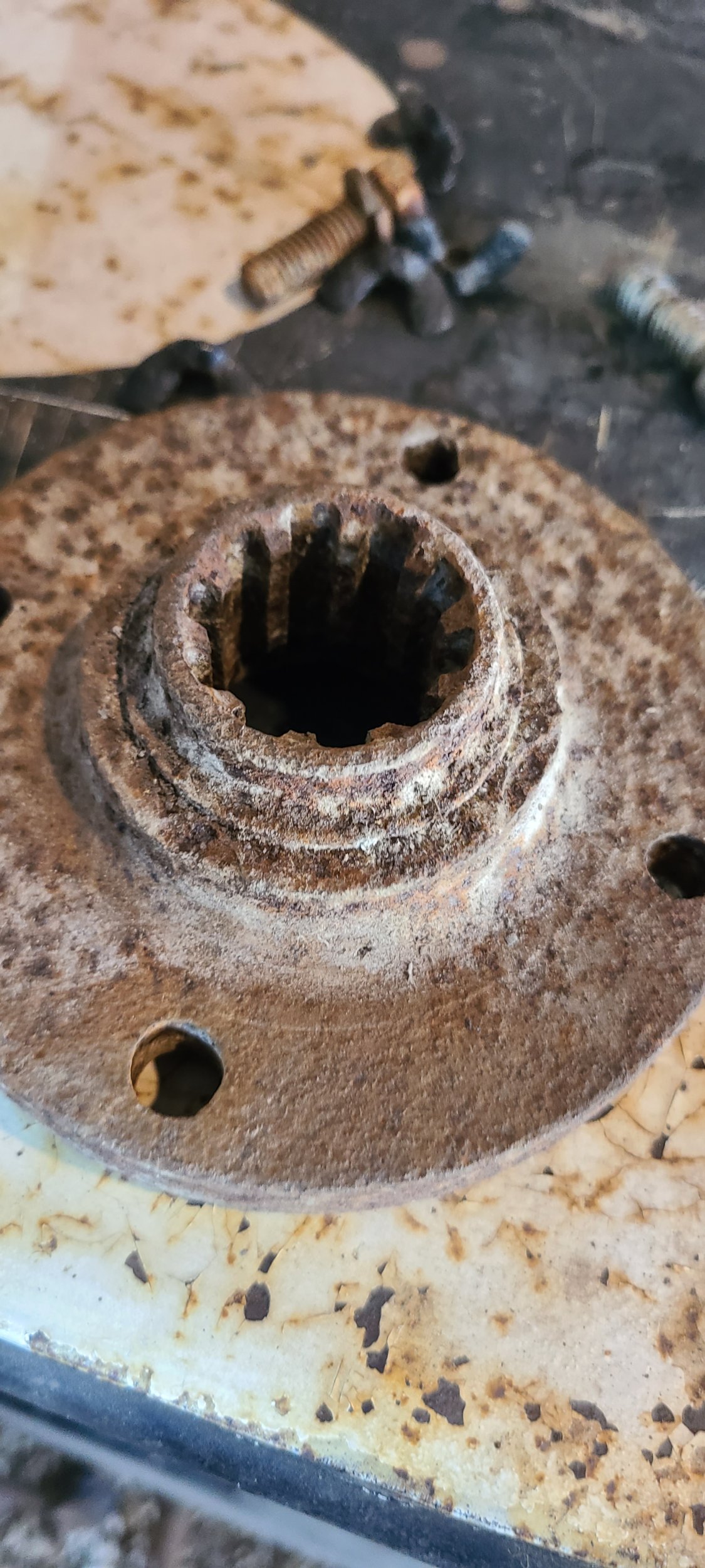

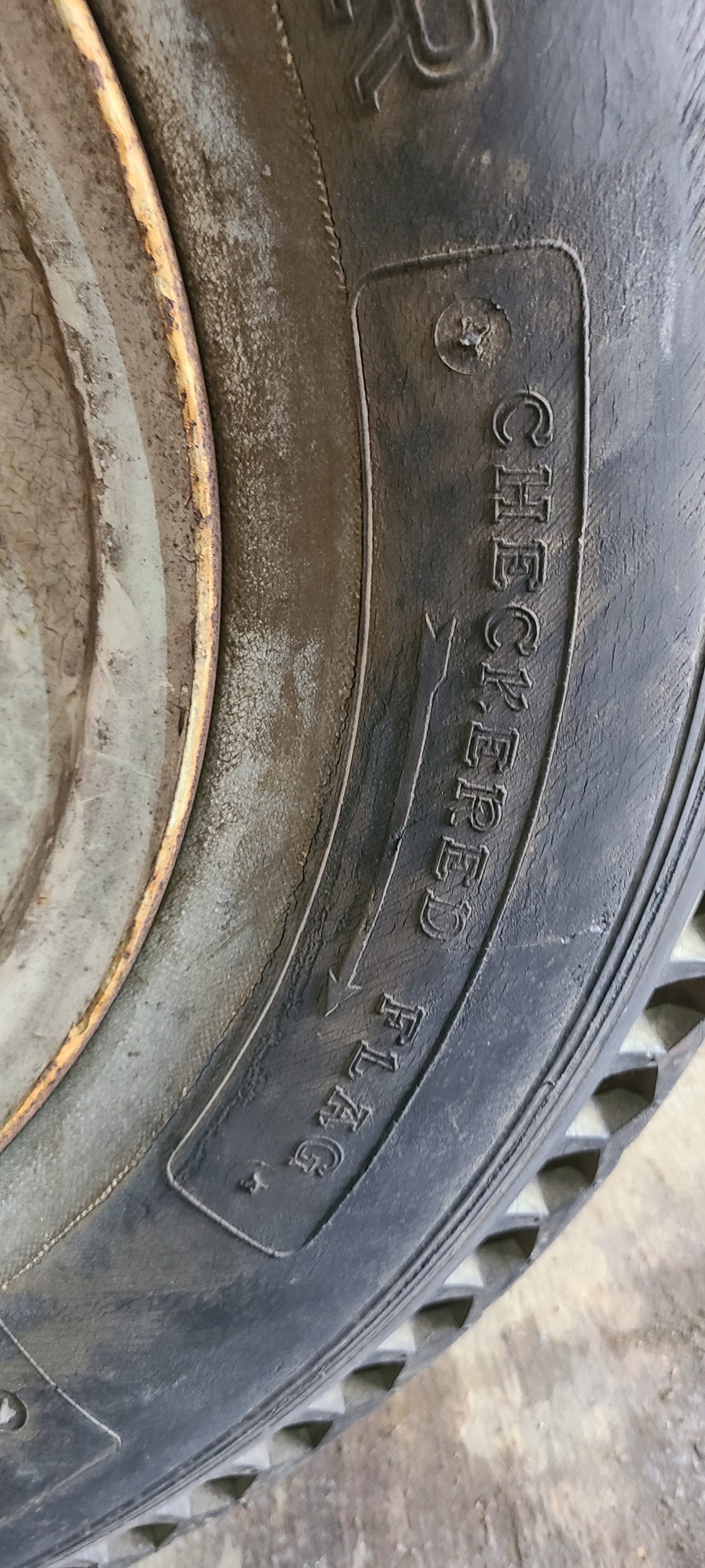

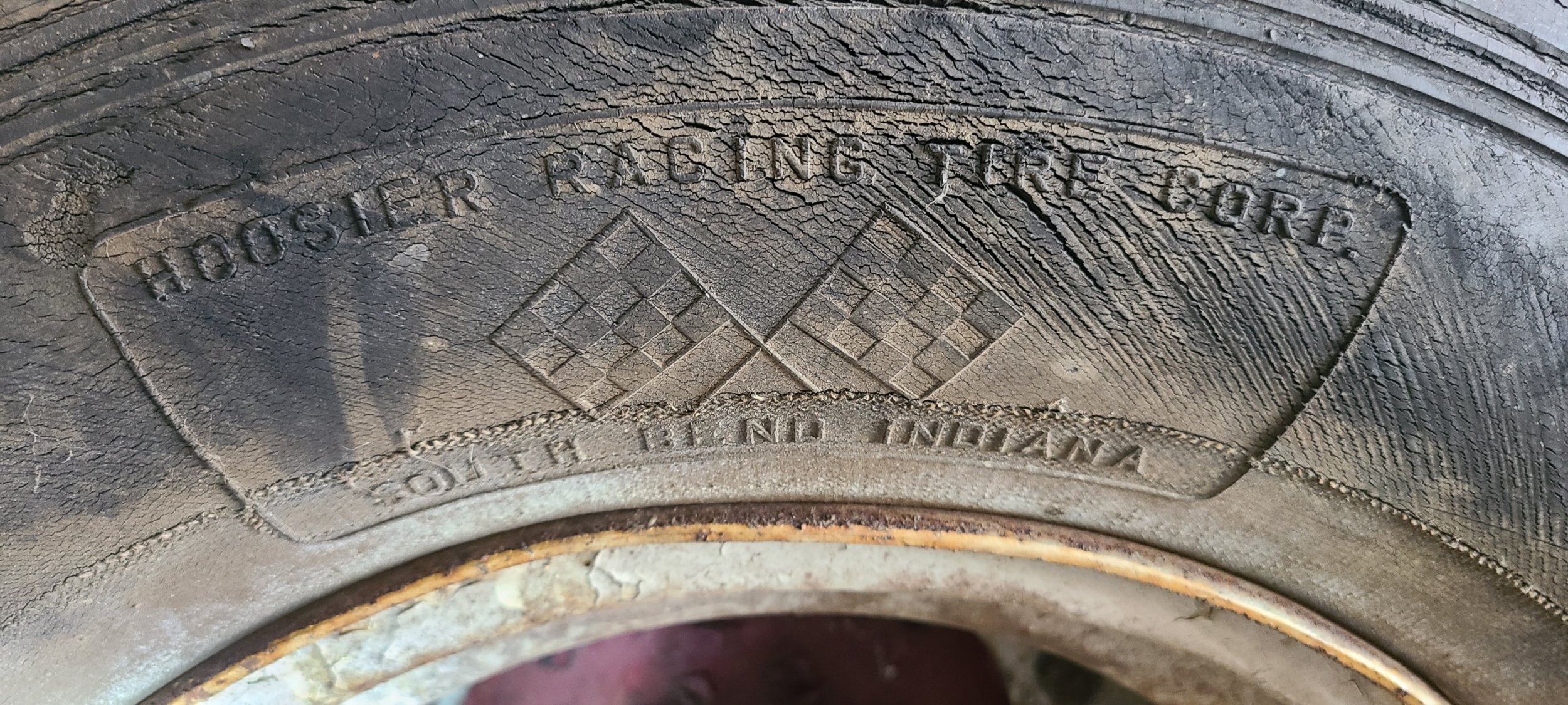

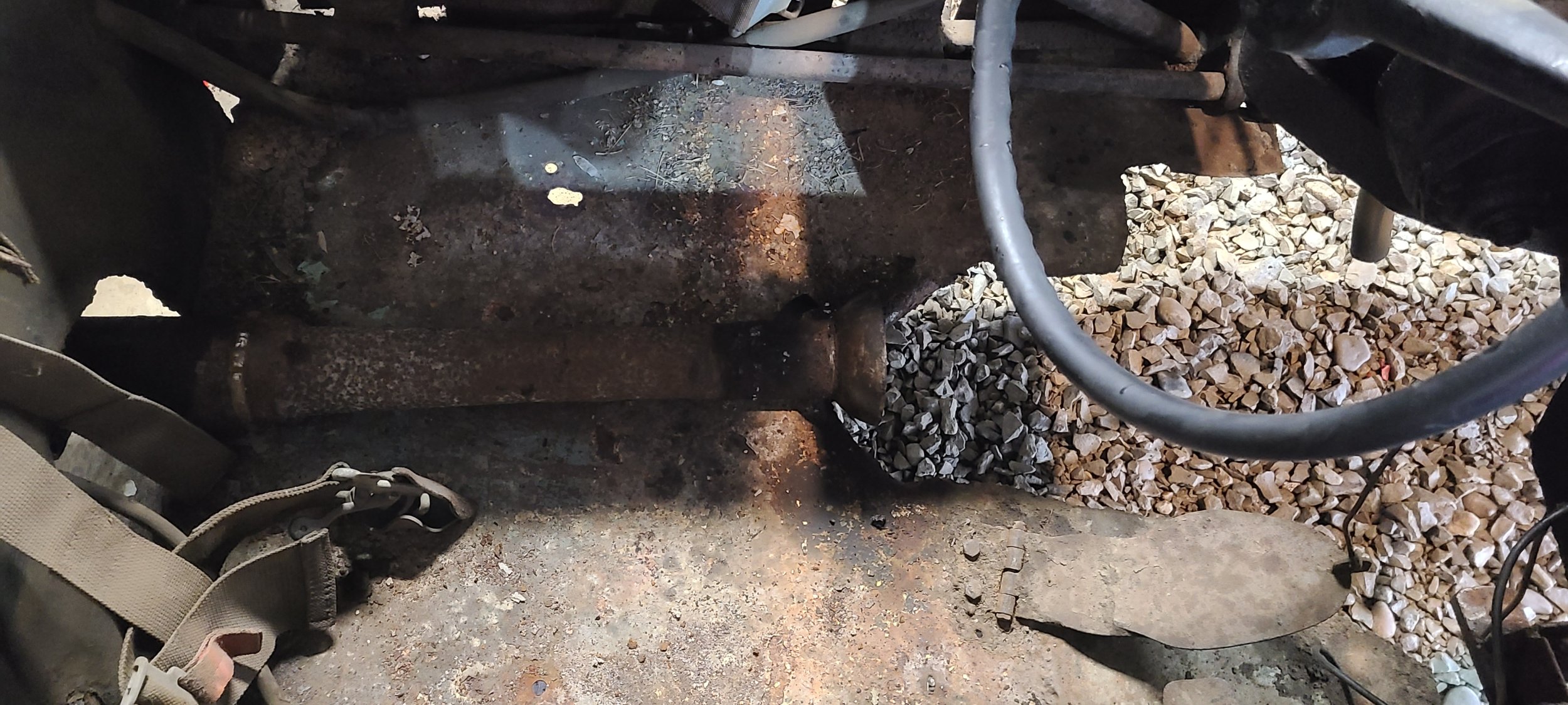

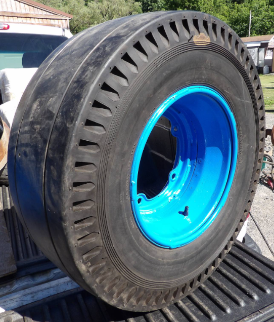

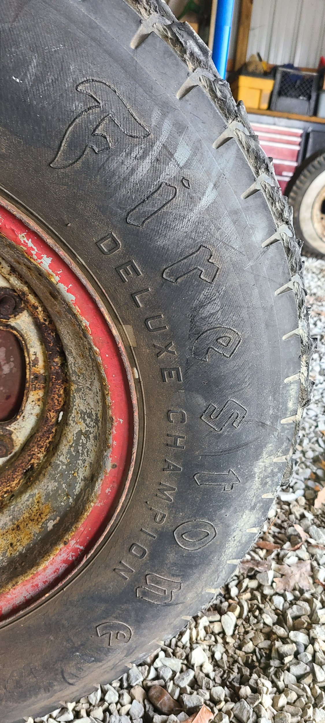

    Well, I got to spend some more time digging through the car this weekend and found some cool stuff. It has truck axles in it and a third 3/4 ton spindle mounted on the right front along with an oversized 16" rear Firestone Deluxe Champion tire in that position. That definitely juves with what I've read and seen on here of other same era super modified cars.

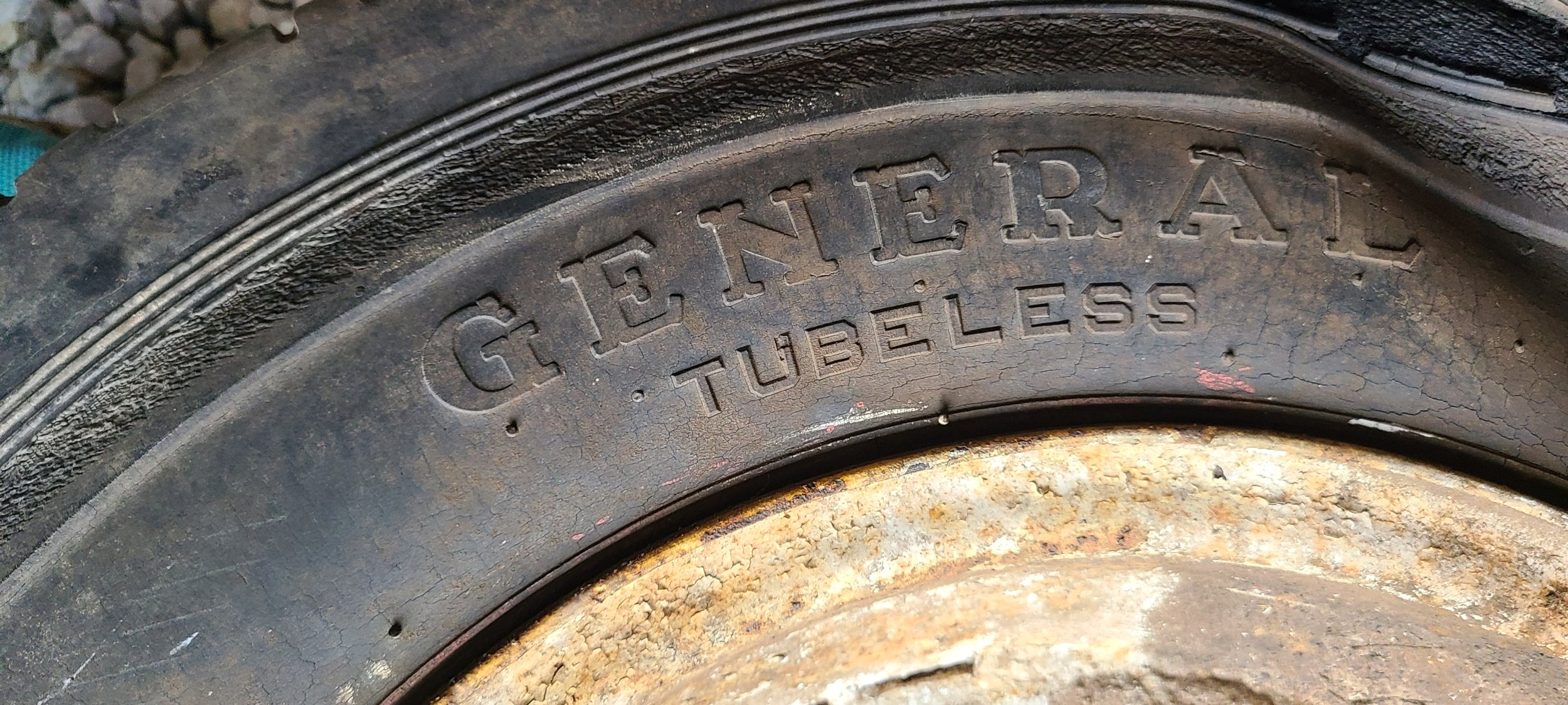

    The right rear tire has to be one of the oldest Hoosiers around, the logo is spelled HOOS1ER and has some checkered flags on it. The left rear tire is a General white wall pie crust with grooves cut in it. Unfortunately it's a goner and has started to separate and has been sitting on a flat spot so long, it will never be round again. The left front is some sort of Firestone street tire and is much smaller than the right front tire.
    You can see where the fronts were definitely made from artillery wheel centers, while the left rear has more of a home made bolt circle and welded reinforcements. The right rear is also cobbled together from a stock bolt center but no wedge shaped reinforcements.
    The pics don't show, but I got all the drums and wheel bearings off and the 2 rear axles removed. Bad pic of the quick change cover, but it is a plain cast item. I didn't see any markings.

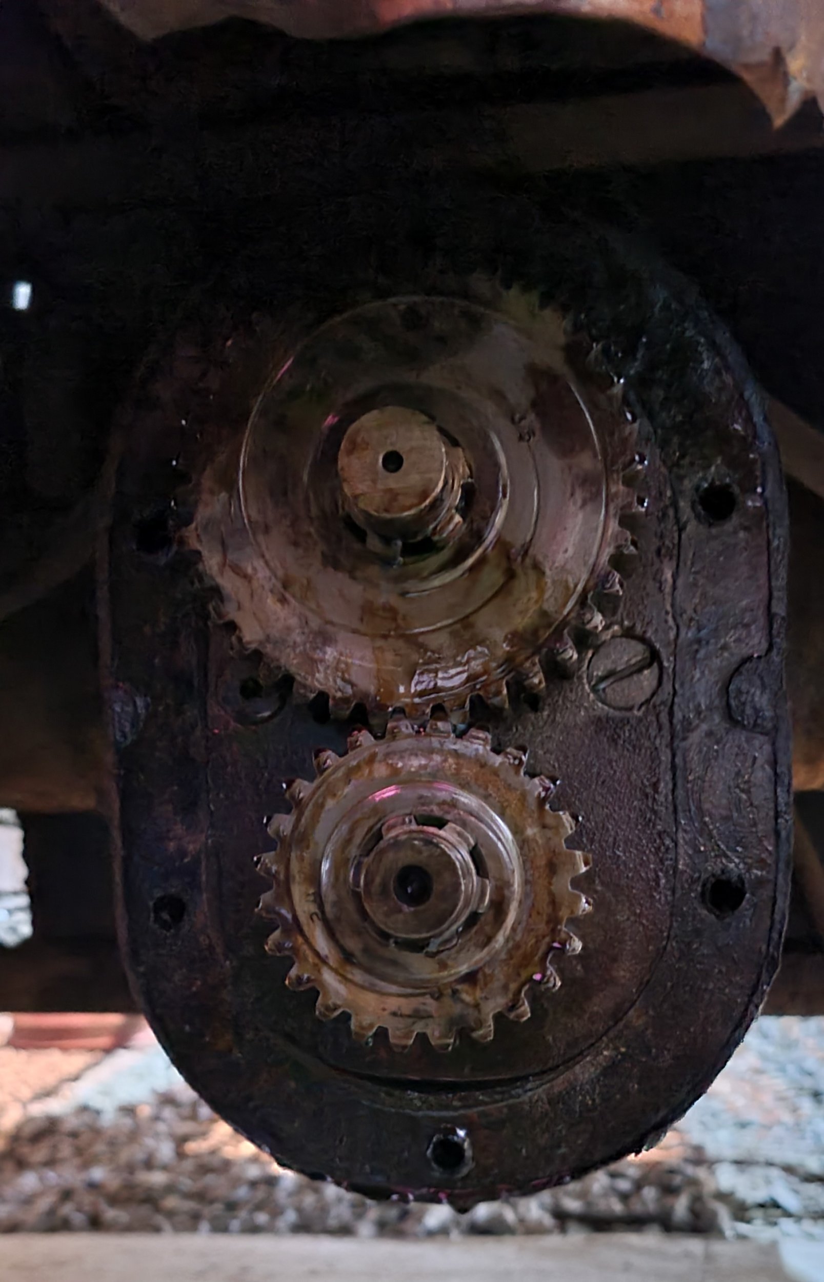

    I also got the transmission out and took the top off and verified it has only one gear set in it and has the shifter safety wired to one side to only use one "gate" as it were. Included is a photo of the flange with splines to mate the input shaft to the crankshaft.
    There's also plenty of evidence in the engine bay and other places on the frame that this was not the car's first configuration. A flat mount with 2 holes is still evident on the left side about half way up a diagonal tube that has since been hacked off just above the mount and below the top rail tube. The opposite side of the car shows no evidence of such a mount, but the same tube is there, albeit in the form of a rotini noodle about midsection.
    I also figured out that there's a set of shoulder and lap belts mounted in the car, plus an extra set of lap belts that were laying on the seat dated 1962. These are in much better shape and pliable compared to the stiff original belts mounted in the car. I'm guessing someone had intentions to replace them sometime since 1962...haha.
    I also figured out there is an oil tank of sorts in the rear next to the gas tank. When looking up from underneath, you can see the gas tank is made from some sort of drum with the logos or stenciling still on it. The oil tank is OD green and somewhat ammo can shaped, maybe just some sort of surplus fluid container. What I'm not sure about is there seems to be a large diameter hose that runs to the engine bay and is hanging loose as well as a smaller diameter one, both seeming ro run from the oil tank. The gas tank has its own lines. Surely there wasn't some sort of dry sump engine in there? I was thinking it was just a vent and catch can, but I'm not sure.
    Can anyone point me in the direction of some good wheel cylinder replacements, maybe tell me what to look for. Am I correct that they are gonna be 37-41 Ford, maybe for truck only, or are they all the same? Also, any idea what the master cylinder is from and what to do about it, ie: replace or try to rebuild? Thanks for all the info, especially Robert!

  21. Roy Wainscott
    Joined: Mar 20, 2025
    Posts: 51
    Roy Wainscott
    Tire pics and flange, sorry got missed!

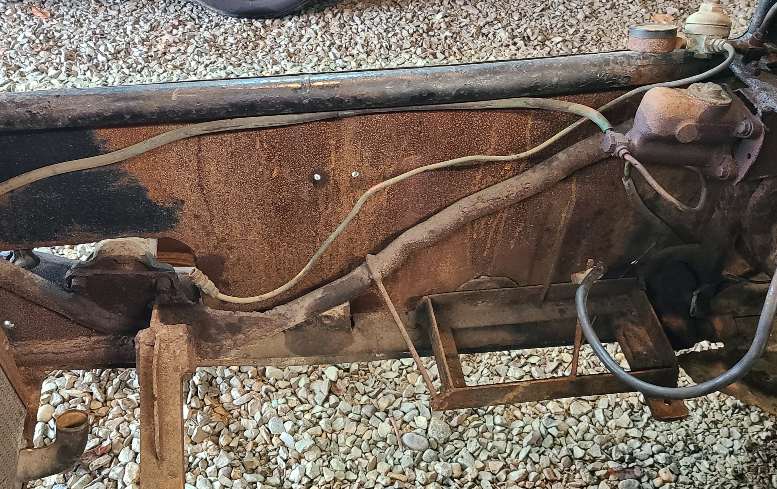

    Also, maybe there's not a very good pic of the master cylinder, so here's one. 20250406_152540.jpg

  23. Oh Lord, I thought mine was bad. It definitely has the local track cool factor. Years ago my Brother and I had a pile of and one complete Model A powered sprint cars. One transmission was set up using a 1928 basket clutch and the other one was a "dog clutch" . That clutch was fun. Your monster needs a GMC engine. Big torque coming out of the turns.
  24. I believe all 39-48 Ford car light truck the wheel cylinders are the same, there is a company in South Carolina that specializes in early Ford brakes.
    I can get there in info when I get home, they are who I bought my shoes and hardware from. I was lucky I found N.O.S Ford wheel cylinders.
    The. master cylinder appears to be a 52 and up 1960(?) car until, I think I have a brand new Wagner (N.O.S) unit, again I will check when I get home.

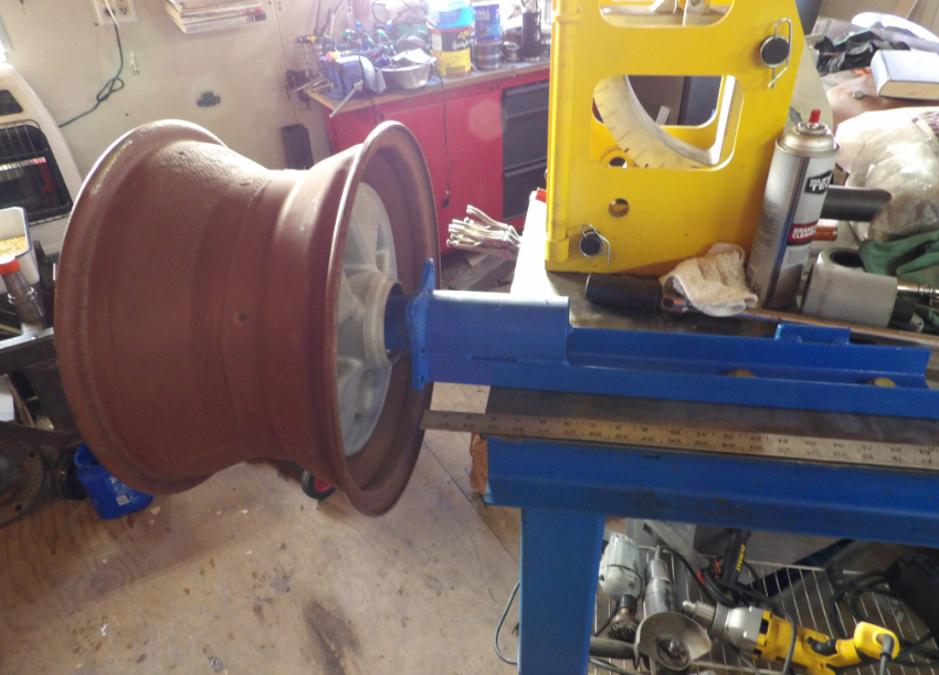

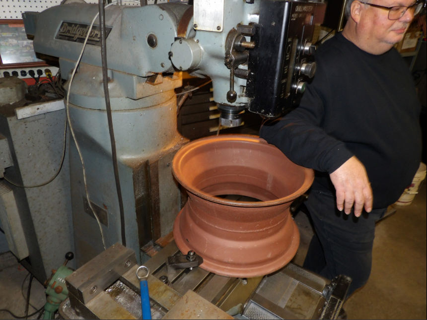

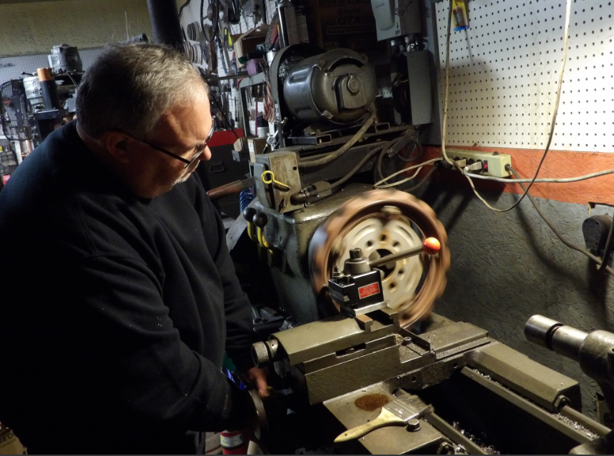

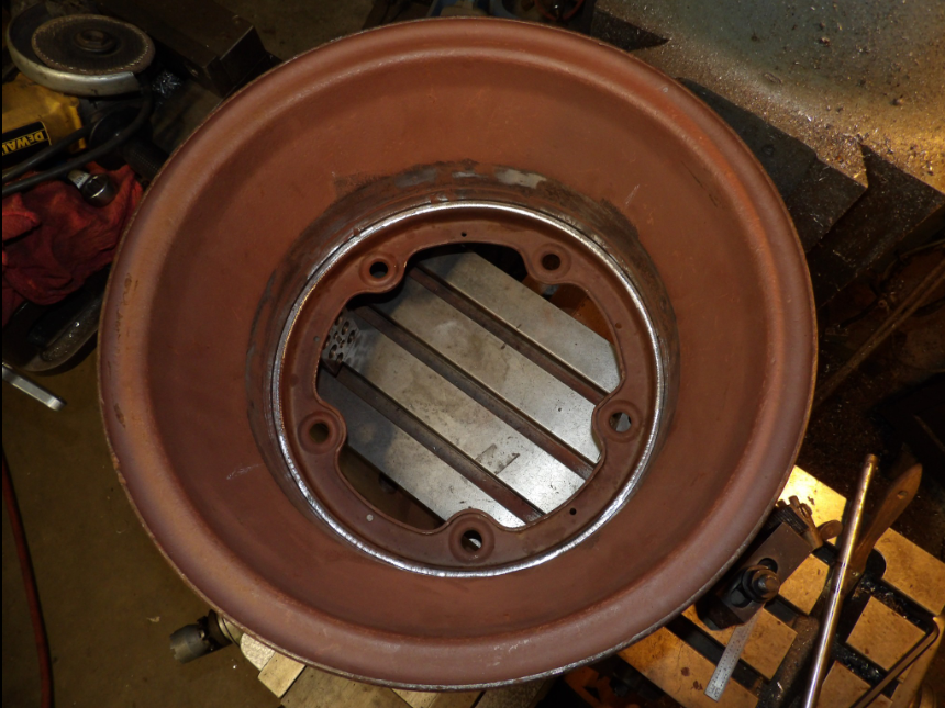

  25. I built a pair of those wheels last year for display, (I need one more center to do the third wheel.) and mounted a set of modern Hurst recap on them.
    Widened Buick rims stock Ford wide 5 centers machine work by family friend Jeff Hager.

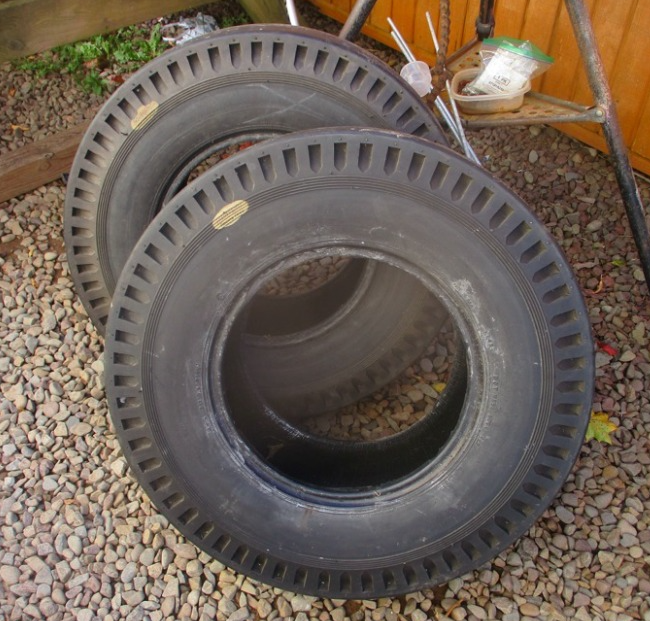

    I couldn't find anything current online about Hurst tires, only Towel City. Any more info on them?

  28. Hurst are out of business, I got a screaming deal on these.
