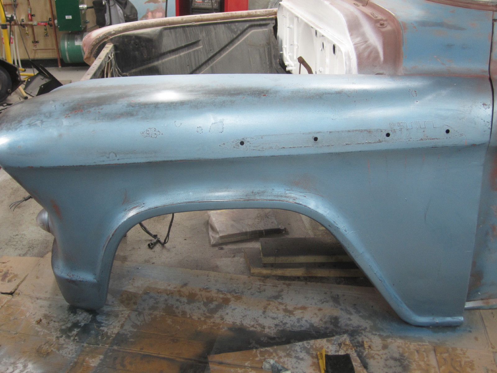

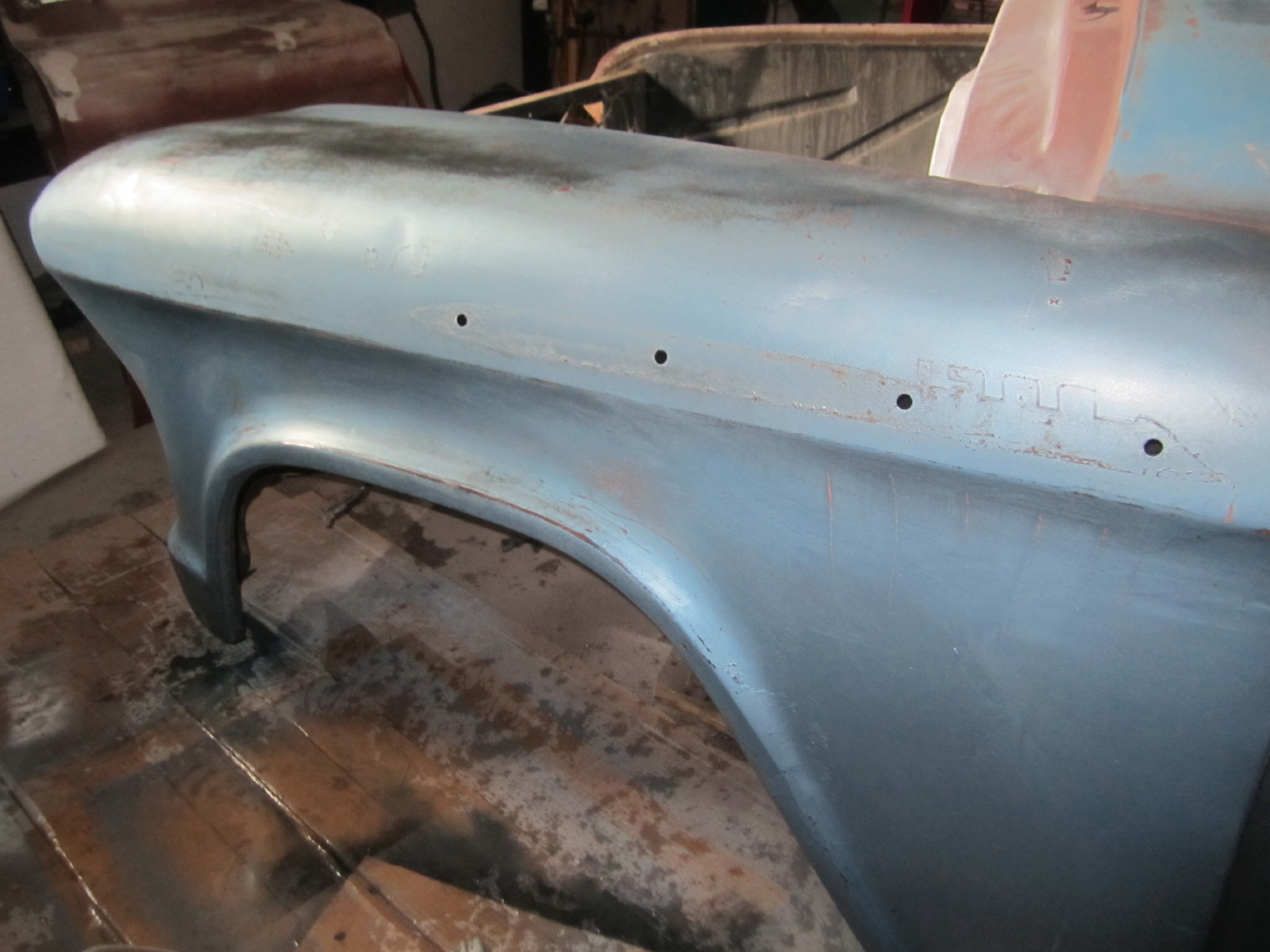

    I'm gong to be doing a weathered paint job on this truck so I figured since I was up at 5 am this morning, I might as well do a test panel. Using a rattle can blue that's close to the paint colour I'm using, I went to it. This is what the end result was

    Great build thread. That photo of it sitting on the later model frame ought to pop up every time someone asks "Can I put my Task Force truck on a later frame". I'm liking your choice of color for it too.

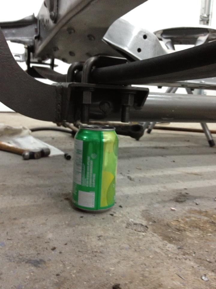

    Speaking of which, I have the front end mocked up so I could see how low this thing is going to sit with the mono leaf and dropped axle. Once the power train is dropped in, I'm expecting it to drop close to and inch. Right now, I have 5" from the floor to the bottom of the U bolts

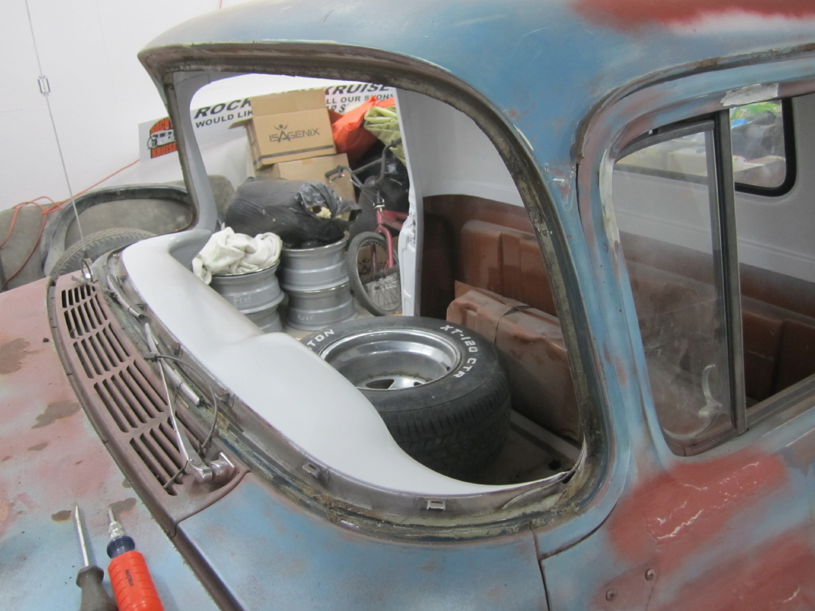

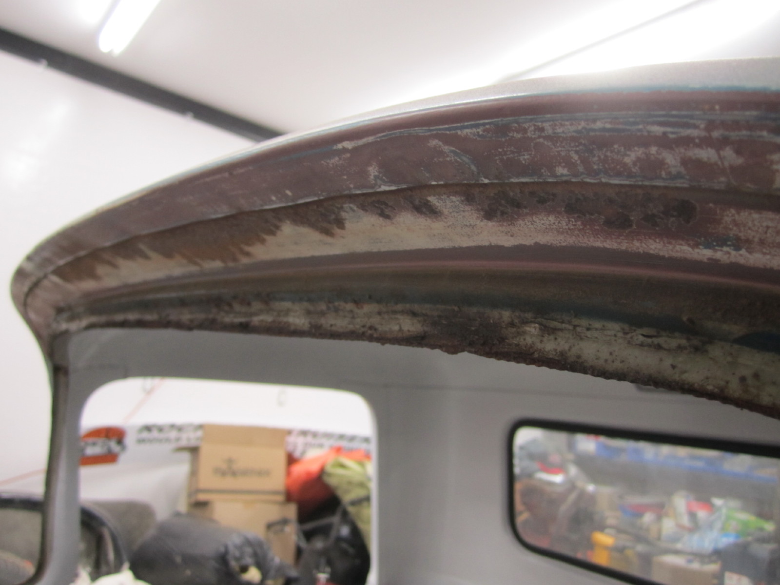

    I got a bit more done this morning. I removed the bed wood by grinding the tops off the carriage bolts. That old dry wood sure lights up in a hurry. I also removed the windshield so I could get a better look at what's underneath and found there to be only surface rust, NICE!!!
    Then I measured up and marked the location for the C notch I'll be doing later on this week. I decided to go ahead and paint one of the 3 clusters I have in the shop to see if I preferred the blue over the black face.

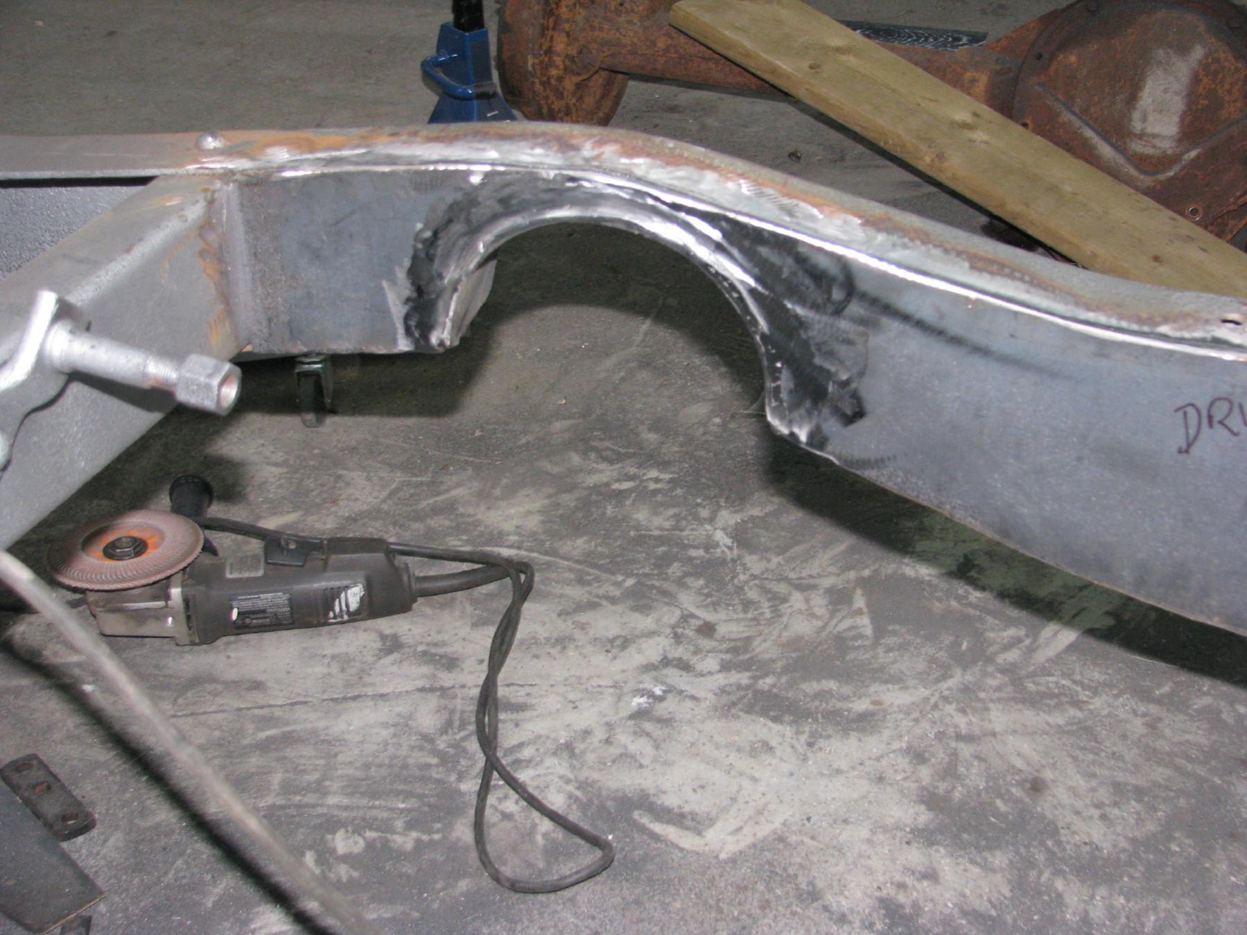

    A bit of progress to add to the pile. I boxed and C notched the rear of the frame tonight and got the spindles installed up front.

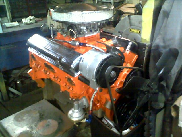

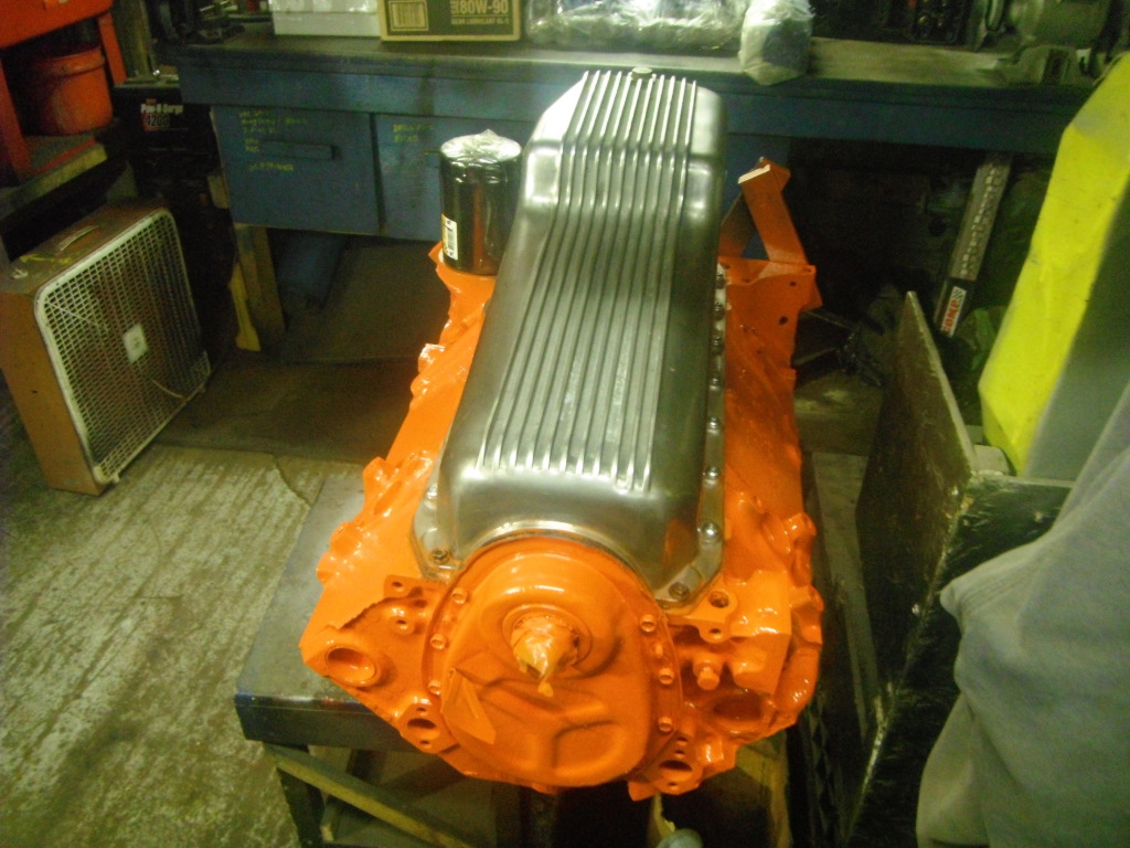

    Engine rebuild is done. Small block 350, 268 Comp Cam, roller rockers, port matched head and intake,Holley aluminum intake, 650 Edelbrock, and a GM HEI distributor. This will be mated up to a TH350 with a B&M shift kit in it and the rear end is a 3.08 from a 65 Chevelle

    I am not going to shoot your build thread down,you've done nice job.
    But that notchjob caught my eye,it looks like a bit weak to me.I think it needs a bit more stuff above the notched area..
  17. dubie
    Joined: Aug 17, 2004
    Posts: 698
    dubie
    I've already started on the upper part of the notch. I'm building a 12" long 3" tall tapered arch to regain some strength.

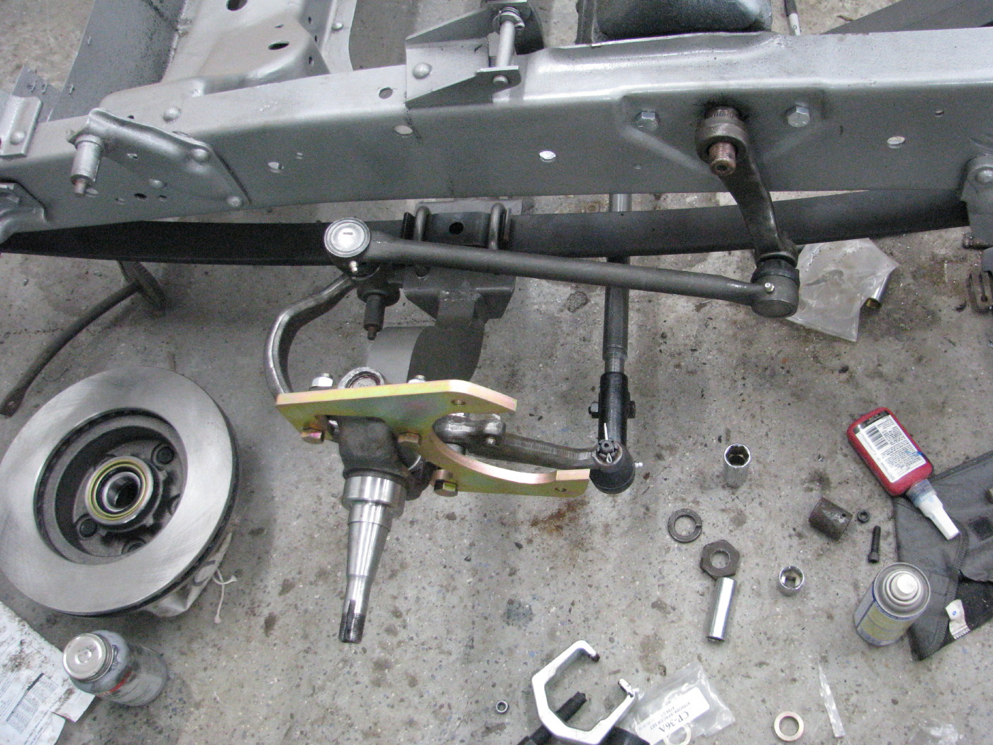

    A little bit of progress from tonight. Installed the steering box, pitman arm, drag link, steering arms and tie rod. We also put the caliper brackets on and checked all the clearances. I'm going to wait until after I heat up and bend the steering arm to install the brake rotors. IN the mean time I'll get the rear mono leafs and shackles installed and weld the mew saddle mounts on the Chevelle rear end.

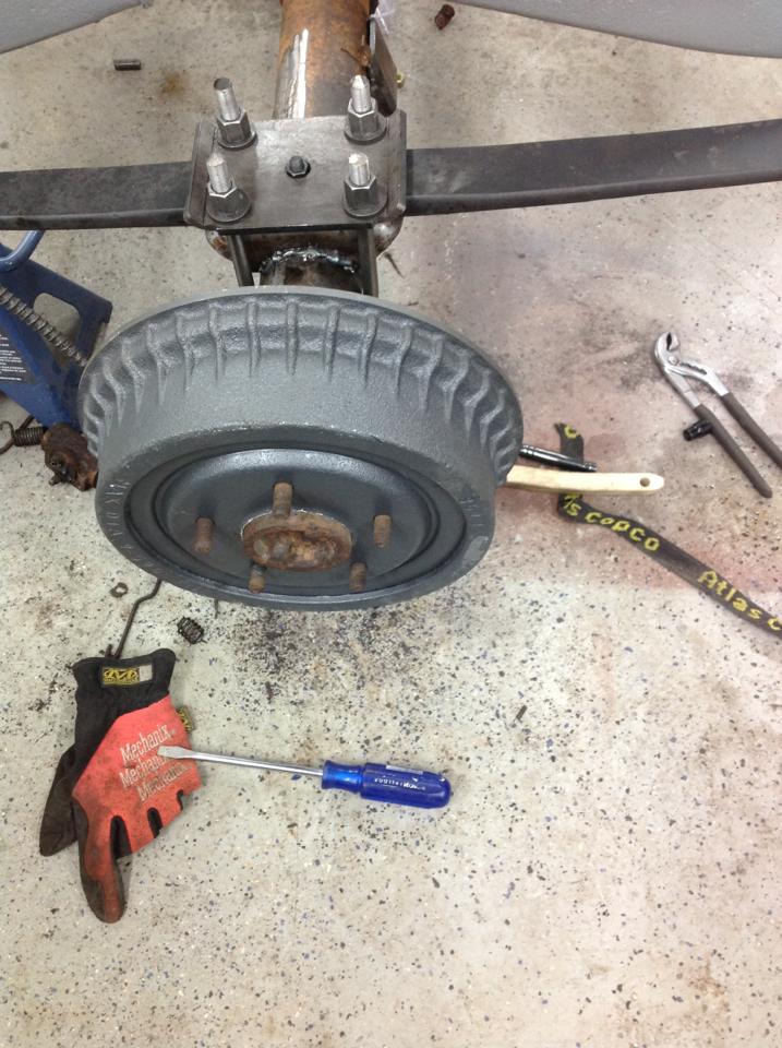

    A small bit of progress to report. We had some time yesterday so we got the rear mono leafs installed and welded the saddles onto the 65 Chevelle axle. Now I have to rebuild the brakes, paint the housing and get it installed.

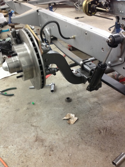

    I've been busy getting some paint jobs finished over the past month so I can free up some time and money on this build. This weekend we got a chance to get the front end ***embled and torqued down. I installed the 6 degree caster shims, Bilstein nitro slammer shocks and the CPP 5 x 4.75 disc brake conversion kit. Once it was done I hung one of the Corvette ralleys from it to make sure the caliper had enough clearance, which it did.
    This week I'll be doing the rear axle seals, and rebuilding the wheel ends so I can prep the housing for new paint. My goal is to have this back as a rolling ch***is in 2 weeks time. Then I have to install the brake lines, install the engine and ****** and then start piecing the body back together
    Here's a quick shot of this weekends work

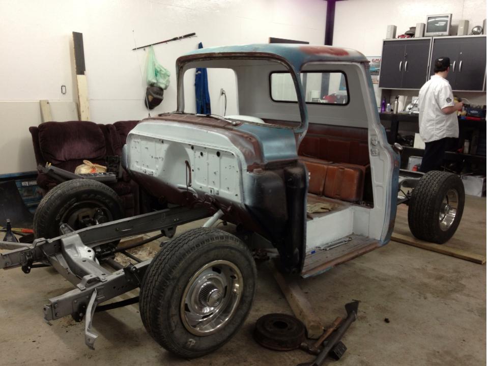

    I took a week off work to get some things done around the house and work on the truck. We hung the rear end, rebuilt the wheel ends, welded on the new rear shock mounts, mounted he rims and tires, installed the cab and are now mocking everything up for the engine and ****** mounts.
    There is some issues with fitting the HEI distributor and the triple pulley up front so I'm going to notch and then box in a section of the front cross member for some added clearance

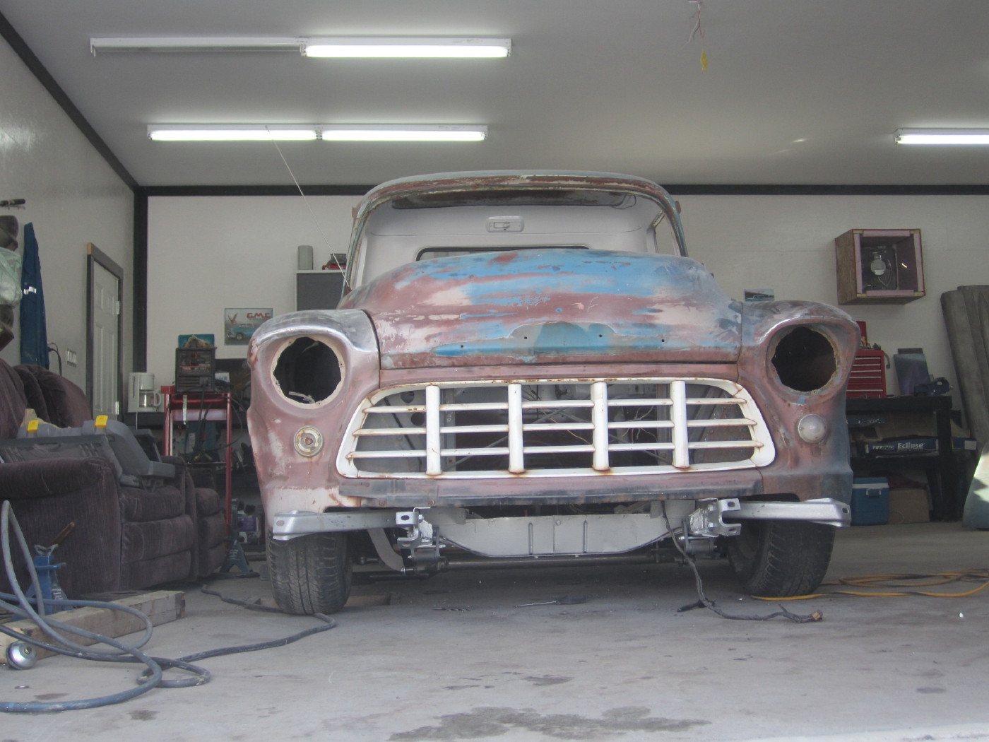

    I tossed the front clip and a door on it to test fit everything today. Then turned back to modifying my front cross member to accommodate the pulleys on the small block. We also got the engine and transmission mount location marked and drilled. Tomorrow I have to finish the work on the front crossmember and extend my rear shock mounts.

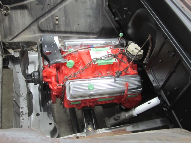

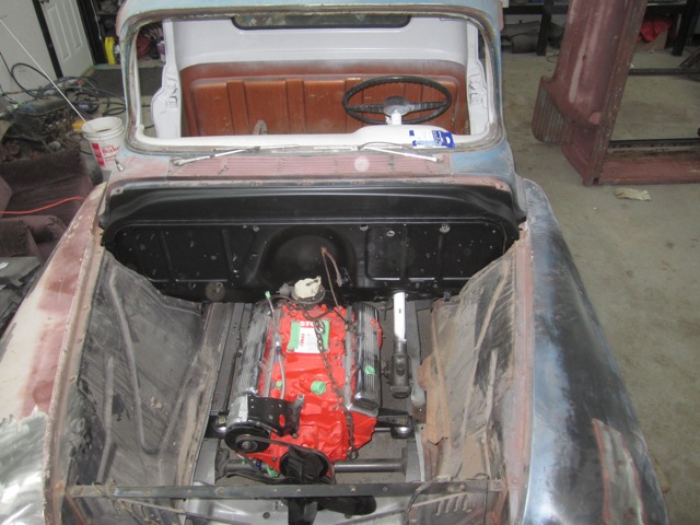

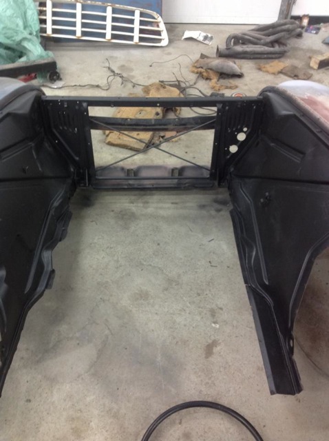

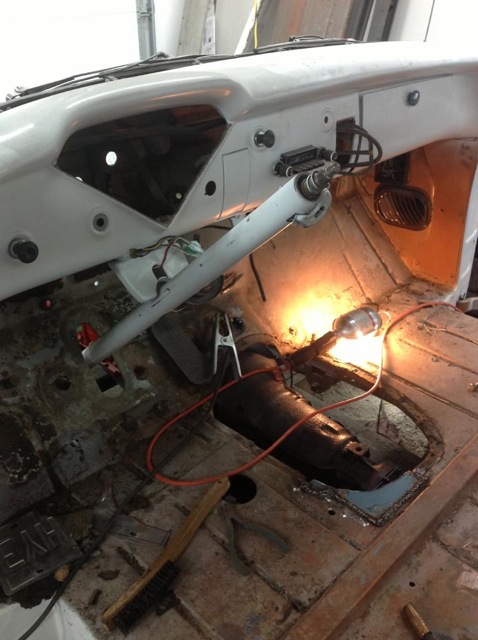

    I haven't put any pictures up for a while so here's where we're at right now. The engine and transmission are now mounted in the frame, the wiring has been gutted from the cab to be replaced with a new Rebel wiring kit. I cleaned up and painted the inner fenders and then welded in a couple patches in the cab floor that the previous owner hacked up.
