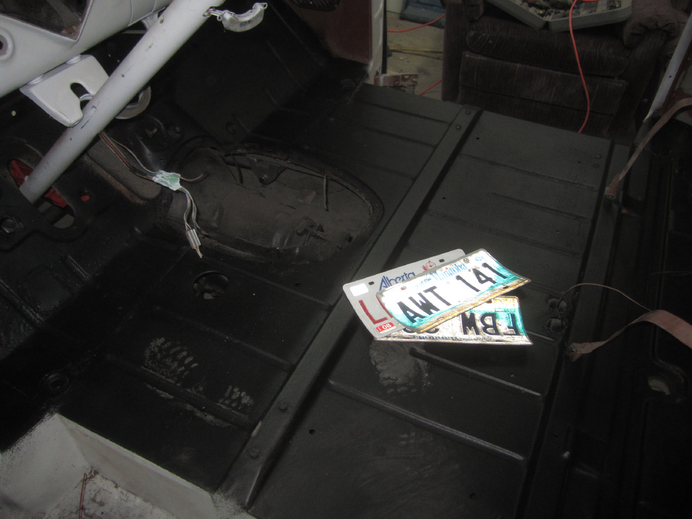

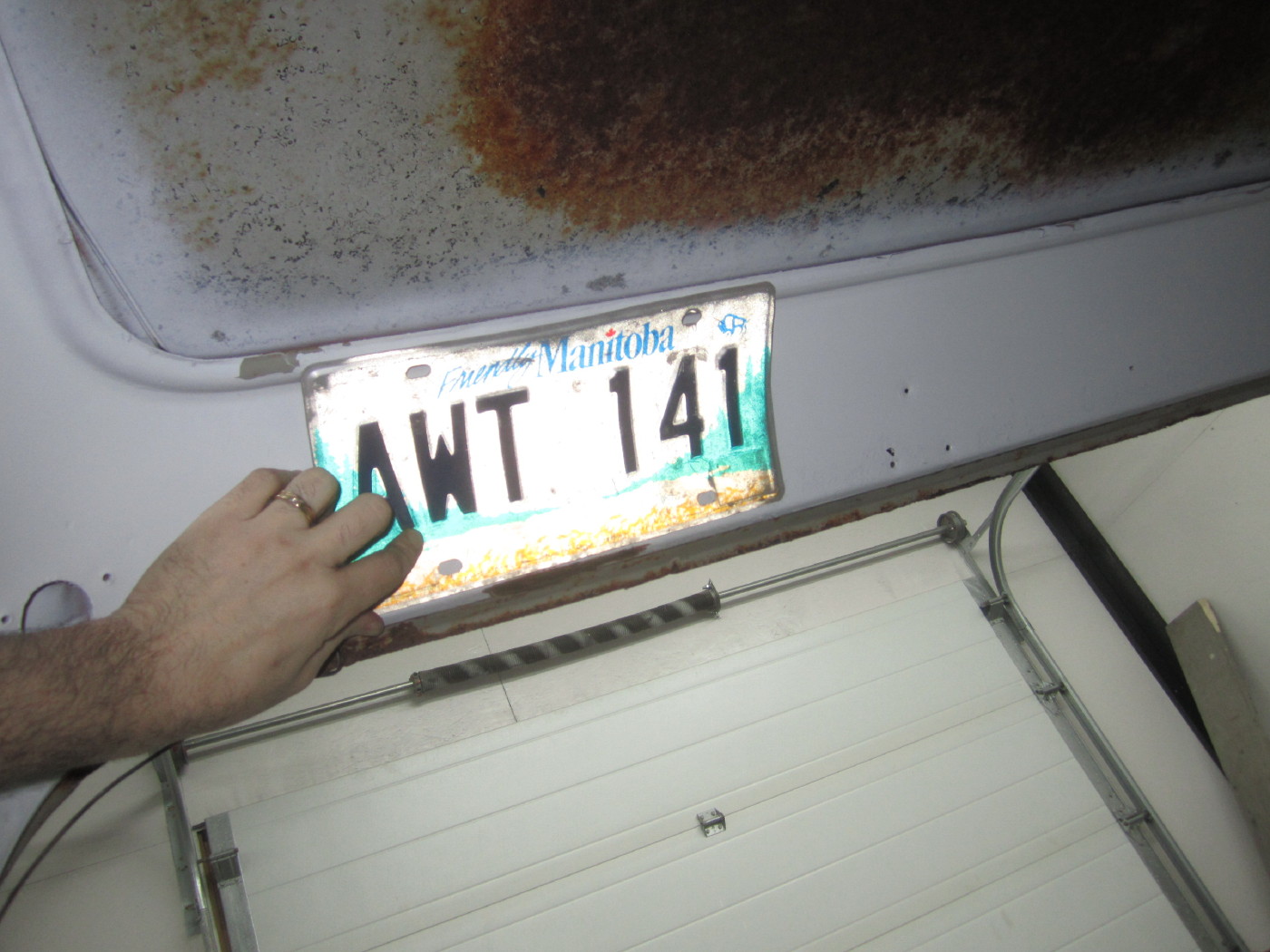

    rust repair, under coating and a little painting got done this weekend. By the end of this week I plan on being done all the sheet metal welding and the body can start being hung on the frame. I dug out a few license plates I had saved from cars and trucks I have previously owned and decided to rivet them onto the ceiling of the cab, right above the wind shield, just for that extra personal touch

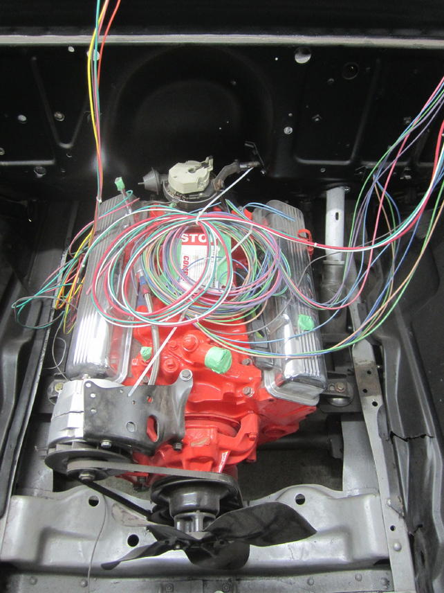

    My Rebel wiring harness just showed up last night. It looks to be a really well built kit with very detailed instruction for us wiring newbs. Thanks to Tugmaster (Todd) for the great service, I recommend him to everyone.

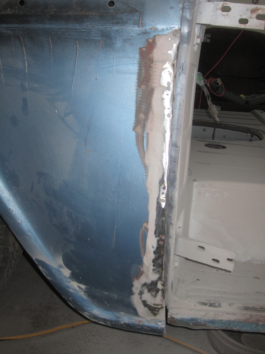

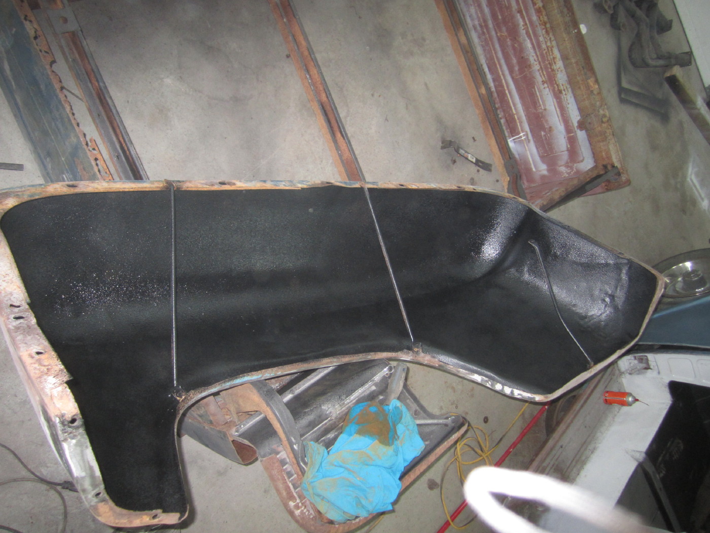

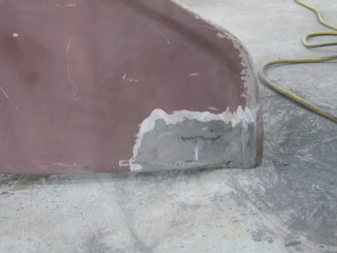

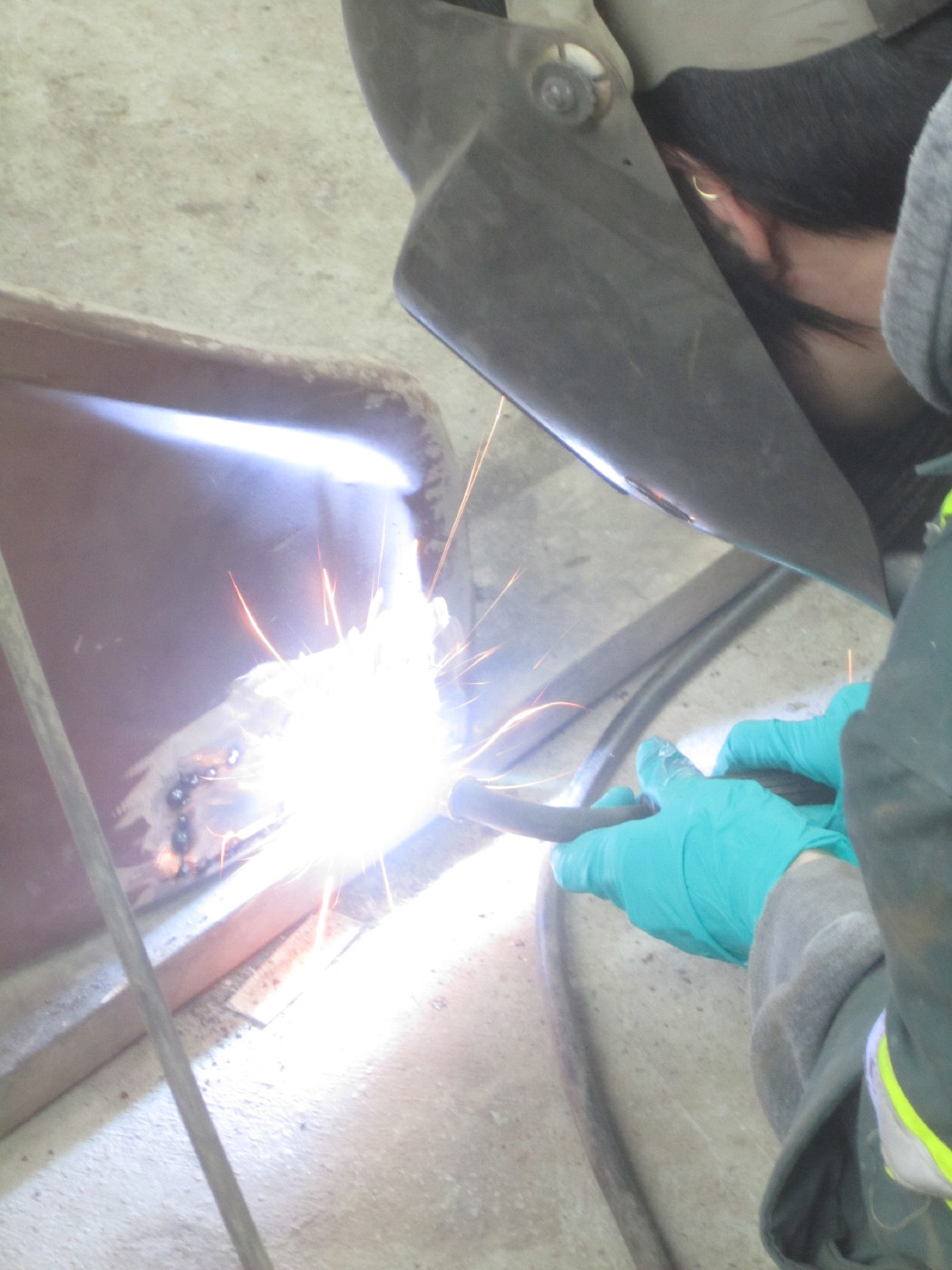

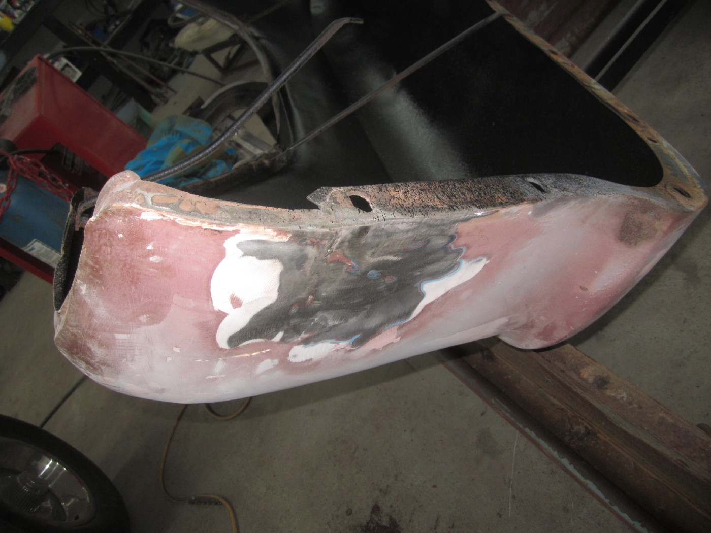

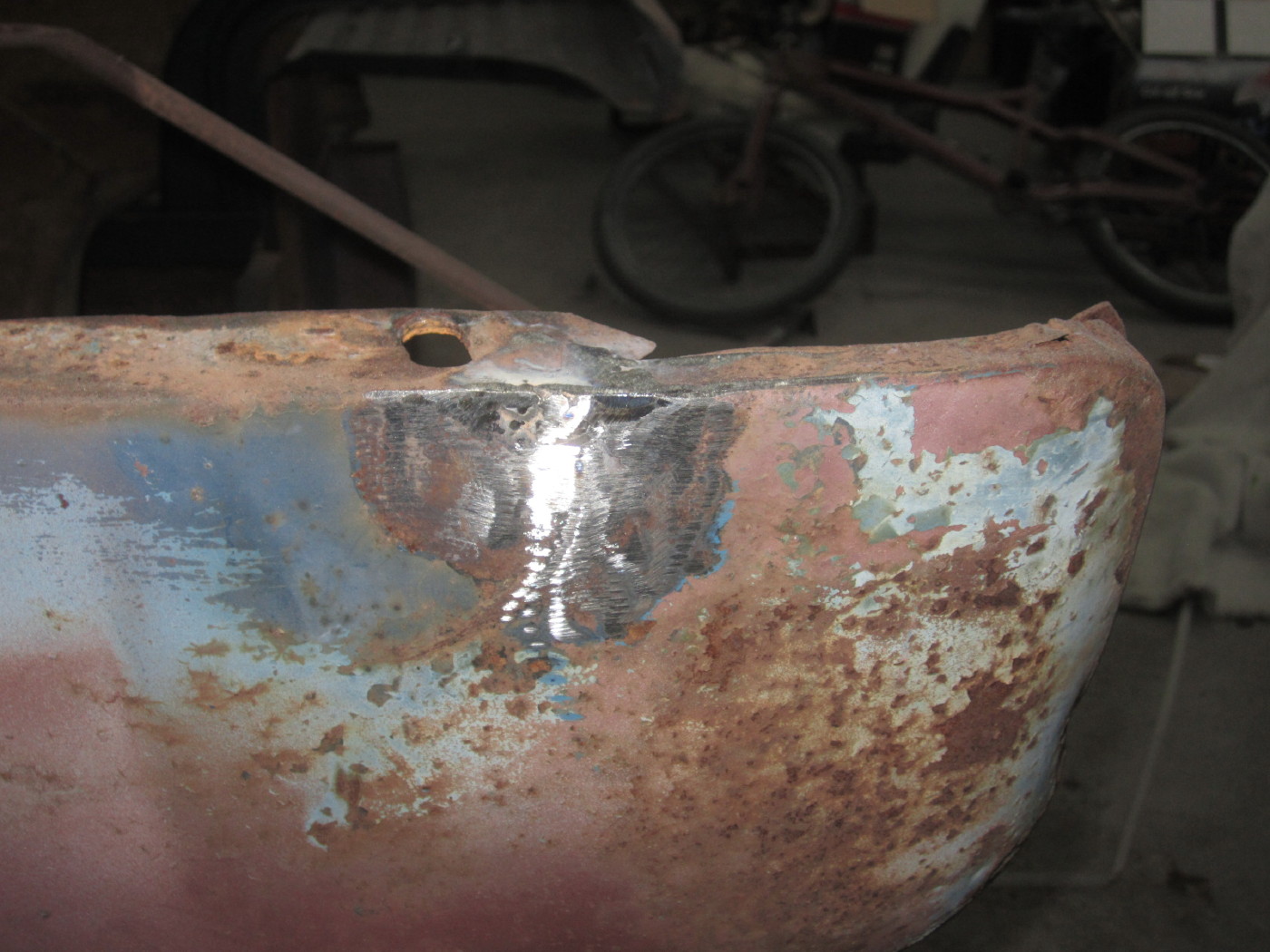

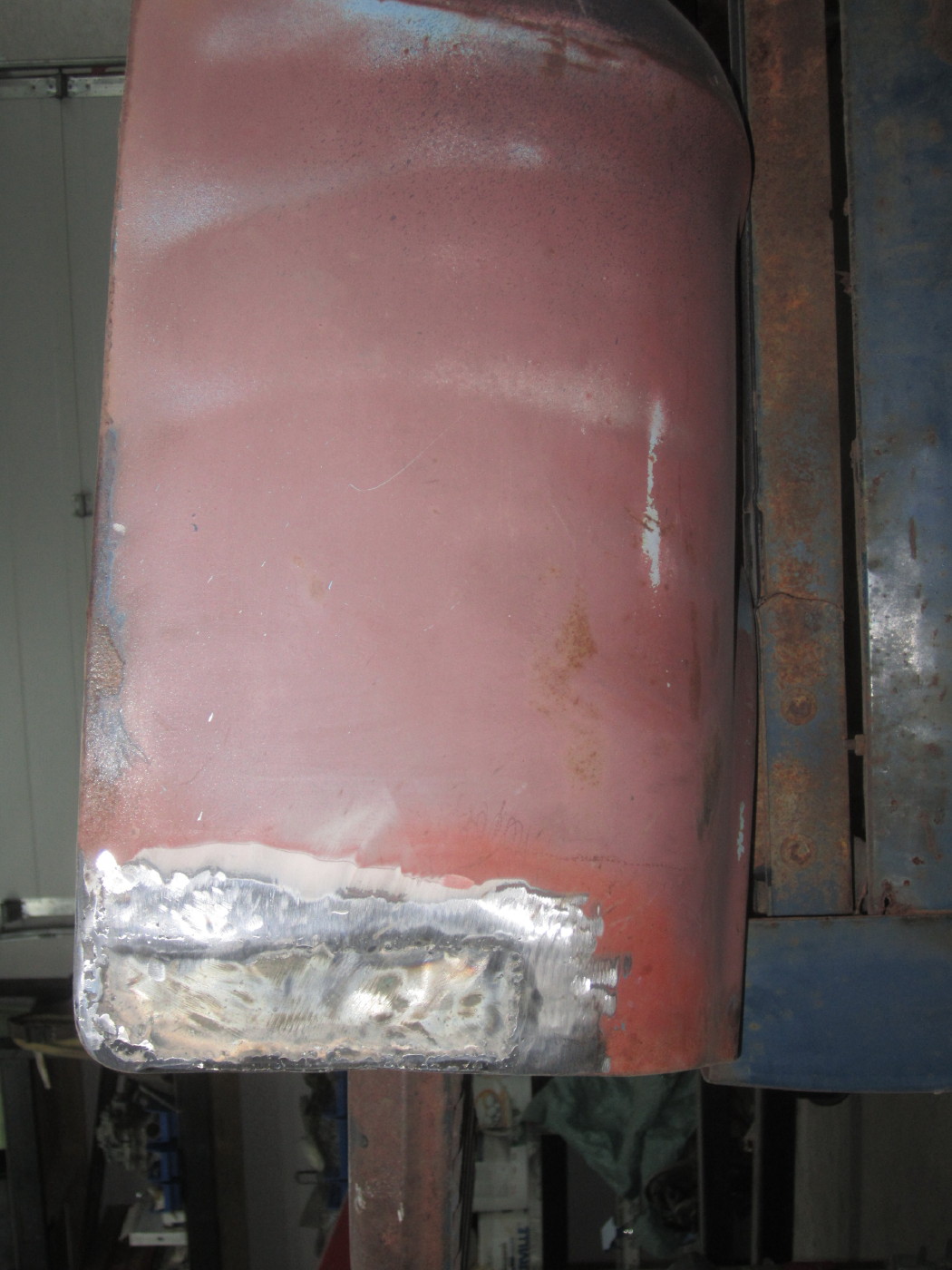

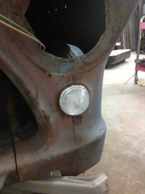

    this weekend was all about the rust repair. The step side fender both had some rust in the same place, right where it meets the step up. Someone had body filled the holes previously so I wanted to make sure that all came out and new metal went in. Also, both fenders were split in the same place on the back end. Obviously it hot something at some point in it's life time and nobody could be bothered to fix it. The passenger side fender had a crease just under the upper body line that ran into the wheel well edge. After some work with a mallet and a couple pieces of 2x6 spruce, it's all straightened out.
    With having this entire week off of work, I anticipate a lot of progress happening. But now I can at least bolt the fenders back on and get the bed mounted.
    The one big patch that was welded in was done with flux core wire. I ran out of gas shielded after my 2nd tack. SO I pounded the edges in by 1/16" just in case my welding was a bit sloppy. It gives me a little room to work the body filler afterwards.

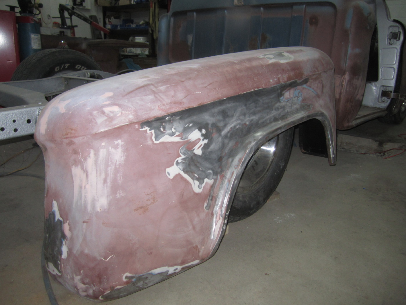

    The front fender is is where I found the bondo abuse. Lots and lots of filler

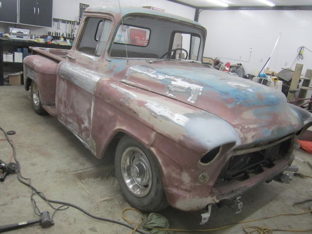

    A bit more progress. The last of the rust has been cut out and replaced with new metal. my hot rod hottie wife was out in the shop with me the entire time. SHe even took on a few tack welds on the front fender. Then she took after the gauge cluster and took it apart, cleaned, painted and re-assembled. And the Rebel wiring harness has started getting installed. The fuse box is mounted and all the wires are run to their future homes. Oh, and we finally got the cab mounted permanently on a new set of cab mounts. I was putting it off because one of the previous owners welded the old cab mount bolt to the cab support so I had to cut the support out and rebuild it with a big washer and some sheet metal

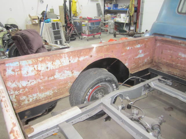

    Body panel alignment was happening this past weekend, and the start of a rear tub job

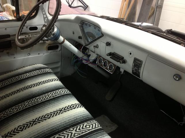

    sound deadening, and wiring along with some door panels were on the docket for these past few days. The material I got for the seat was to small so it's now being used for door panels and the headliner.

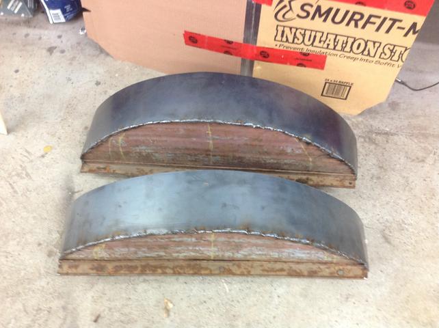

    But here's where we're at with this shop truck build. All the wiring for the engine, headlights and cab is done. We just have to wire in the tail lights and brake switch. The engine will be getting the finalizing touches this week with fuel line, coolant lines, carb, plugs , wires exhaust manifolds etc.... I also welded up some tubs for the box and made up an upper rad support for this aftermarket rad. My wife carpeted the cab and made a seat cover from an old blanket that my folks had kicking around their cottage. So we're almost ready to turn the key on this new engine

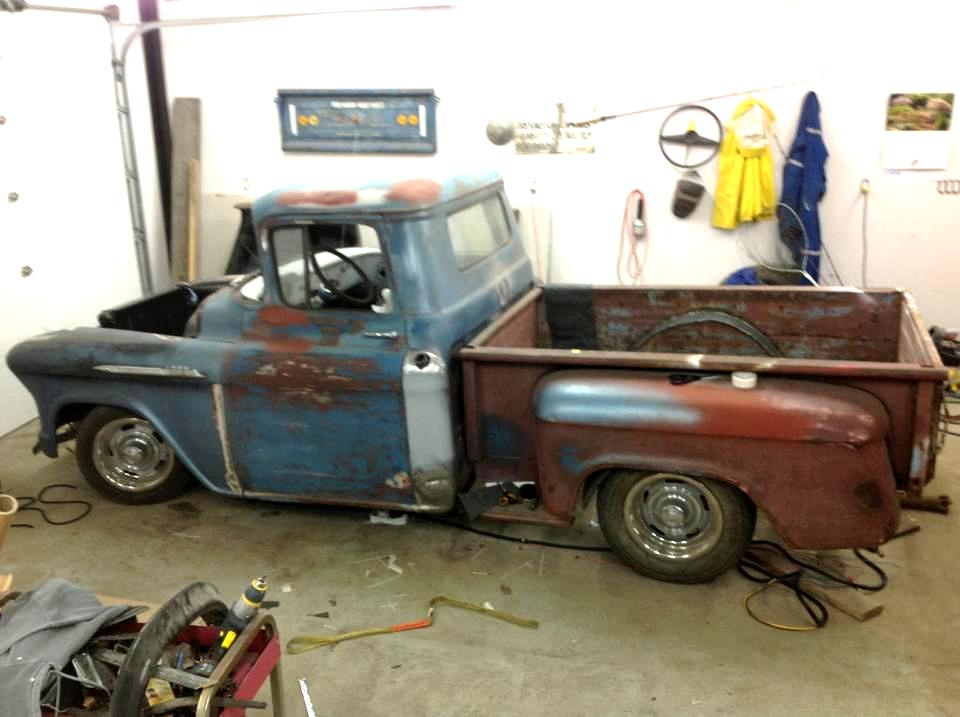

    here's a shot of how the truck sits now that the right tires are mounted. You can get a sneak peak at the headliner the wife stitched up for it as well. She did an amazing job for someone with limited sewing experience

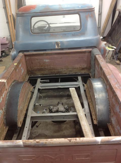

    I go the tubs welded in last night. Tonight I'll be installing some tail lights, running the fuel line, and possibly helping the wife install the head liner

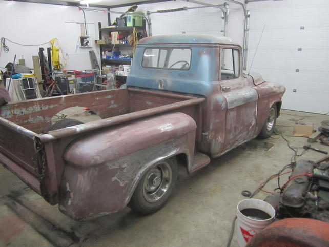

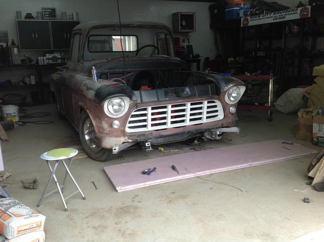

    oh, here's a shot of it with the right size of tires on it. now it sits just right
