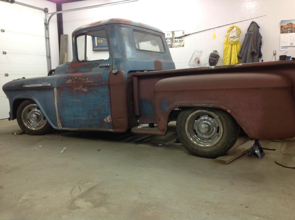

  13. dubie
    Joined: Aug 17, 2004
    Posts: 698
    dubie
    no real noticeable progress this week, just tidying up some wiring in the engine bay and under the dash but I couldn't help but get a good shot of the stance. This weekend is supposed to rain so I hope to gain a lot of ground on the little things to finish it up

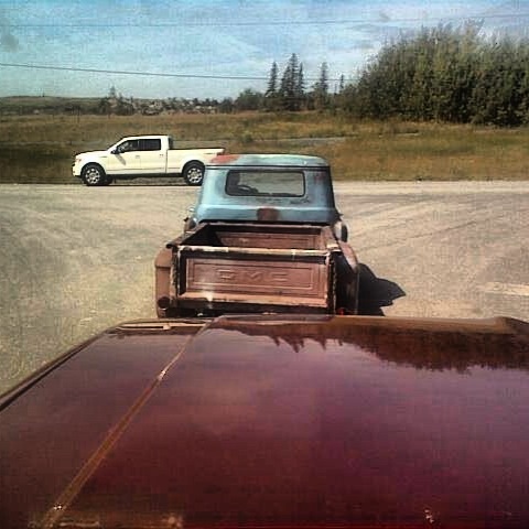

  19. dubie
    Posts: 698
    dubie
    Well it's up and driving. We had to drop the ****** yesterday to replace a brand new torque converter that wouldn't lock up before taking it for exhaust and inspection. That was a bit of a piss off but, **** happens. My buddy that followed me to the shop snapped this quick picture

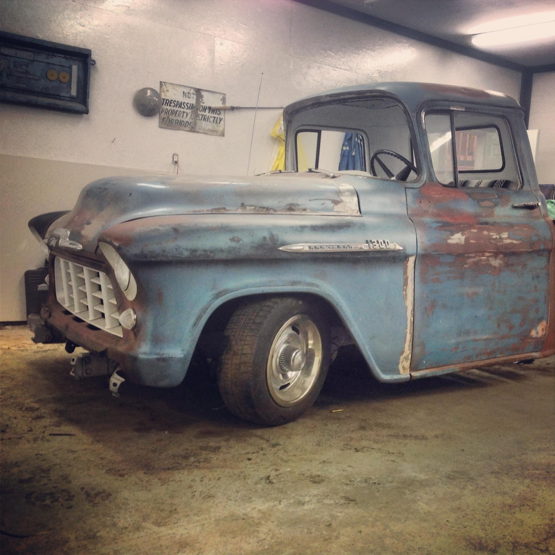

  25. dubie
    Posts: 698
    dubie
    i haven't really kept this up to date so here's a little catch up. I ended up removing the box to beef up the C notch considerably. I know I was told it was going to be weak but I had no idea how loose the back end was going to feel. I was also having some issues with the brakes dragging. Turns out, the rod was slightly depressed into the master cylinder keeping the brake pressure slightly on and then after driving for a while and things got hot, the wheels didn't like to turn very easy. So a few turns out and a couple test drives and things were looking good. I got the heat issue solved by using a larger fan and some water wetter in the cooling system so now it doesn't move over 195.
    Then yesterday, I was heading home from a 30 minute drive and could smell antifreeze right when I was pulling up to my shop doors. The rad had popped a leak in one of the cores. So I drained it out and tonight I'll remove the entire thing and drop it off at the rad shop for repair
  26. dubie
    Posts: 698
    dubie
    a quick shot of the door panels now that they are complete and the Dirtbag awaiting it's rad to come back from being repaired
