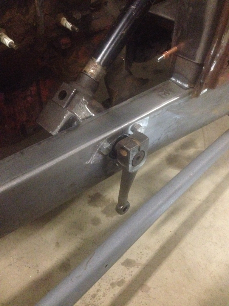

    Looks like we're gonna be trashing to hopefully get this baby to the Roundup this year !! Been working hard on the steering and pedals the last few days , got the F100 box apart and removed the flange so I could get the new flange welded on
    Then it was time to make a column drop for the steering to attach to the 40 dash

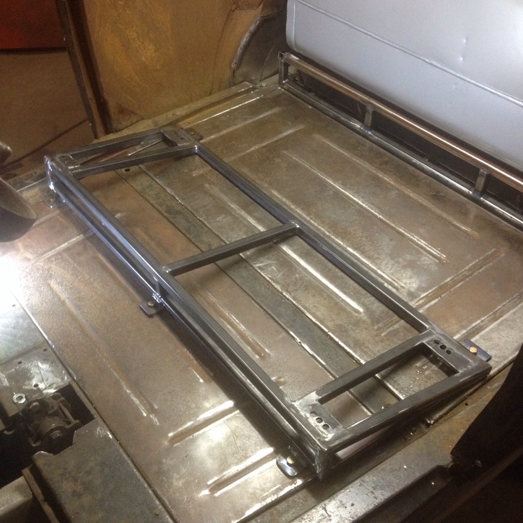

    Now that the steering column was attached to the dash I could get the pedals lined out, whipped up a bracket to weld to the firewall. For the master cylinder and pedals to attach to

    Getting welded in the firewall
    And the master cylinder and (RJays Speed Shop) pedals installed

    What process/materials did you use to weld the new flange to the steering box? We'll hopefully be doing the exact same thing soon.

    Tig Weld with 212 Stainless rod

    Did you pre-heat the box or flange? If so, how hot? And did you keep it hot after welding or just let it air cool?

    Slight preheat then weld root p***, followed by second p***, let cool slowly

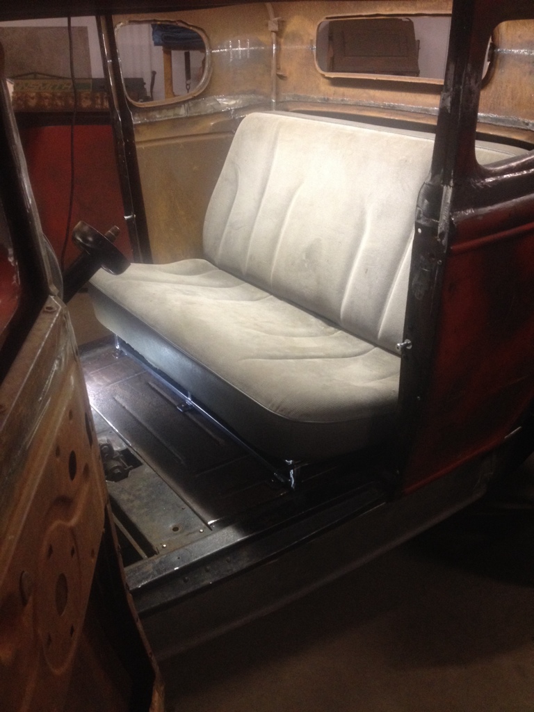

    Also got the seat mount made and and seat mounted

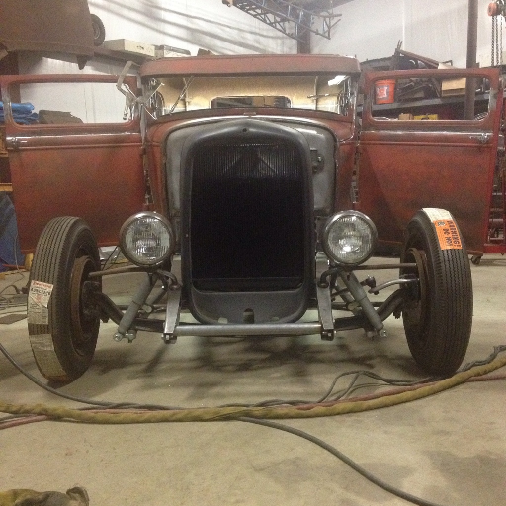

    Alittle headlight set up with the Guide 903-J's another step closer ImageUploadedByH.A.M.B.1456897237.709411.jpg

    That seat fits nice. What's it out of?

    Caravan seat

    What year Caravan, if you know?
