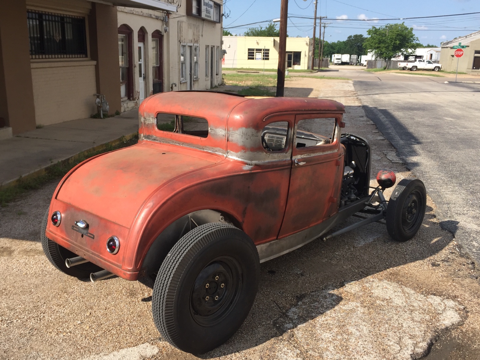

    The last coupe weeks were a bit of a blur trying to make the Roundup but we just couldn't make it, got the body back on the chassis, brake lines plumbed, brakes rebuilt, slave cylinder mount made and plumbed, reared back together, floors finished up, motor and tranny in, driveshaft made, fuel lines ran, gas tank mounted, got down to some title work and realized we wasn't gonna be able to drive it down legally so we pulled the plug, here's some pics of the progress ImageUploadedByH.A.M.B.1459560196.508532.jpg ImageUploadedByH.A.M.B.1459560215.953193.jpg ImageUploadedByH.A.M.B.1459560236.061529.jpg
    Hope too see everyone in Austin next weekend
  9. Rusty
    Joined: Mar 4, 2004
    Posts: 9,483
    Rusty
    Well we finally got back on the Lackey Coupe in preparation to make the Roundup, Pops been getting the wiring finished up and the motor ready to fire up, last night we got her fired up and decided to make a lap around the block, its Alive !!!!

    Question regarding the radiator, I have a very similar build going on and I'm using as many vintage parts as I can. I will be using an original 32 radiator that will cut down and re cored, do you recall how much the radiator needs to be shortened to line up the grill shell and body. The body will be sitting on the frame just as you have done, no pinching or channeling. Most guys say 2". Any input would be appreciated.

    I have a question because I cannot enlarge the pics on my phone. Does your front suspension have a bump stop to keep the tie rod from hitting the underside of the front at full compression? I cannot see anything on my phone so you may have a bunch of room. Just couldn't tell. Nice work!
  20. Rusty
    Joined: Mar 4, 2004
    Posts: 9,483
    Rusty
    Yes it is chopped 2", but I believe it
    Could actually raise up atleast a inch in running a hood

    The tie rod is under the wishbone not on top

    Thanks for the reply, I really want to run a hood but having a Hemi with a hi rise intake may make it difficult.
  25. jackalope
    Joined: Mar 11, 2011
    Posts: 690
    jackalope
    That makes MUCH more sense;-)
    The pic I saw had it on top and "pinched" between frame bones. Roger the bottom orientation. Looks good!

    Subscribed. What is the width of the rear axle (wheel mounting surface to wheel mounting surface)?
  27. Rusty
    Joined: Mar 4, 2004
    Posts: 9,483
    Rusty
    58" flange to flange
