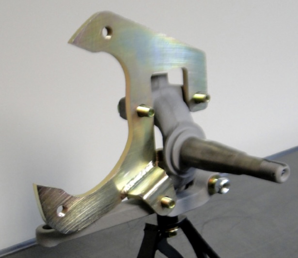

    I've used these same weld on brackets to convert a number of axles to front disc brakes. They sell them for SAE or metric GM calipers, and they are very inexpensive priced. Easy to make up a cardboard template to match the backing plate bolt pattern, and then cut away the part of the brackets not needed, and drill holes. If you want 3 mounting holes a tab of steel of the same thickness can be easily added by welding it on also.

    With the skill’s to draft a bracket and knowing what needs to go where here’s this. On the 56 in avatar I didn’t have the money of CAD skills so I cut factory caliper bracket where they attached to the spindles and pretty much did what the guy’s are say about how they made Studebacker brackets work. I also in corporated the factory dust shields.

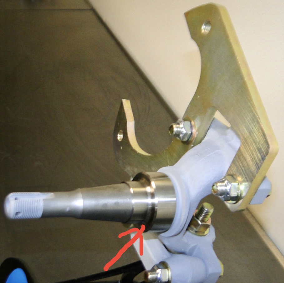

    PDF file just posted 44239985-3A35-403E-9E9E-D33514634B23.jpeg 555F19D6-9FF9-4FF9-927A-B1B210847026.jpeg Here you go. Still will need bearing spacer.
