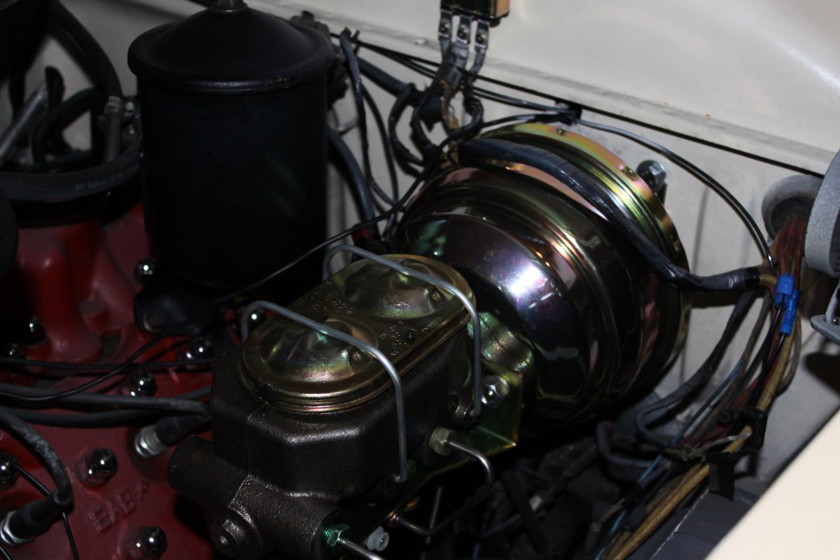

    Did you remove a booster from this system, before you installed the new one?
    If so, can you post a picture of it?
    Or tell me if it looked like this:

    This was a new conversion. It did not have a booster. It is on a 1953 for vicky.
  13. gimpyshotrods
    Joined: May 20, 2009
    Posts: 24,636
    gimpyshotrods
    That is a "Corvette style" master cylinder. Did you bench-bleed it before you installed it?
    I have known them to hold on to a lot of bubbles, especially if it is a dual-sided one, with outlets plugged on the other side.
