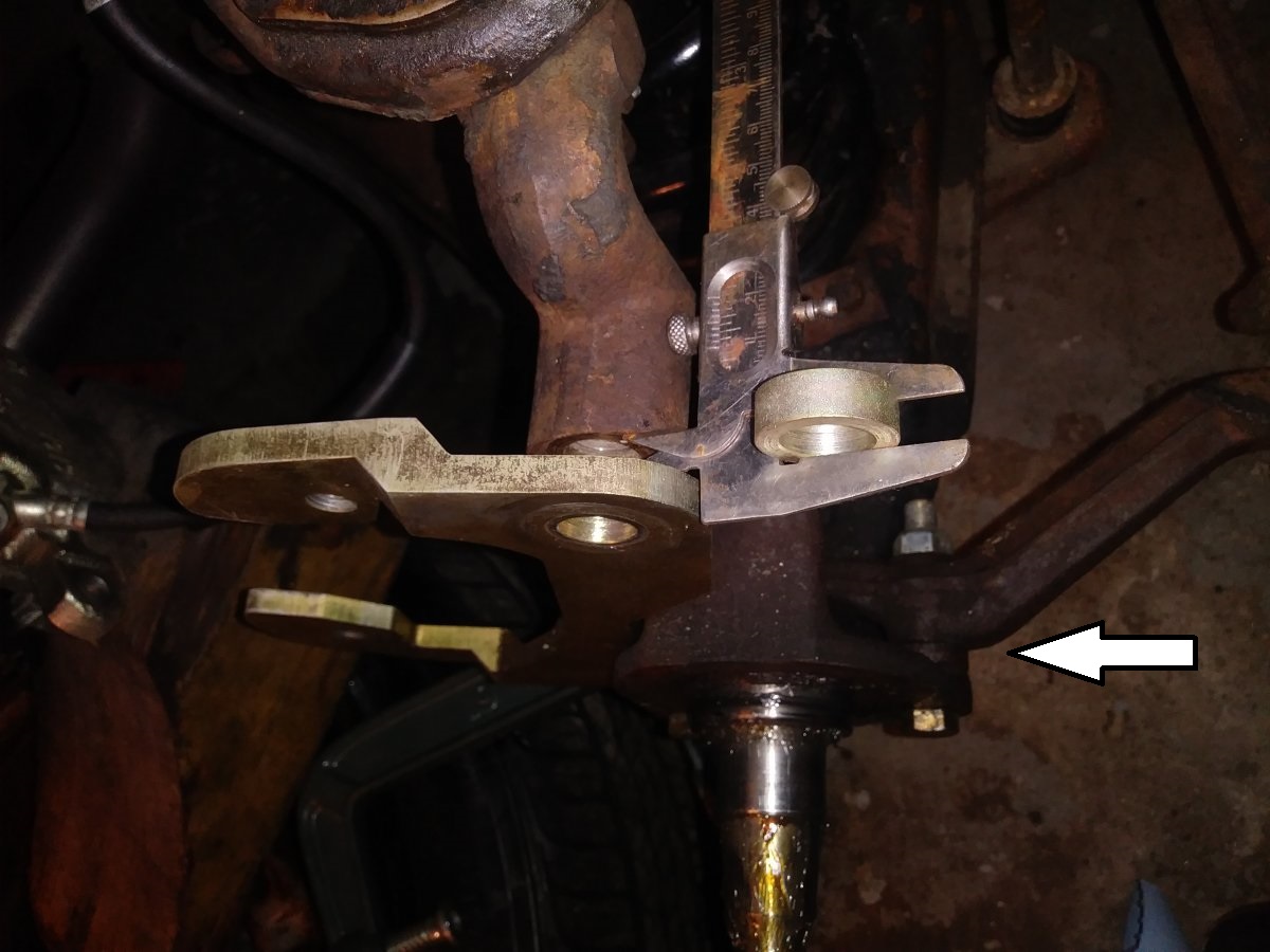

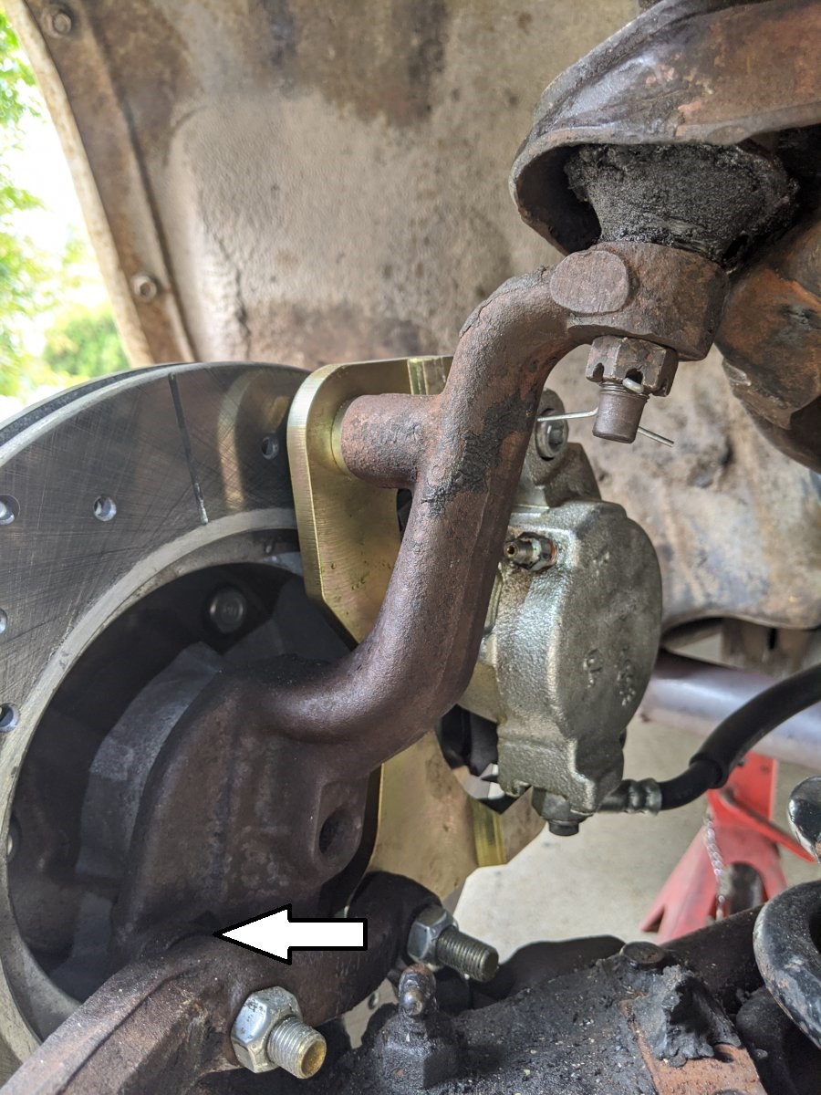

    Speaking of spacers; noticed that in the last batch of pictures that the steering arm spacer (that makes up for the thickness of the added caliper bracket) was not there, looked back at some earlier pictures you posted and they were missing there too.
    Wonder if this could be putting something, other than the steering arm itself, in a bind; or if there is a difference thickness between spacers, the one spacer you are using on top is the wrong one. The bottom one should be the same thickness as the caliper bracket. I don't remember (from when we put the kits on) how thick the top spacer was.

    Looked at the directions for the CCP kit and it says the top spacer is the thicker ones of the spacers in the kit.

    The spacer is there. Zoom in the picture.
    At the spindle, the steering arm bolts in with 2 bolts
    At the first bolts the caliper braket become a spacer.
    At the 2nd bolts there is a spacer ( thinner ). And this spacer like the top is nearly perfect..it fit perfect

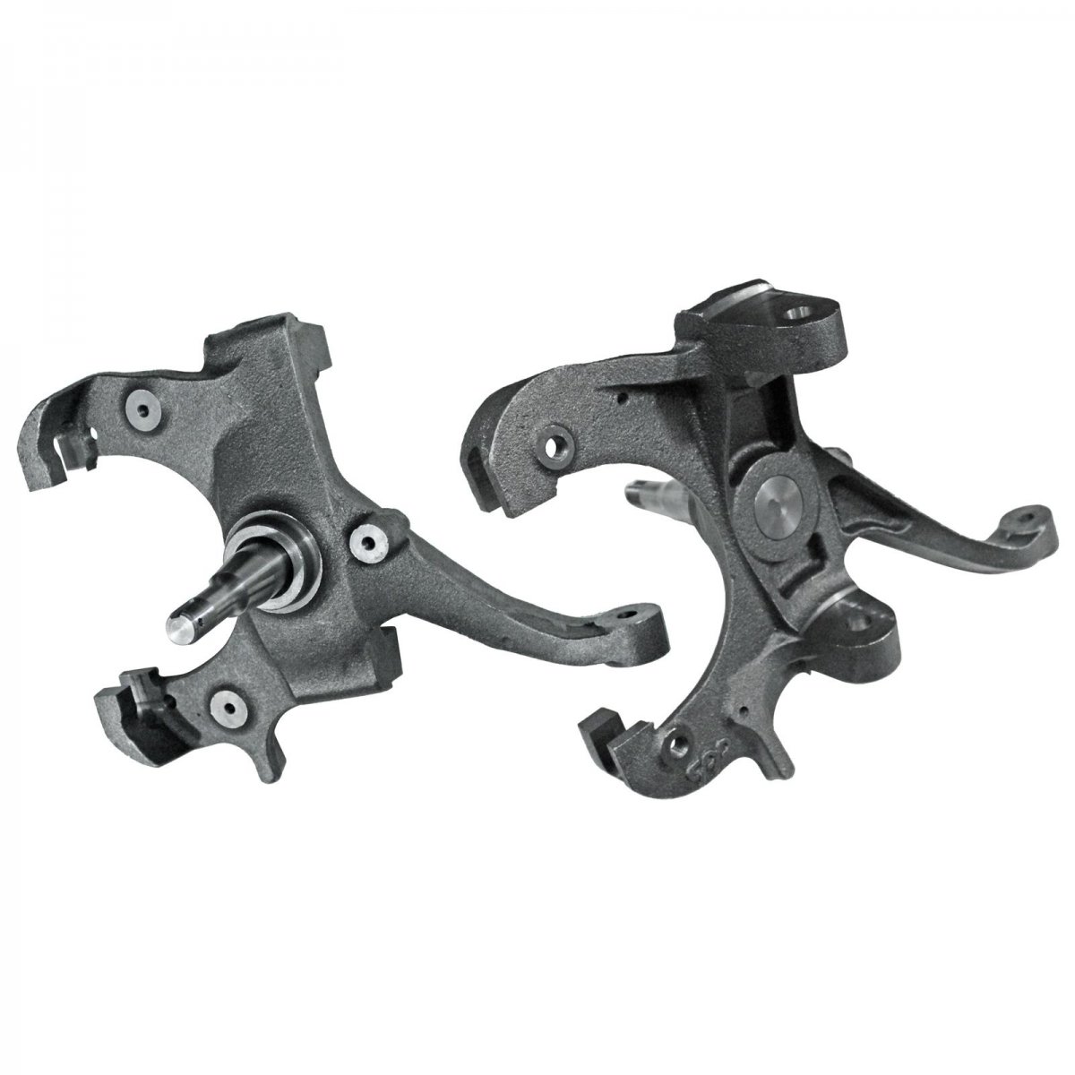

    I am seeing mismatch here.
    If the pictures from the internet are supposed to be the same kit, something is wrong.
    The spindles are different. Just look at the flange where the backing plate attaches.
    Also make a note of where the caliper bracket is, in relationship to the steering arm, between the OP's set up, and the internet pictures.

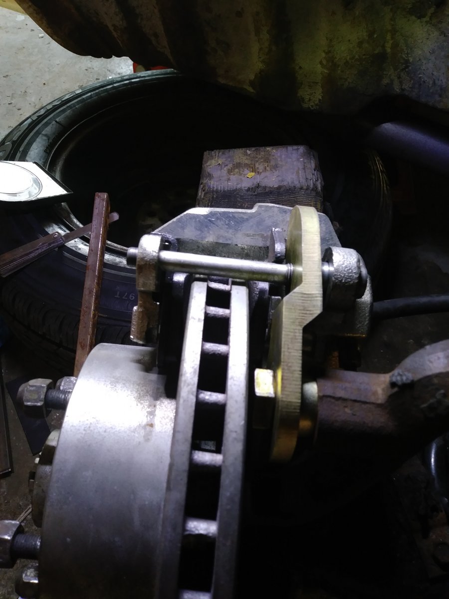

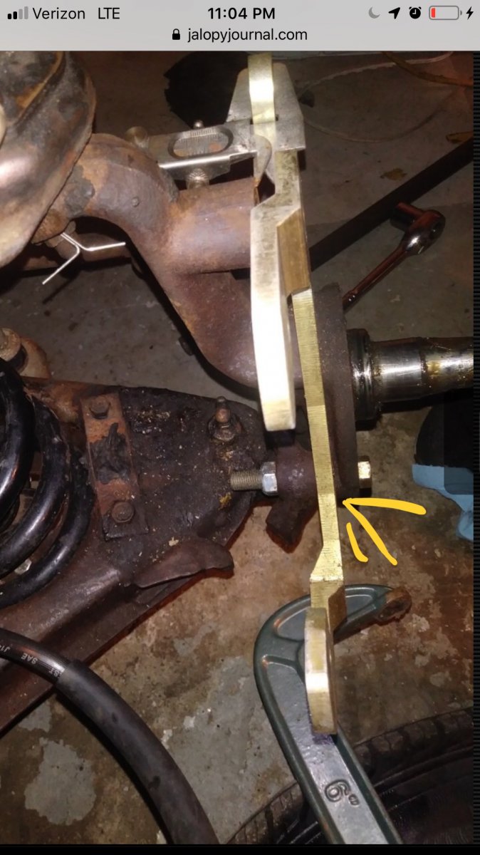

    This photo you posted on #251 [21 Dec] shows something is wrong.
    Look at the angle of the bolt, it should be perpendicular to the rotor.
    Even the clearance of the pads looks wrong [hopefully it is just camera angle]
    But this would cause pad knock-off which would definitely cause the brake pedal to go to the floor
    Also on this photo. Take 2 rulers and hold them each side to see if the "stepped" mounting surfaces are parallel
    Personally I think that those brackets belong in the Trash.
    The brake torque loads get transferred into the brackets which are not in direct alignment the disc [rotating force].
    This can create bending loads on the bracket and twisting forces on the caliper .[made worse because of clearances needed for floating calipers .]
    A good floating caliper bracket should straddle each side of the disc, so that the torque is applied central to the disc.

  16. It took us a year to get pics And then we got them ****job thumb nails.
    Here’s a big blow up of mimilan/Kerry’s marked up Pic.

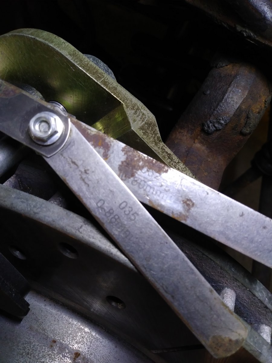

    This picture come from my post from the 20 december .
    3 pictures
    I placed a clamp on caliper to see how much the piston will go back.
    Then yes it left some space or freeplay between pads and rotor
    I swear, pads on..push the break pedal this space is not there anymore.
    I also checked with a gage filler

  26. Going back to post 278,,,,it’s obvious something is not square,,,,the caliper bracket is not letting the caliper and pads sit straight.
    Look at the mounting bolt for the caliper,,,it’s at an angle to the face of the rotor.
    Since these spindles are from an old car ,,,perhaps from a junk yard,,,,oops sorry,,,,salvage yard .
    Isn’t it possible that the spindle might be bent,,,some cars go through some pretty good collisions on their way to the yard .
    Also,,,they get banged up ,,and drug around a lot after they get there..
    If the bracket is correct,,,,there is not much left .

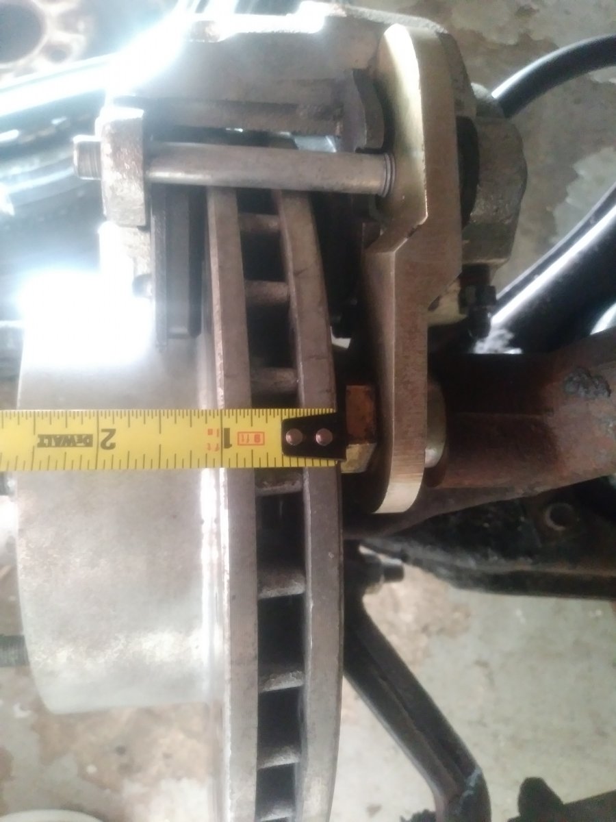

    I checked it out .
    Piston fully retracted .
    I only have space at the outside pads. Not the inner one .
    The space between pads and rotor is .097
    Then i had someone press the pedal. Caliper slides back freely to where it was.
    I also try the caliper without pads ,no rotors , i can slide the caliper by hand through the bolt if i want.
    I now some old pictures caliper dont look square. It must be the lense of my phon
