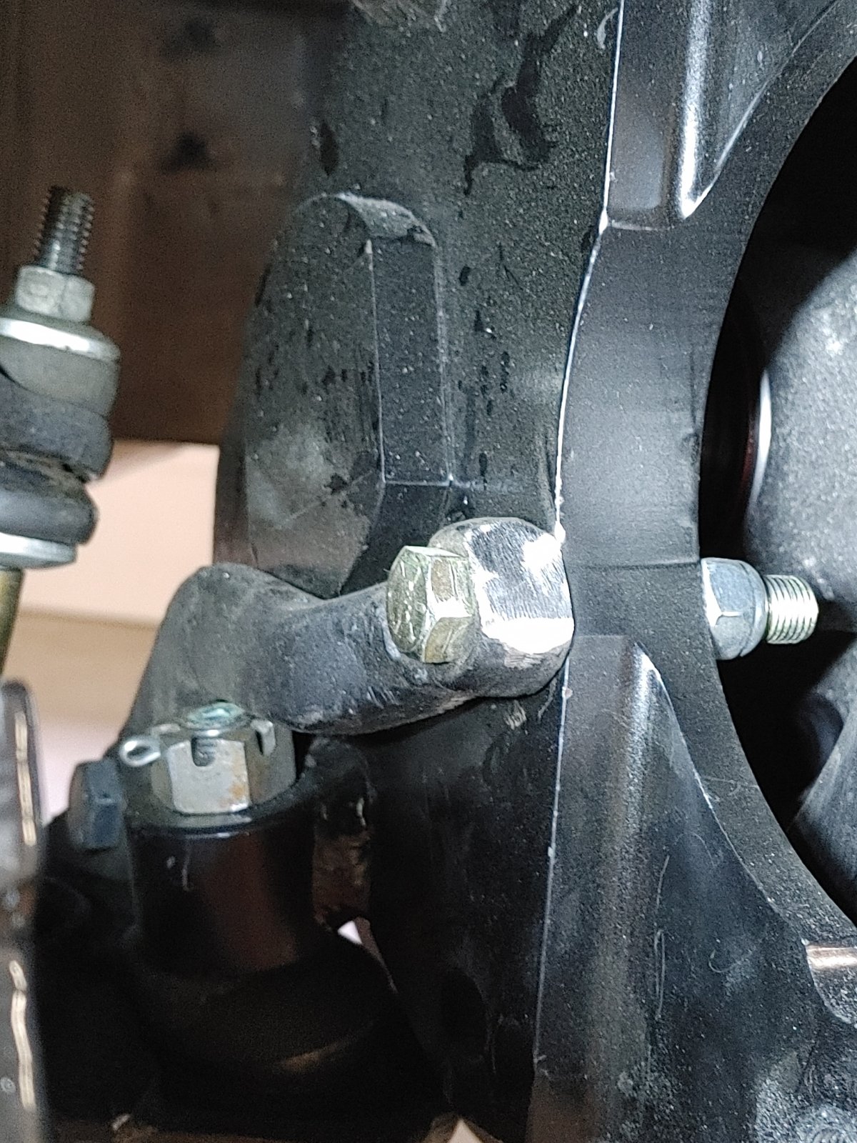

    I know late, but this issue ever resolved? Every thread I follow colds or the members says "I got brakes" but never states what the remedy was lol

  17. OldSoul203
    Joined: Nov 16, 2022
    Posts: 11
    OldSoul203
    Interesting... doubt that is my issue tho, I have good clearance, and I got the bigg brake kit from CCP, so I have two bleeder on the same side top and bottom, I bleed the bottoms first then the Top.. figuring air travels up, same results, I will tire a few more things before I bore the forum with this issue... it's just been a headache for a few weeks, im afraid to even move the car, thanks for the reply
  18. shorrock
    Joined: Oct 23, 2020
    Posts: 196
    shorrock
    Put your calipers on the discs without any bracket, apply the brakes, I am sure your pedal will not be soft now. Measure up the distances to the fixing points of the brackets and make the correct spacers, washers or whatever is needed and enjoy.

  19. OldSoul203
    Posts: 11
    OldSoul203
    Thanks again, about to jacked it up and attemp this, see what happens

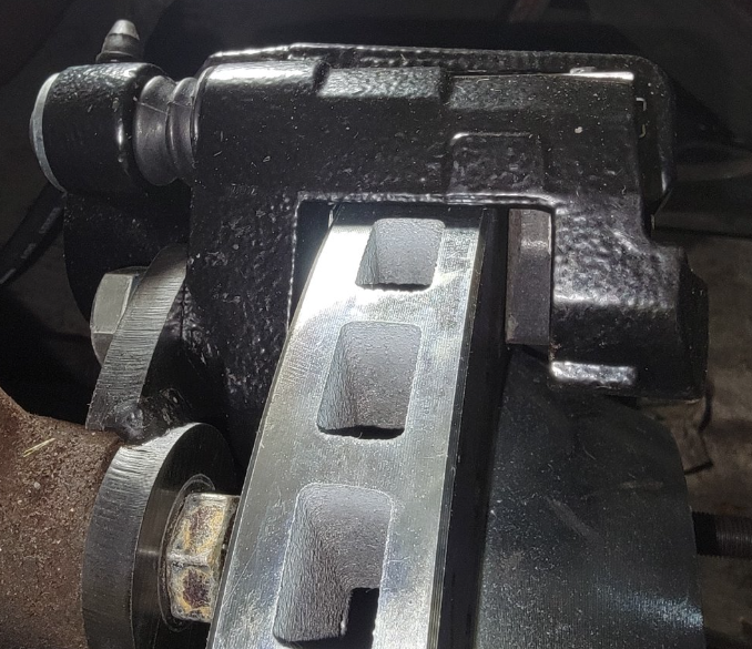

  21. OldSoul203
    Posts: 11
    OldSoul203
    I believe this might be my issue, calipers aren't sitting center... I believe they should be correct?
  22. OldSoul203
    Posts: 11
    OldSoul203
    How can I move the calipers inward... if the mounting is already against the control arm?
  23. Bandit Billy
    Joined: Sep 16, 2014
    Posts: 15,950
    Bandit Billy
    Just a Johnny come lately but I don't see the inside brake pad?

  24. sdluck
    Joined: Sep 19, 2006
    Posts: 3,332
    sdluck
    [​IMG]Why do the caliper bolts look like they are hitting the rotor.
    Vincentnova and Happydaze like this.
  25. rockable
    Joined: Dec 21, 2009
    Posts: 5,060
    rockable
    Yes, they should be centered up and something is preventing them from doing so. They should "float" on the two pins that retain them. Was it hard to get them to line up? If so, see what is binding on them. I can't tell from the pictures. Is the bracket being skewed by the steering arm? It doesn't look like all of that has enough clearance.

  27. OldSoul203
    Posts: 11
    OldSoul203
  28. OldSoul203
    Posts: 11
    OldSoul203
    I can't see any way to get them centered? Stumped at the moment
  29. OldSoul203
    Posts: 11
    OldSoul203
    Both pads are touching (just bearly to the rotor) when the car is turned on the caliper does move a lil (doesn't have to travel far to touch the rotor)... just rebleed everything no change, will attemp a few other things in the morning (adjusting the booster rod on the pedal) hopefull better pics in the daytime... thanks for the input guys
  30. rockable
    Posts: 5,060
    rockable
    I am betting your problem is with the mounting of the calipers, not hydraulic.
