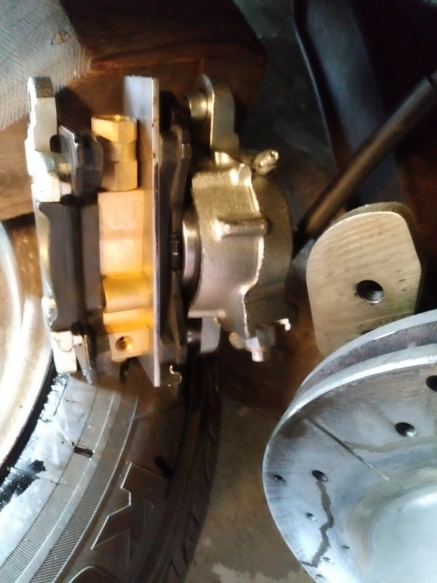

  20. Vincentnova
    Joined: Nov 6, 2015
    Posts: 83
    Vincentnova
    from san diego
    here a picture. How i blocked off caliper. Both side.
    It should eliminate the question about the rotor/camber
    I still got same pedal..
  21. s55mercury66
    Joined: Jul 6, 2009
    Posts: 4,367
    s55mercury66
    from SW Wyoming
    Yes, that should eliminate that as an issue. Hopefully one of the wiser folks will know about the line pressures.
