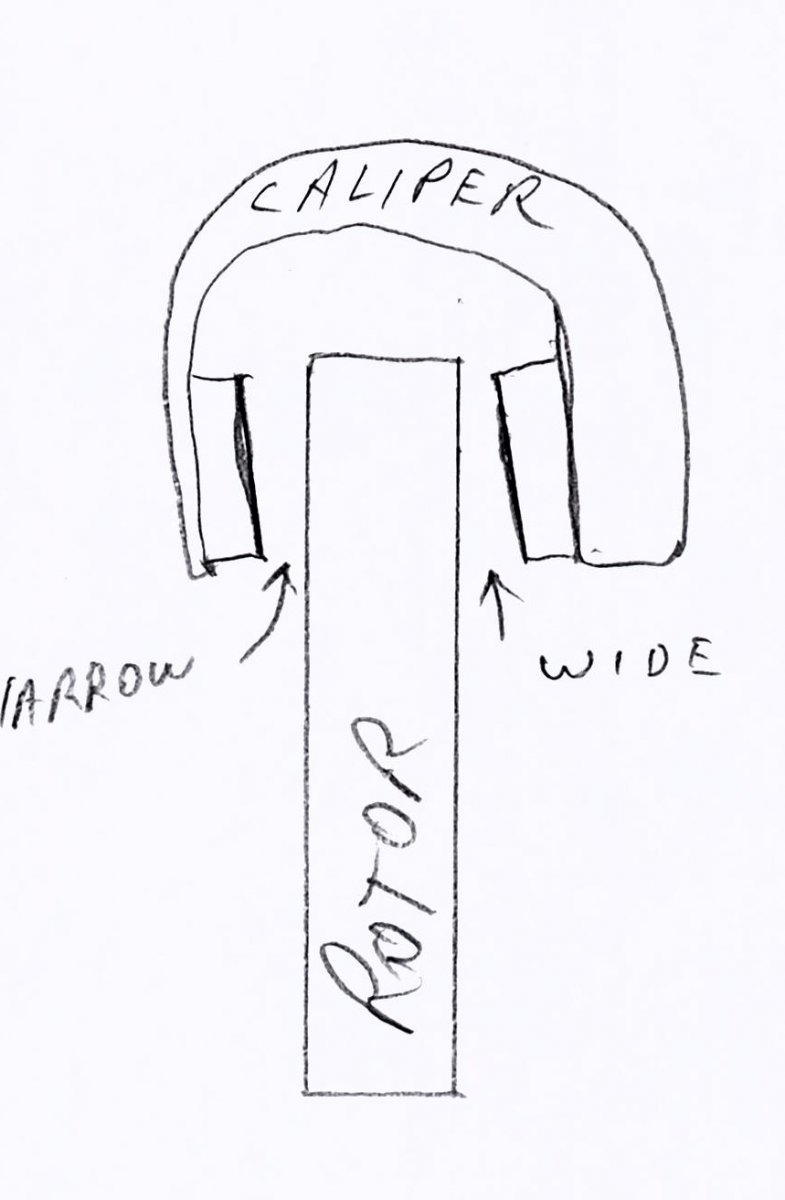

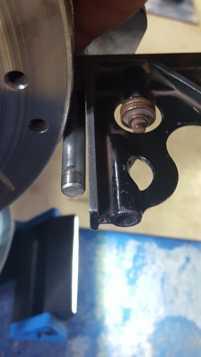

    diceman
    img017.jpg 20190829_112305_001.jpg View attachment 4415050 View attachment 4415050 Did you get your problem resolved? If not I may have a solution for you. I have installed 2 of these systems and have had the same problem with both. Check to see if the caliper anchor pins are perpendicular (90 degrees) to the rotor.
    After I jumped through all the bleeding hoops several times and not once getting any additional air out of the system I started looking for another problem. What I found was the mounting bracket is not square with the rotor. This causes the caliper and therefore the pads to sit ****eyed on the rotor. This means the piston has to travel farther to square itself up before it can clamp the rotor which causes long pedal travel. When you release the pedal the caliper will spring back to its crooked position. When I corrected this problem on mine the brakes started working great. Another hint that this might be the problem is to look at the wear pattern on the rotor. Mine had little or no wear on the inner 1/3 of the rotor on one side and just the opposite on the other.

    Pretty sure at some point in his process of elimination he put solid blocks in the calipers which would negate any deflection of the caliper brackets.

    for now i just cheked the p***enger side.
    and the pins are dead straight ( believe me I wished they were not.....)
