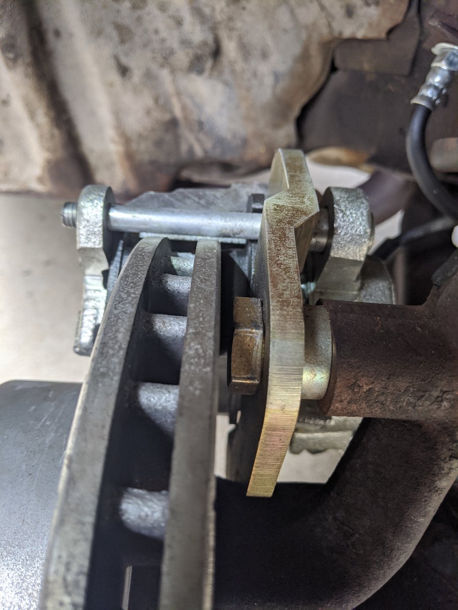

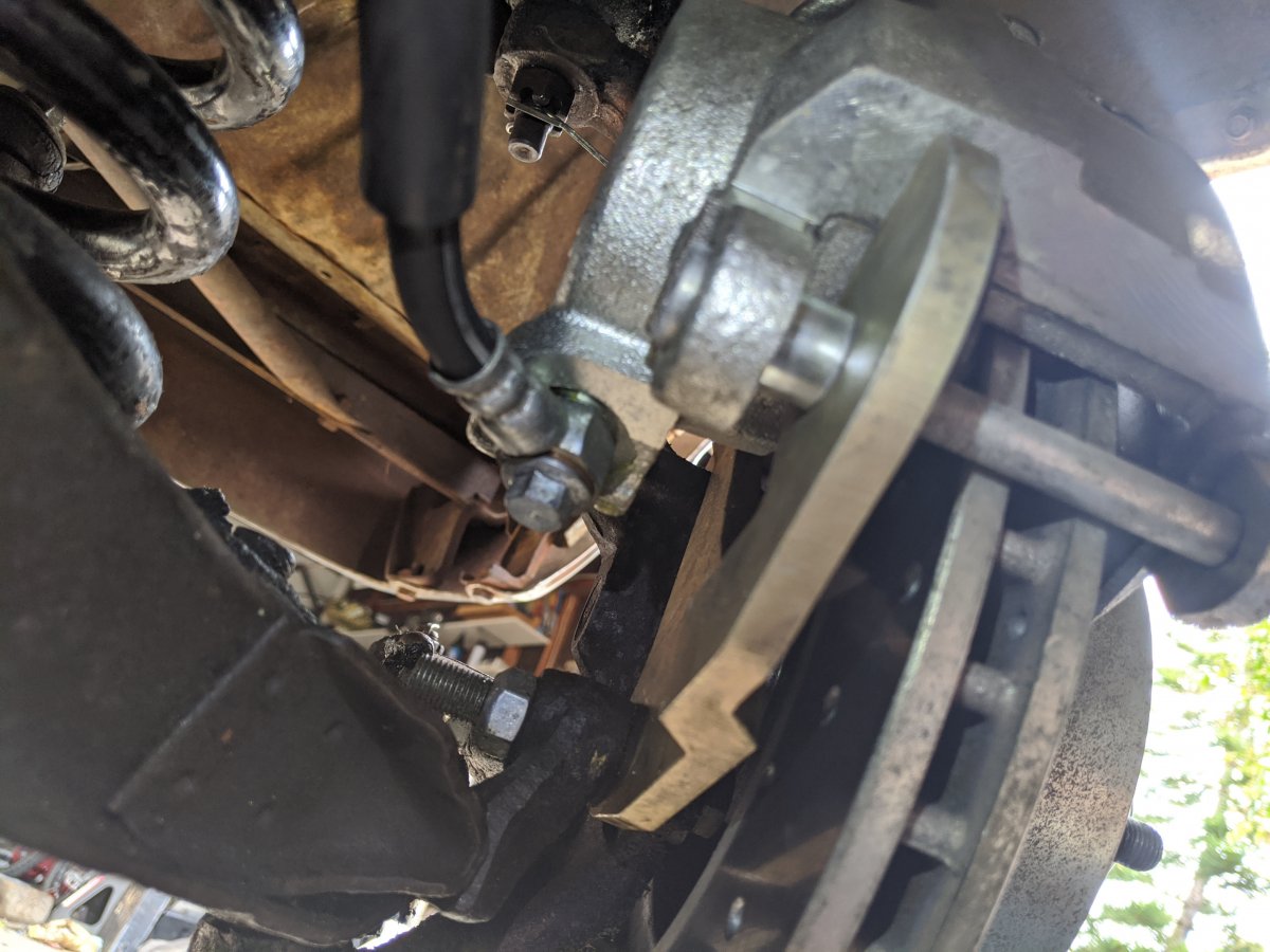

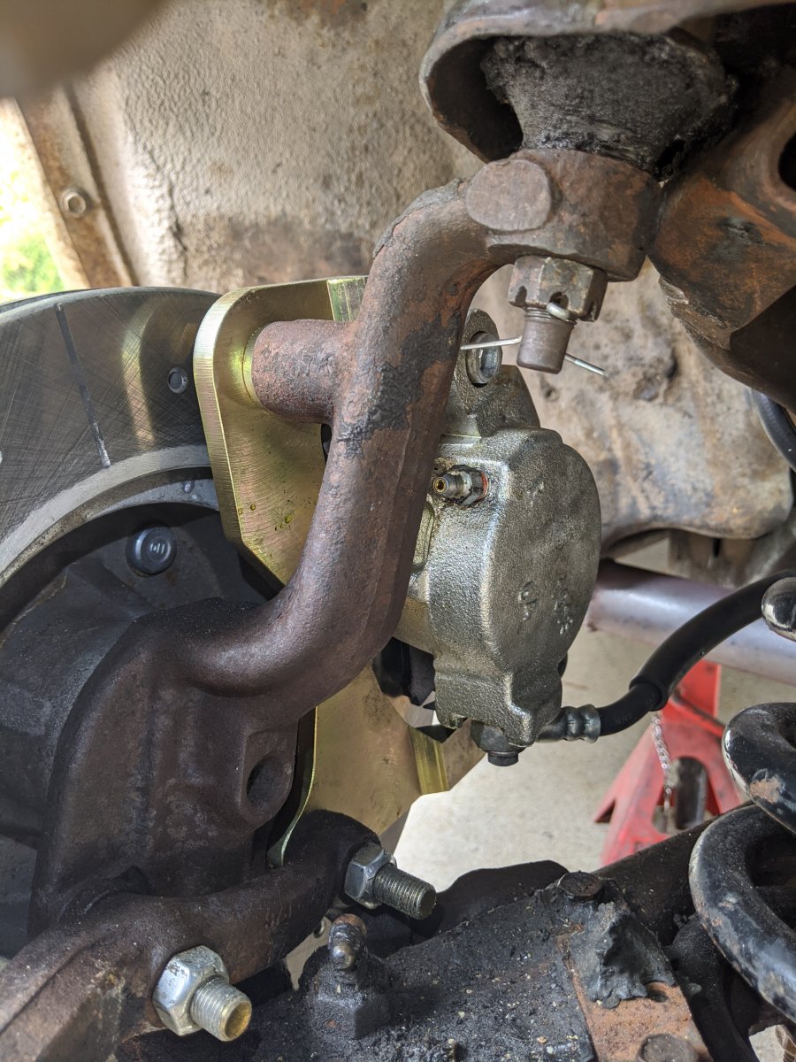

    I will get good picture soon as i can.
  13. Vincentnova
    Joined: Nov 6, 2015
    Posts: 83
    Vincentnova
    from san diego

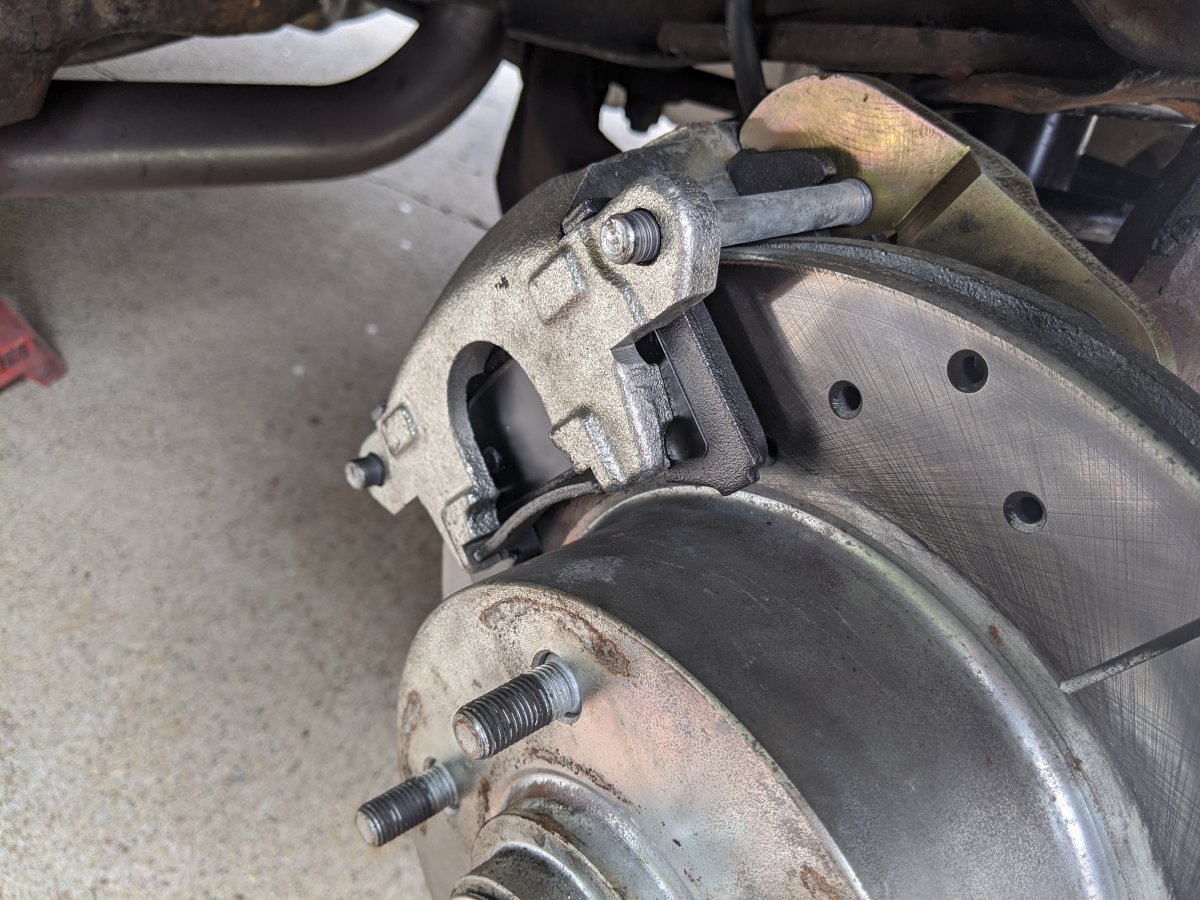

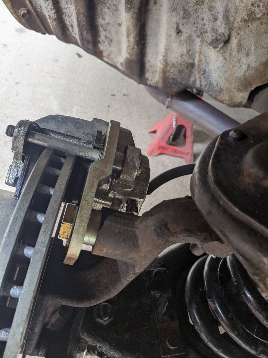

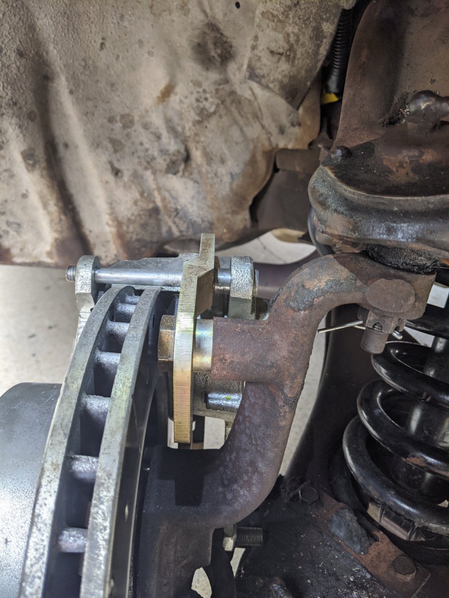

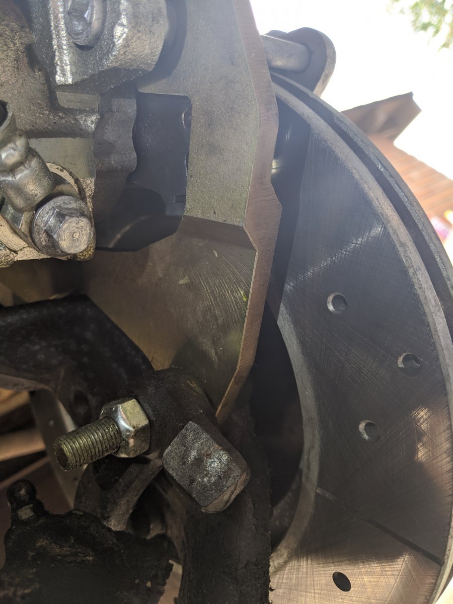

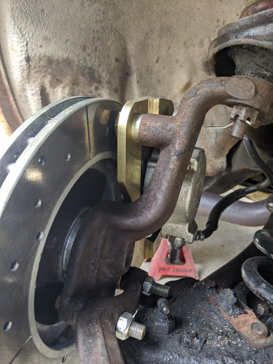

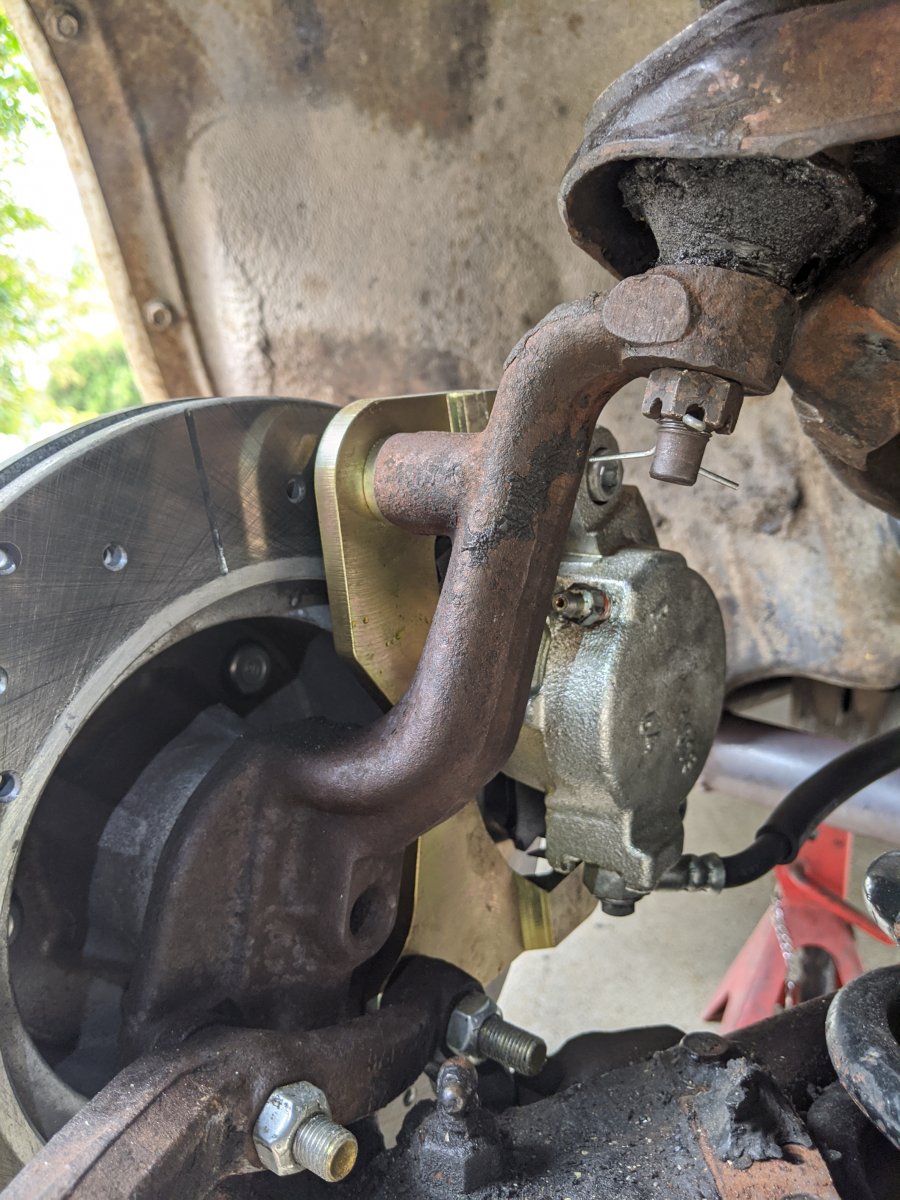

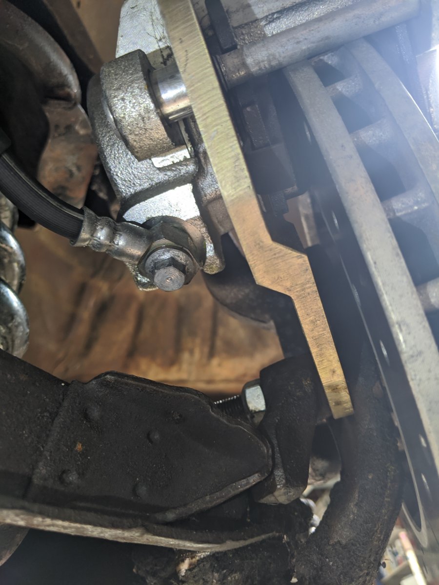

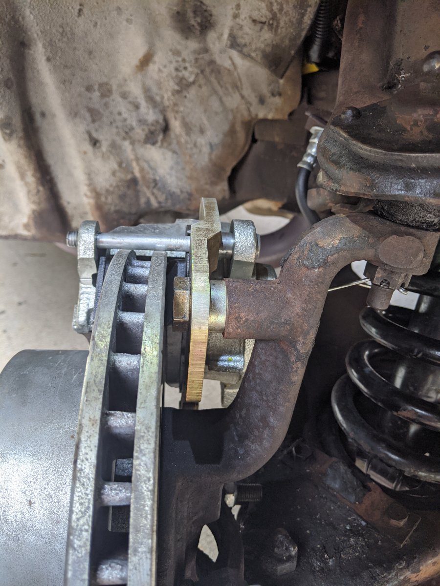

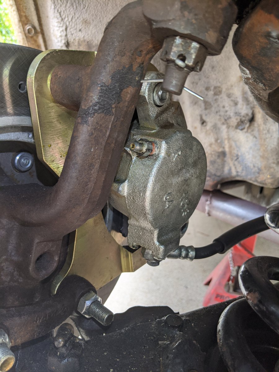

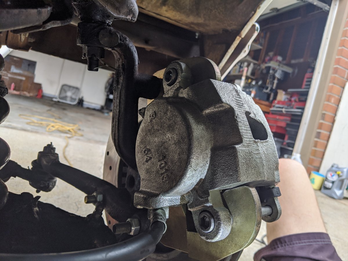

    1.jpg 2.jpg 3.jpg 4.jpg 5.jpg 6.jpg 7.jpg 8.jpg 9.jpg 10.jpg 11.jpg 12.jpg 13.jpg 14.jpg 15.jpg 16.jpg here some pictures. hope guys can see them

    Hard to tell from the pictures, but is the bleeder clearing the very top of the fluid chamber? Could be picture angle, but looks like it could leave a small air pocket just above the bleed port. You may have covered this previously, but worth checking.

    I’m no expert by any means but does that calliper look like it’s not square with the rotor? Where the bracket bolts to the upright it looks there is a spacer between bracket and upright that appears to be making the calliper sit out of square to the rotor.

    Are you SURE the caliper brackets are on the correct sides? It looks like the caliper is riding on the bolt head instead of the slider bushing and there is a lot of bolt sticking out of the other side. It looks like if they were swapped side to side everything would be more centered in the mounts, possibly making for more rigid mounting and all of the fluid pressure being applied to where it's supposed to be and not compensating for a wobbly mounting too. Also, are the o-rings in the caliper slider holes?

    The upper bolt / pin appears to be threaded into the outer part of the caliper and also into the mount. This appears to me to lock the caliper body to the mount, but for the caliper to work it has to be able to slide on the pins so that the outer part of the caliper moves toward the disc providing the clamping force. Looks like you could only have the pad on the piston side pressing against the caliper, ie no clamping, which could explain your problem. Suggest you remove the pads and re***emble to check the free movement of the caliper, particularly moving inboard. Those fancy pad replacement gauges would help!

    After looking at the pics with a fresh set of eyes, please disregard what I posted earlier about the mounting brackets, I really shouldn't post after a 16hr. shift, things tend to get a little confusing to me. [emoji849] My apologies.
    Although it still looks like the caliper is riding on the bolt head instead of the slider bushing. When mounted correctly, the caliper should not have that much of the pin sticking out of the outboard side. Looking at the pics, presuming that everything is installed correctly, it looks like the rotors need to move outward. Were the correct wheel bearings supplied with the kit? Did you get the camber issue sorted out?
  20. Ok something is off
    When you step on the brake the piston moves/goes with red arrow.
    The caliper needs to be able to move with green arrow.
    But the caliper is already at the end of its travel on the slider
    One more pic.
    Take a c clamp and squeeze the caliper full open and take another pic.
    Sometimes pads have the same shape but thicker materials and rotors have the same layout but thicker brake surface.
    I’m wondering if you got narrow rotors and skinny pads and it’s got no room to move closer.
    If squeezing that caliper gets you a bunch of room between pads and rotors and moves the caliper to the other side of the bushing/slider then you’ll know what’s going on.
