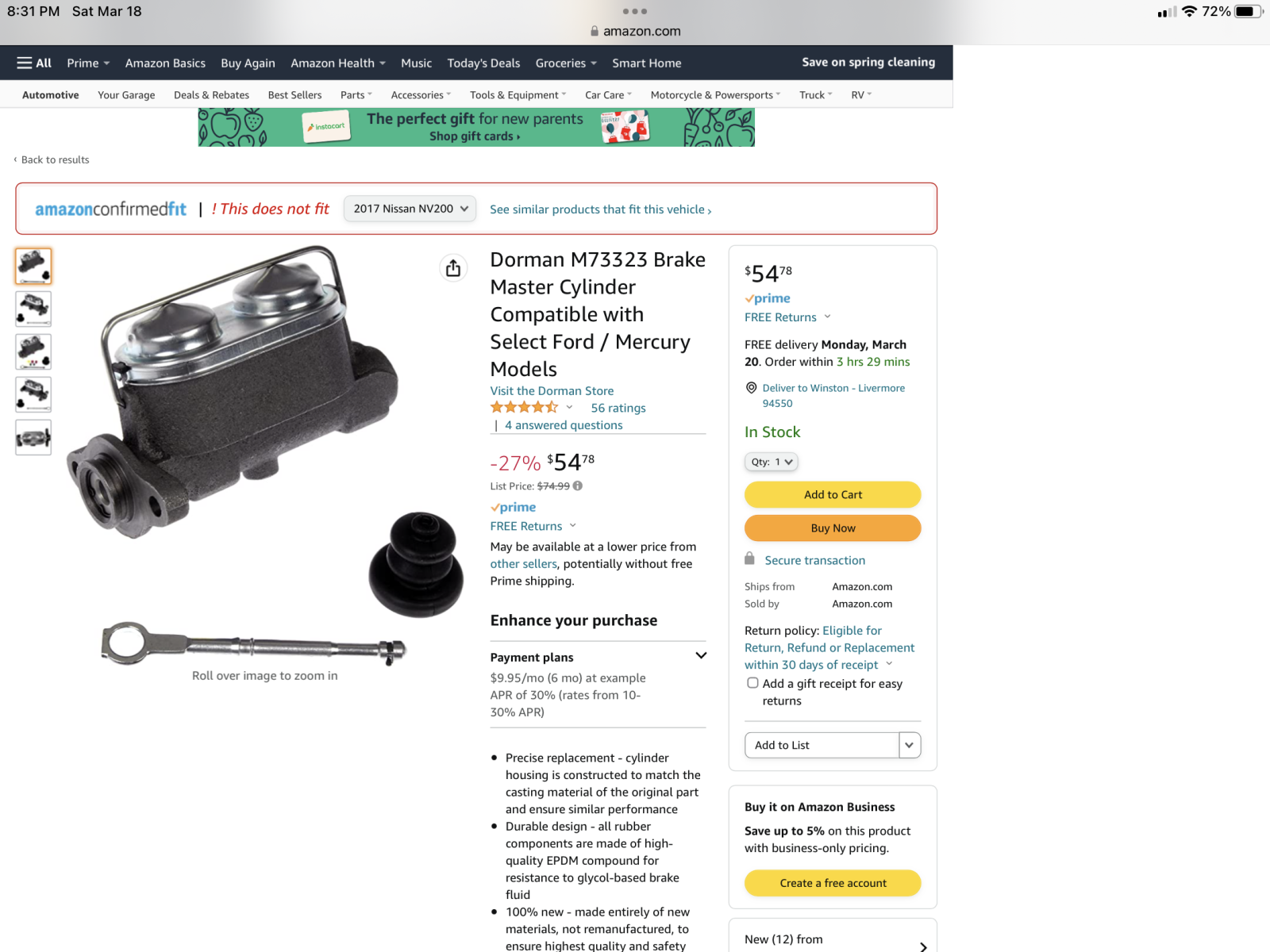

    Got one in my coupe. I believe I removed the check valve in the master. Works great…..but it’s a little car.
  18. 0NE BAD 51 MERC
    Joined: Nov 12, 2010
    Posts: 1,809
    0NE BAD 51 MERC
    Do yourself a favor, get a manual disc drum / master cylinder for a 1969 Mustang. It is a bolt in. Run a new line from the larger fluid port down to the lower "T" that splits the front and rear lines into the port that would normally feed the rear line and run a line from the smaller fluid port to the rear line through an adjustable proportioning valve. Adjust the valve so that the rear brakes don't lock up before the fronts. An extra couple hundred at most and you got your bases covered. I did this to my 64 Marauder. Had a single bowl MC many years ago, blew a wheel cylinder and then the stop sign and almost got T boned. Never again. Larry
    bchctybob and gimpyshotrods like this.
  19. nochop
    Joined: Nov 13, 2005
    Posts: 4,486
    nochop
    from norcal
