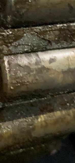

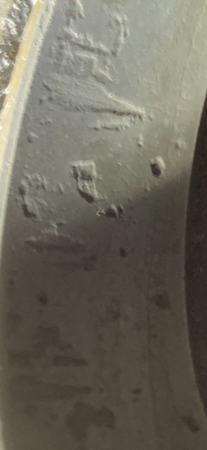

    Speedy way , been doing Business since 1983, Know I do not think I will order anymore from , In November this was a new advertise as professionally assembled third member 9inch ,
    Pics are bearing & Race , I tried calling and contacting customer service five times and left messages no response back,
    This end up costing me three times the amount paid, 2 weeks waiting for a response from Speedway
    CD46E606-AAE1-4020-8396-41B936F3080B.png 25DDC8A6-D103-44A8-AA5C-3EFD94D0EB44.png
