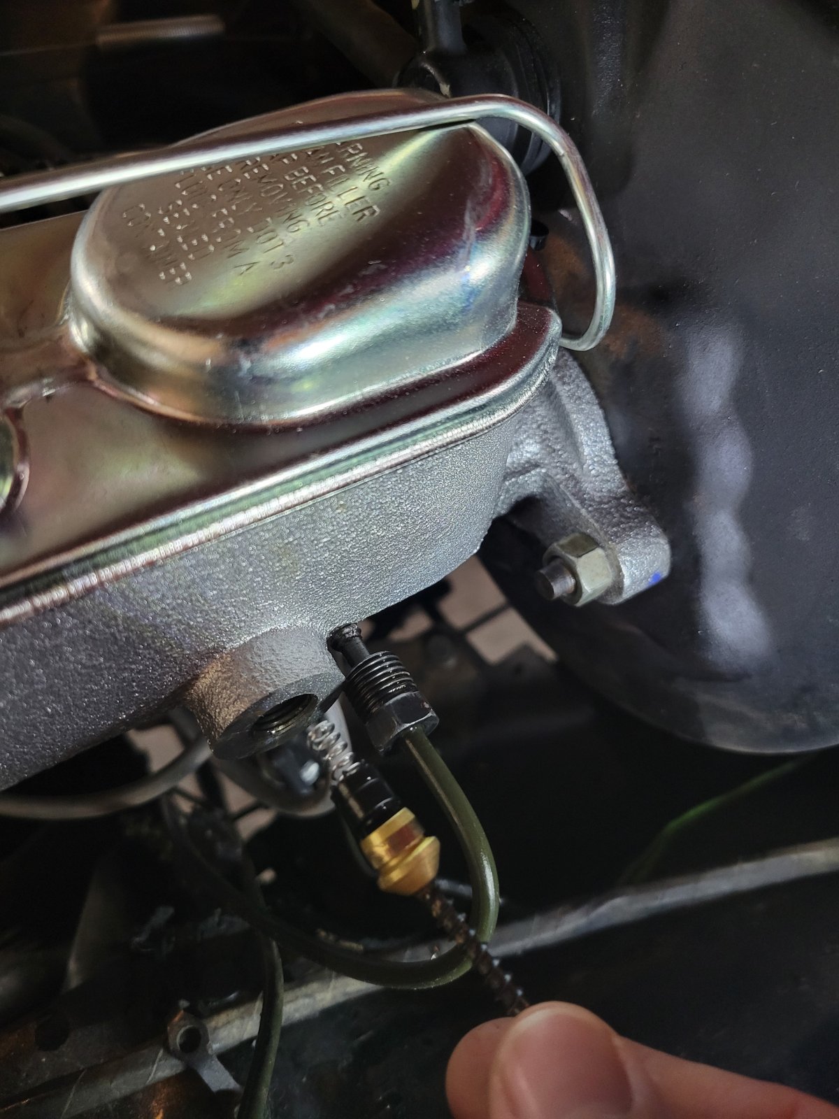

  26. smokinjoe3
    Joined: Mar 19, 2008
    Posts: 18
    smokinjoe3
  27. smokinjoe3
    Posts: 18
    smokinjoe3
    Thanks for all of your responses. Residual valve found and removed. Brakes bleed. Success! Brakes work good!
