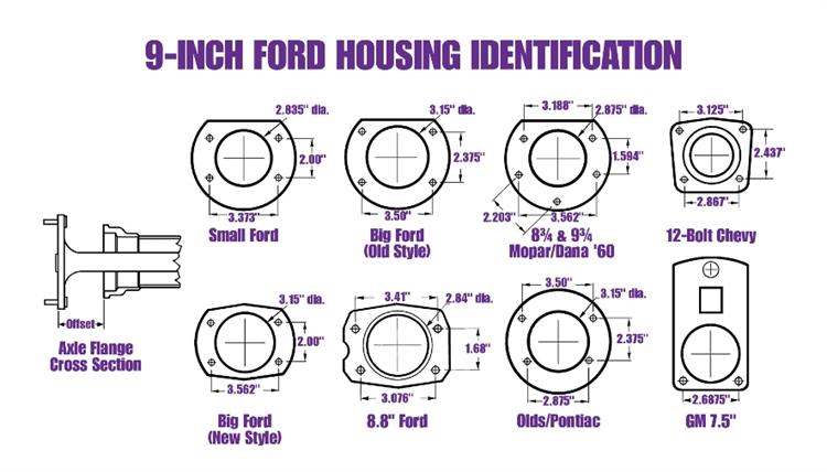

    I read about this swap many years ago and saved from the HAMB only to loose it when computer went down, but there was one topic that was mentioned that I cannot find in this post. Not saying that this post isn't great, because it is. I am scratching my head though because in this post it seems that the Crown Vic caliper backing plate bolt patern and the 8 inch housing flange bolt patern is the same. The Crown Vic rearend would be a 8.8 which is a newer style than the 8 or s/b 9 inch. My charts all say that they are different bolt patterns. Yes they can be made to work , but they do have to be modified.. Where was this step? The difference is to great for the bolts of proper size to just slide right in. click on diagram to see where I am coming from.

    Second question. I am using the disc brake setup from an 8.8 from an explorer. my chart says that all 8.8 rears are the same caliper and dust cover size as for the bolt pattern to axle housing flange. I measured the hole that the axle goes through and it is 3 inches on the 8.8 brake calipers and dust shield. Then measured the 8 inch axle bearing outer race and it was 2.84 of an inch total. So what holds the axle in because 2.84 will go right through 3 inches. Measured them with calipers so measurments are right. What am I missing?????
