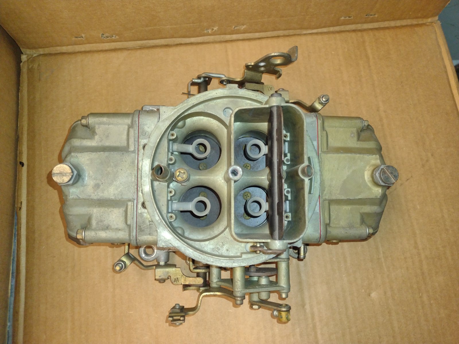

    Hey, trying to Id an older Holley 4 barrel. List 80469 (date 2262), I don’t have any older listings. Doesn’t come up in a search. I just want to know what it was, looks like a 650 double pumper. Thanks.

    How's about more pictures of the whole carb please???... Thanks!...

    So here's the pix. Angled boosters, same metering blocks 11180 front and rear, but the secondary mix screws, vacuum port,and power valve are all blocked. Looks like someone did it on a rebuild. 70 jets primary, 80 secondary. IMG_20230220_064855003.jpg IMG_20230220_064843232.jpg IMG_20230220_064802863.jpg IMG_20230220_064719841.jpg I saw the Camaro post as well. My carb guy is gonna spec it to see what it is, but that's gonna be a while. A call to Holley says it's a later 4776 but not so sure. A 650 with angled boosters? Unless it's a 80496 with a bad stamp. IMG_20230220_064855003.jpg IMG_20230220_064843232.jpg IMG_20230220_064802863.jpg IMG_20230220_064719841.jpg

    Angled boosters? I think down leg boosters was the term. They are not annular discharge. A 0-4776 would be a 600cfm and I don't think they originally came with a secondary power valve or secondary idle mixture screws. It would have 134-142/134-143 metering blocks. What are the throttle plate bore diameters?

    I've got 1.650" on the throttle body, 172 and 173 plates.

    The manual choke and double pumps rules out most factory applications. I'm thinking with that bore size it would be a 650cfm, maybe from one of the Avenger series. They all use the 5 digit list numbers.

    Based on the bowl screws alone its a later version

    Yes, shape of bowls as well. The floats are white plastic. Maybe this unit was so bad, Holley won't admit to it.

    #172 and #173 throttle plates are 1-11/16"( 1.687") .....so it is at least a 650 cfm but could be as big as 800 cfm since the 650 thru 800 all share that same throttle plate size, deciding factor is venturi minor diameters primary and secondary in the main body.
    Difference between 172 and 173 plate is likely just thickness of the plates....I don't have a set handy to check at the moment.
    Standard 2 corner idle Double Pump would not have rear mixture screws nor a rear power valve. Secondary block may have the same ID numbers, but will not be finish machined for power valve or idle mix screws or vacuum port.
    A 650 cfm would have downleg boosters, only the 600 cfm and 700 cfm have straight leg boosters in the Double Pumper line-up.
