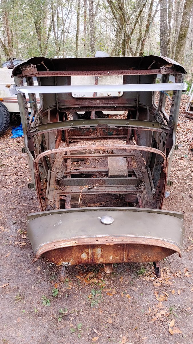

    Needs a sub rail/frame job. Just imtimdating. Draw a line 6" from the bottom up. Everything below that line is shot! I've seen worse become prized rides.
  27. I would love to find an A in that shape.
    It’s just metal.
    Sub rails are a a available new. Yours look better than ya described.
    A patches are cheap but if you make your own you learn a new skill.
    We can help.
    Place the body on a square and dimensionally correct frame.
    Start squaring up the body and fitting doors

    Its not the worse I've seen.

    That is a "Dream Car" for someone like myself that has added a channeled 30-31 Coupe to my list. Builds and projects are the fun part, how many weekends would you use a finished car?
