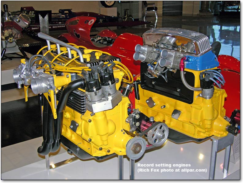

    The Plymouth was 213 cid and used the same cam and pistons, rods and pretty much everything as a flathead and with the Y block head. In the same car, seen on left, and at El Mirage it was 23 mph faster with the OHV head, which was much less than optimum.

    Yes both engines were 213 inches and 9.5 to 1 CR. The same rotating and reciprocating ***embles were used in both engines. Same cam. Twin plugs on the flathead but it ran the same on one. A 57 Ford Y block head is far from the hot setup when building a race motor. And the bore spacing was close but not right. So every cylinder had it's own combustion chamber. One with the exhaust valve mostly over the deck. One with the intake. Two with both half and half. 3.750 bore was much smaller than width of combustion chamber in the head. But it ran and was interesting and fun. A Hemi or any OHV Cad conversion would be the same. Would it be better than scarring up a V12 Cad OHV engine to run in the same cl***? Or maybe an International Harvester or other truck engine of 370 cid? Depends on you and what turns your key. For me it was a Plymouth with a Y block head. Worthwhile to me.

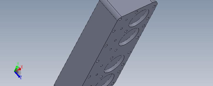

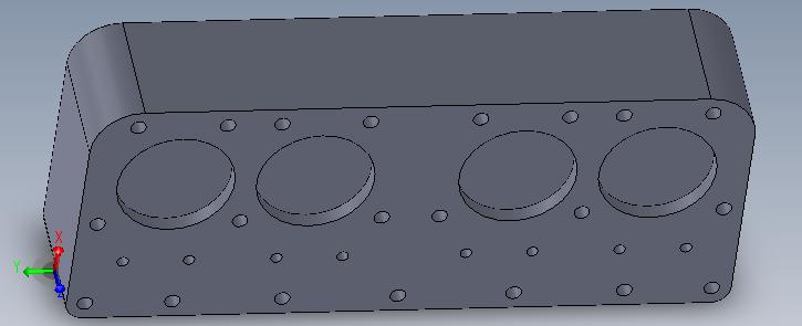

    I have a tentative plan here, on how I'm going to do this. Having very little experience at this, correct me where I'm wrong.
    I already have the current head design on CAD, so I'm going to make a 'blank' head, with only the head bolt holes, and holes for the push rods and valves. I'll scribe a circle to represent the cylinder bores. Then I can try and get the valve train to work, and I'll know what areas I need to leave material in when machining, for the valve train.
    Once I get that figured out, I can work on the chambers, and valve seating.
    Sound like a plan?

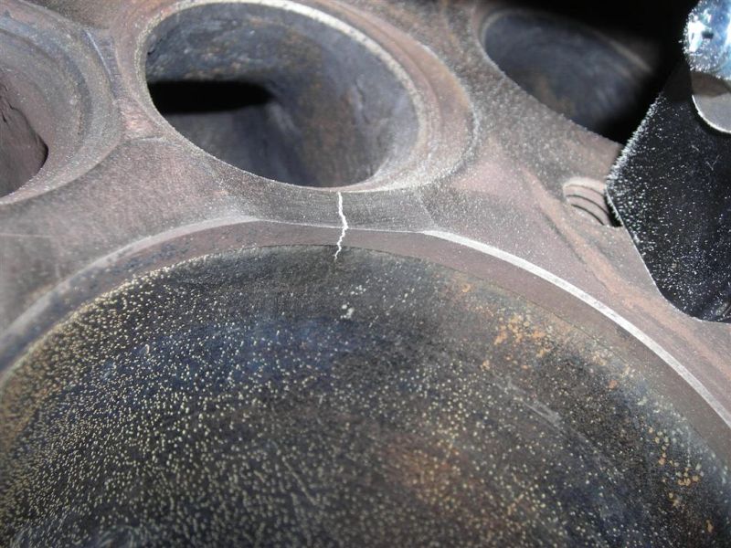

    Yes. A little welding and decking and your home free. Good time to fix that crack. The challenge is finding someplace for the pushrods to go. You may find that a very tall lifter helps with your angles. You will have lots of fun noodling over this one.
