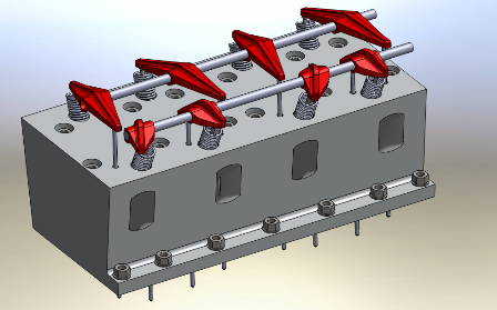

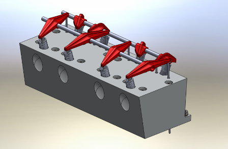

    Mike has been busy 'modeling'.

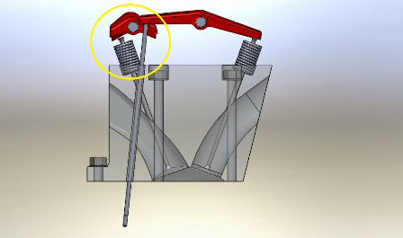

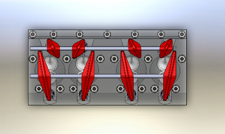

    This rocker ***emble is based on the Hemi style head, and current location of where the pushrods would come through. The intake rockers are awfully short, and we may move the pushrod path.
    This mockup is just an initial drawing. The rockers are 1:1, and will be changed.

    The chrysler hemi's have bigger angel betwine the valves.
    With your style the valves be verry long.
    The good thing with your style is the chanels is verry stait but the heads will be verry high
    One more thiing about your style is they will give higher compression with flat top pistons.
    Maby it will be an isue with the long valve shafts the maybe give sealing problems and big load on the shafts.

    Stefan, we are playing around with a larger angle between the valves. This will also help us fit larger valves in the chamber.
    Chrysler can get away with the larger angle between valves, because they had a larger bore diameter, and bigger chambers.

    Here´s a sectioned hemi head for comparison. It´s a touch flatter than what you have!

    Thanks James D! I'm going to cut up a 241 head in the morning, to get this view.
    As Stefan mentioned, these head designs are taller than stock, but only by 1 inch (5 inches tall). We may go back to the 4 inch (stock height) head, but only if this taller head does not flow better!
    Obviously, this is only an initial design drawing, that will fit the car. There are still a LOT of issues to work through.
