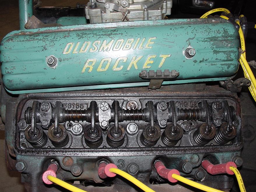

  13. I don't know how helpful this is, but I just went and took a few snaps of my 1953 Oldsmobile Rocket 303. It's totally stock. I know the Cad & Olds motors were the same somewhere around these years.

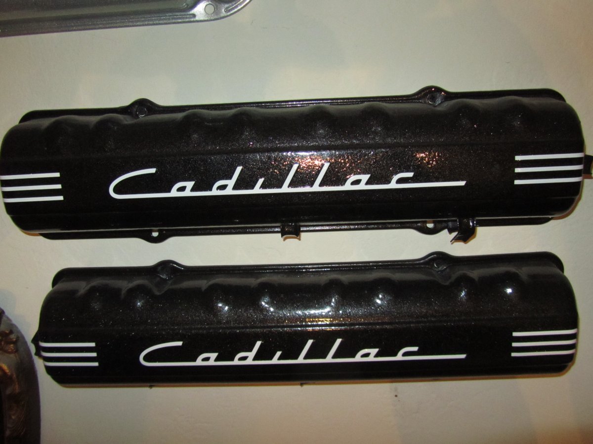

    I have these 331 Cadillac "Dimpled" valve covers, were rusty chrome, but I had them powdercoated and added aftermarket decals. These valve covers appear to be stock or 1950's aftermarkets, heavy steel.
