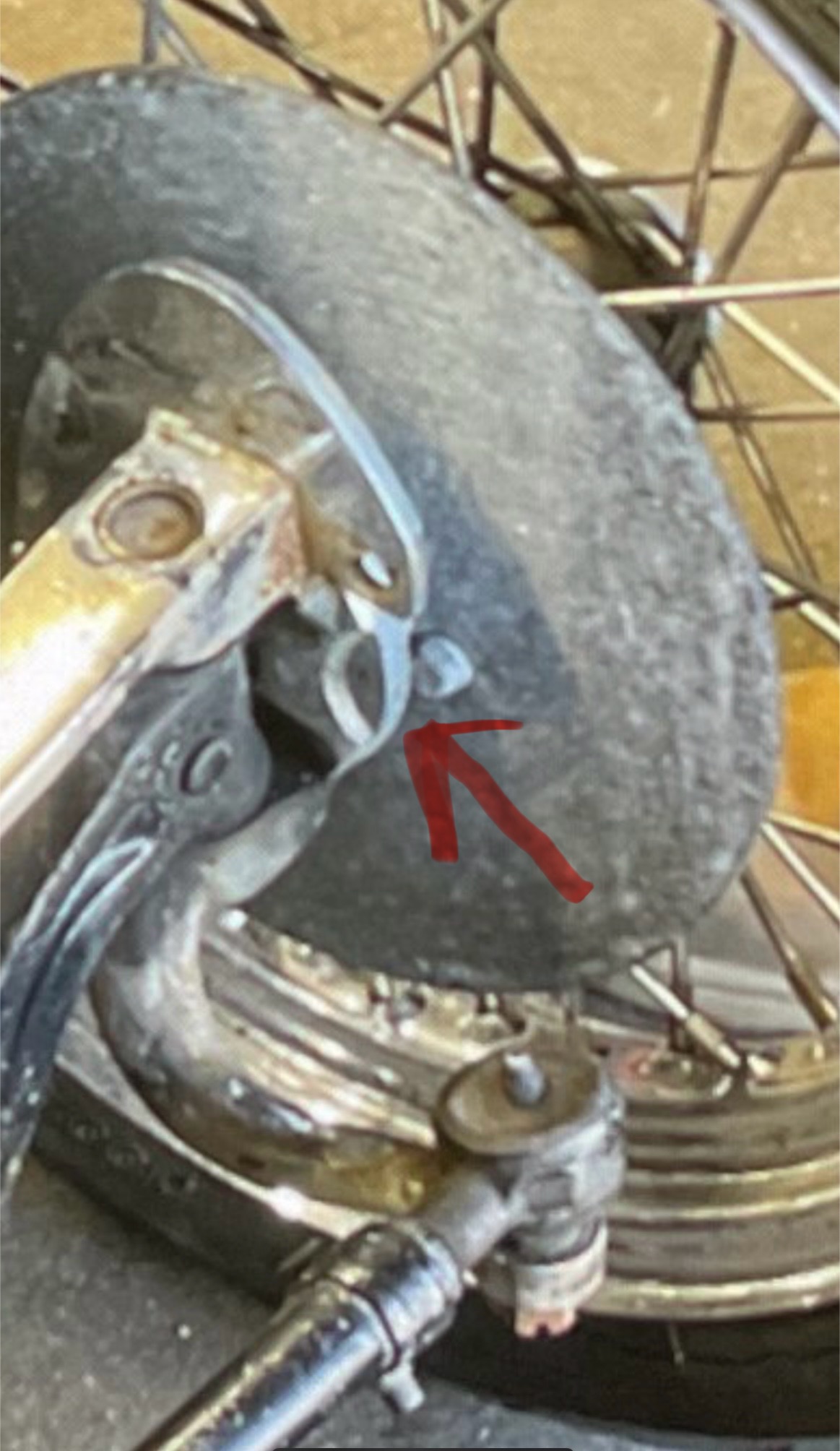

    A neighbor is wanting to install disk brakes on a crusty survivor T-bucket with spindle mount wire wheels. It seems by the lack of disk wear that it may never have had calipers. The spindles don’t appear to be 37-48 round back type. Any suggestions for parts sources for this setup will be appreciated. I do see Speedway offers a fancy kit with disk and Wilwood caliper.

    As you know, it depends on the spindle and the wheel. Speedway used to have a kit and the wheels, but it seems they are both discontinued.

    Yours looks like a Total Performance or Speedway, with the spindles they offered. Those usually had a tube axle, not the I beam you show.

    Did someone modify some OEM spindles, for appearance ?
    Looks like it.
    Is that really a brake rotor ? Or just a round piece of thin steel ?
    I would say: Take it apart, and see what is going on.
    Might be able to figure out what the spindles used to be,
    from the bearing and king pin dimensions.
    The steering arm on top of the spindle, looks like it has been modified.
    Take a look at that, make sure it is safe.
    Hard to tell from the pic, is there a bearing below the king pin boss on the axle ?
    Was this ever on the road ?
    Sharpone and RodStRace like this.

    Thanks, good comments, will p*** along. I’m glad it’s not my project! Remarkably it seems to have been driven enough to wear out the tires. The best solution would be to replace the whole front end so all is known and safe.

    AFAIK no one made a thick rotor for that style wheel, and all the kits I remember used a pretty small caliper so the thin steel rotor is typical. The spindle has a radius visible (arrow) so it is from a ‘37-‘41 Ford front end that someone added a steering arm to. Could what is above the spindle be the makings of a caliper bracket?
    The tire contact patch is small with that tire, large calipers would not be a good idea on that car.

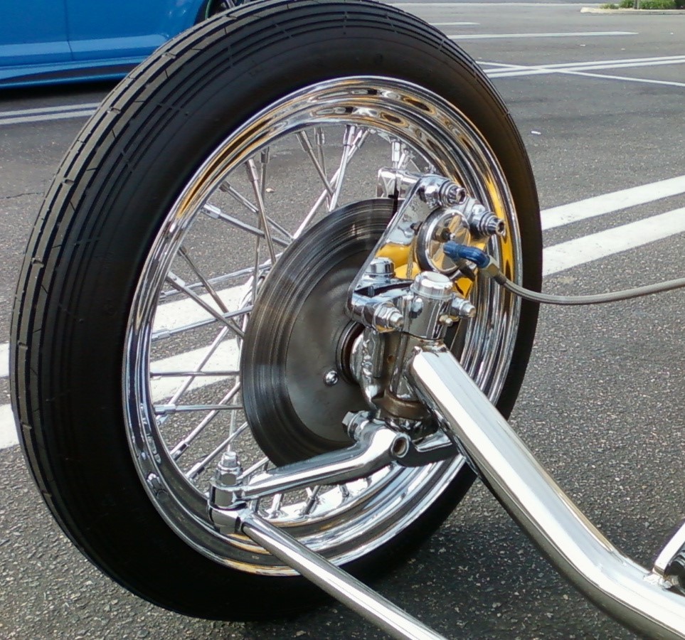

    This may not be your cup of tea, but this is the Total Performance set up and it will stop you on a dime with no problems. 1006121611b_resized_2.jpg 1006121613.jpg

    @Sky Six , you've mentioned enjoying your bucket and that you had no problems with the skinnies. Do you have any suggestions as to brakes, wheels and tires that are currently available to help others?

    I'll send you a PM in a bit.
