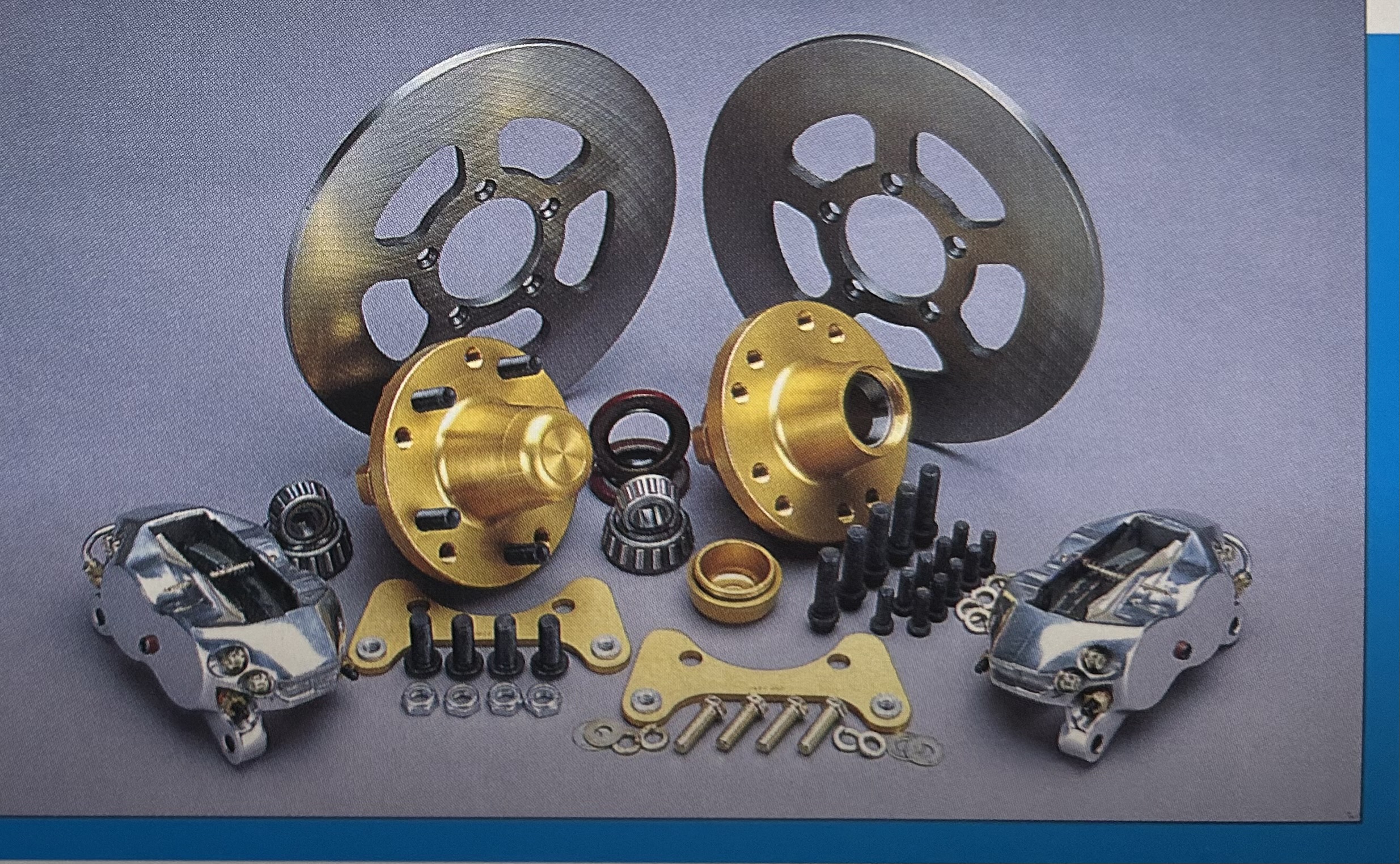

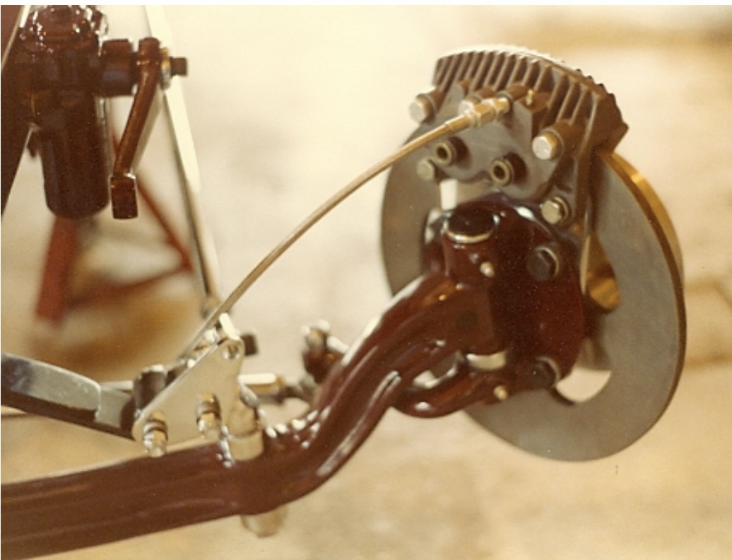

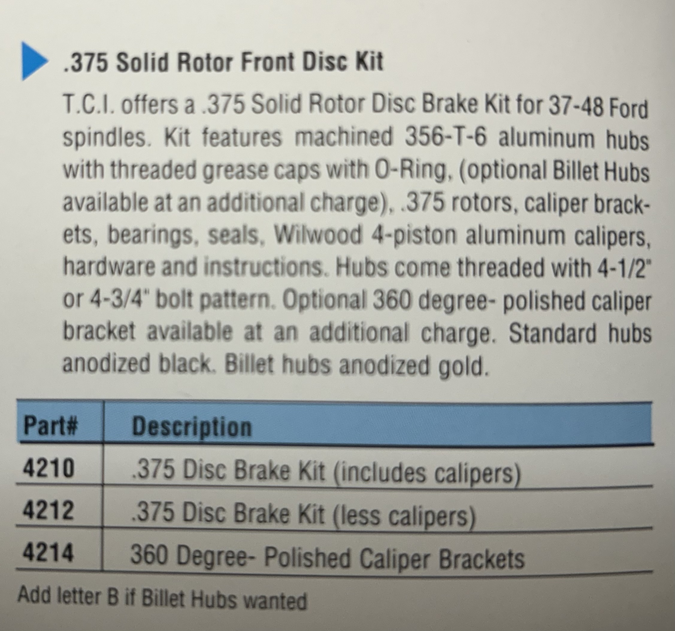

    I think @1biggun is looking to replace rotors like these, steel, .375, Blanchard ground. In the past PSI, Super Bell, Wilwood and others produced kits with rotors like these.
    I have this old PSI kit with Airhearts on my coupe.

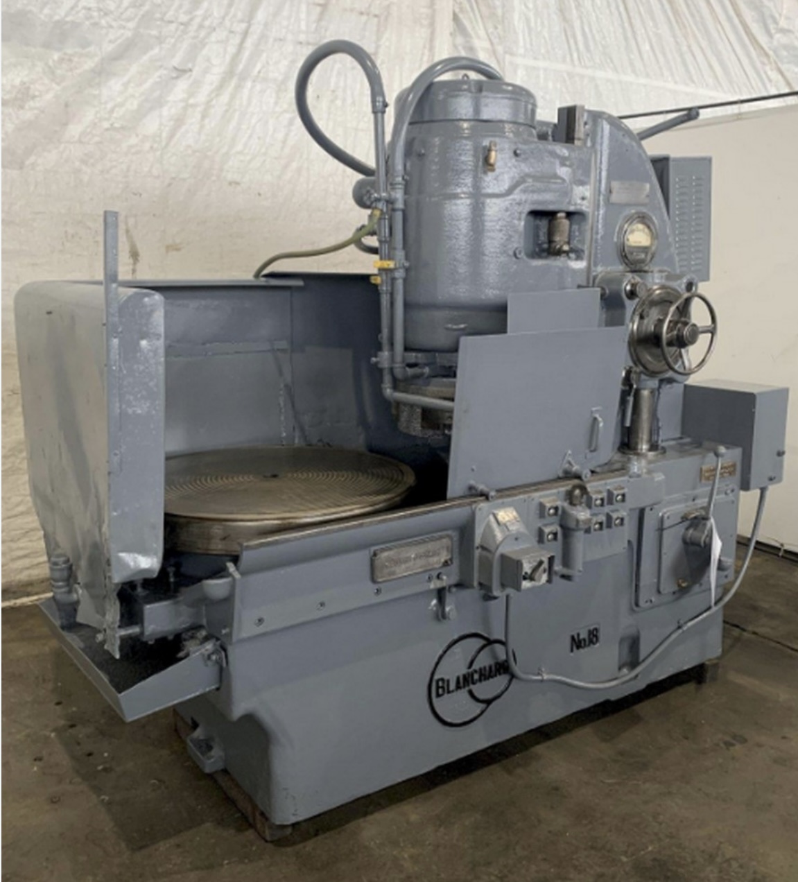

    What exactly is Blanchard grinding/ I have a lathe that will handle these but never seen a set up on how there ground .
  6. Fordors
    Joined: Sep 22, 2016
    Posts: 6,504
    Fordors
    IMG_2312.jpeg Depending on the size of the grinder (Blanchard is the name of the manufacturer) a Blanchard grinder has a rotating table that has a magnet that can be energized, the grinding wheel can be raised or lowered to accommodate parts of various heights. They are available with different size tables and wheel size. Non-magnetic parts can be blocked in place with any ferrous metals and also successfully ground. In the case of those rotors one side is ground and they are flipped to finish the other side to the desired thickness.
