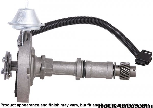

    I need a Cam Sync unit for my small block Buick build but no one makes one. I've seen where someone has cut the top off a Buick distributor housing and shaft. They then welded the housing of a Ford cam sensor to it and welded the cam sensor to the shaft. I've done some searching and MSD makes a SBC Cam Sync with an adjustable collet. I think I will have to swap out the drive gear (both shafts are .5" and maybe reposition it at the end of the shaft to get proper engagement). What I need to know is how much difference is there between a SBC distributor housing and a Buick small block. My Buick distributor is at a friends garage and they are currently away racing all this week so I can't go get it head to the junk yard and compair it to a SBC. Anyone have any dimentional data for the housing?

    are you looking for these two pictures? Or dimensions of....what part of it?

    This is the Cam Sync unit for a SBC.
