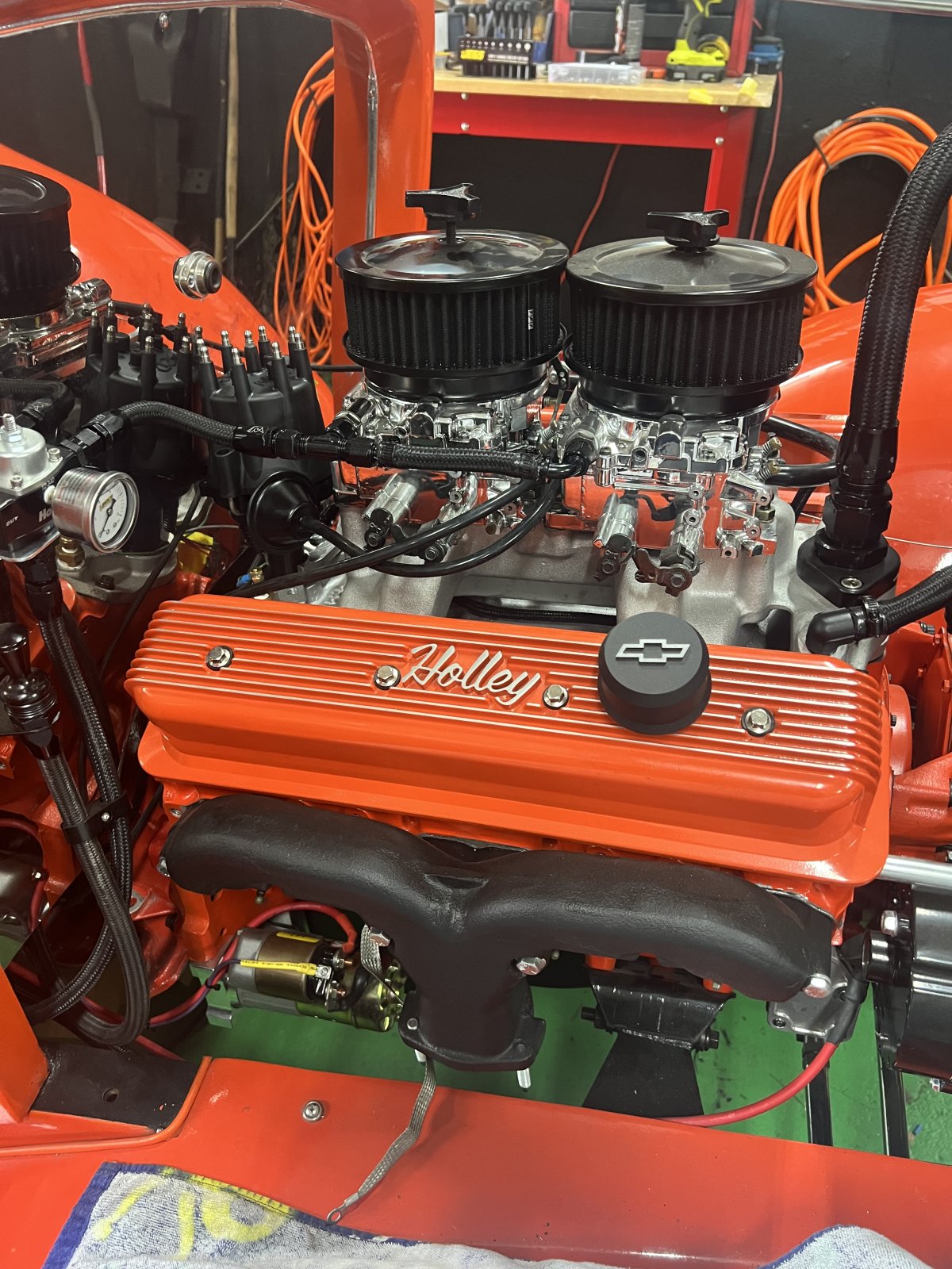

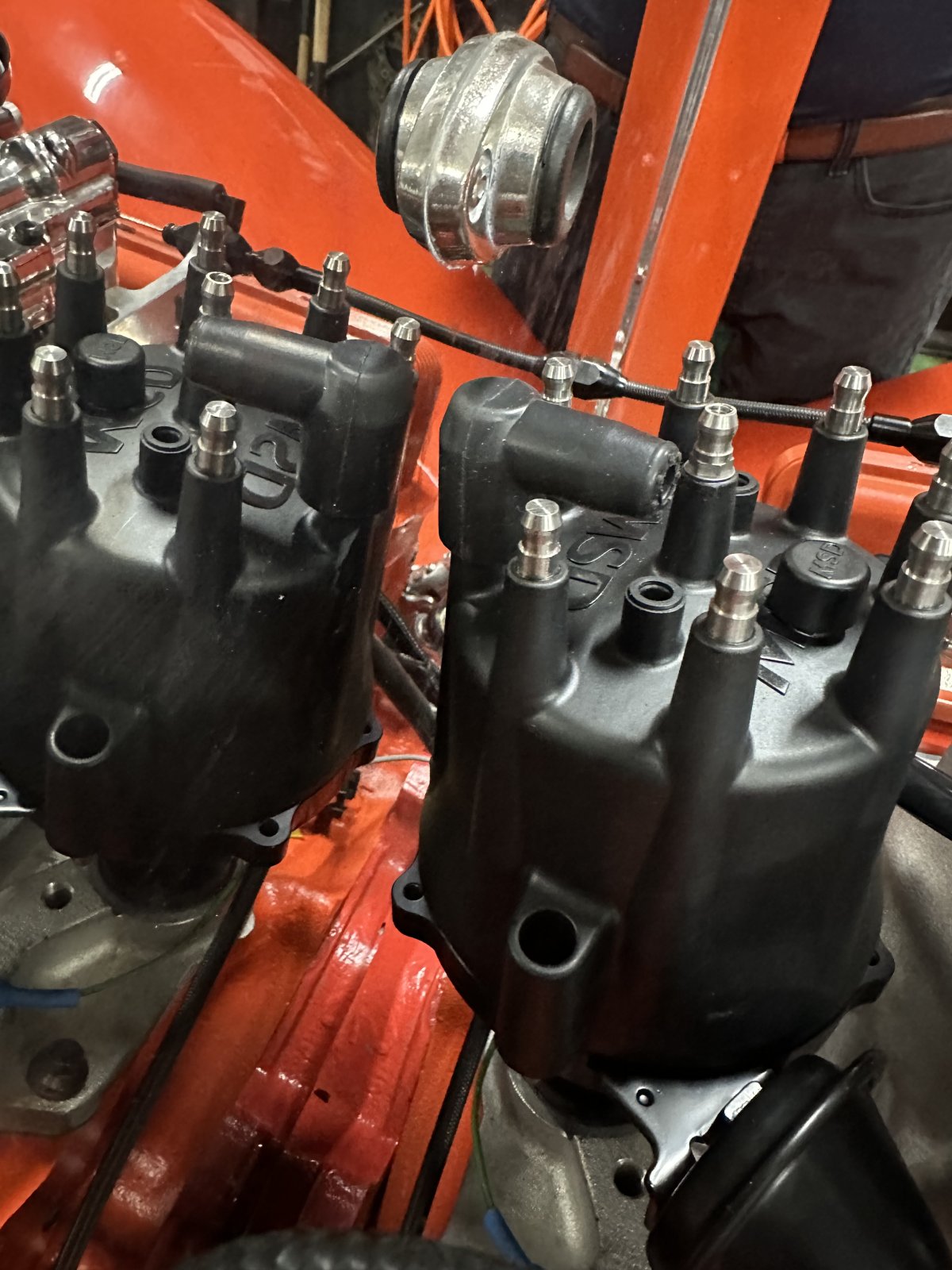

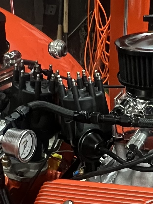

    32 ford westscot body polished stainless firewall, rebuilding and older build. So I finally got around to putting in the distributor this morning. Had to remove the oil sending unit because it sits on a spacer to clear the dual carb manifold. No big deal just a new spacer that mounts the sending unit at 45* clearing the distributor. Everything just fits the MSD ready to run slipped right into place. We put the cap on and only have a quarter inch clearance the spark plug boot hits the firewall.
    My question, the original SBC was using solid motor mounts. I used rubber motor mounts.
    Are solid motor mount lower? would rubber motor mounts change the position of the motor? I only need about 1/2 for a little more clearance. Any help is greatly appreciated.

    It could just be your pic but your dissy looks like it’s leant back in relation to the engine.
    wicked AF likes this.

    I’m going to change the position of the trans mount I think it will level out a bit giving me the clearance needed. The cap wasn’t locked down in that picture just siting on top of the distributor maybe why it looks off.

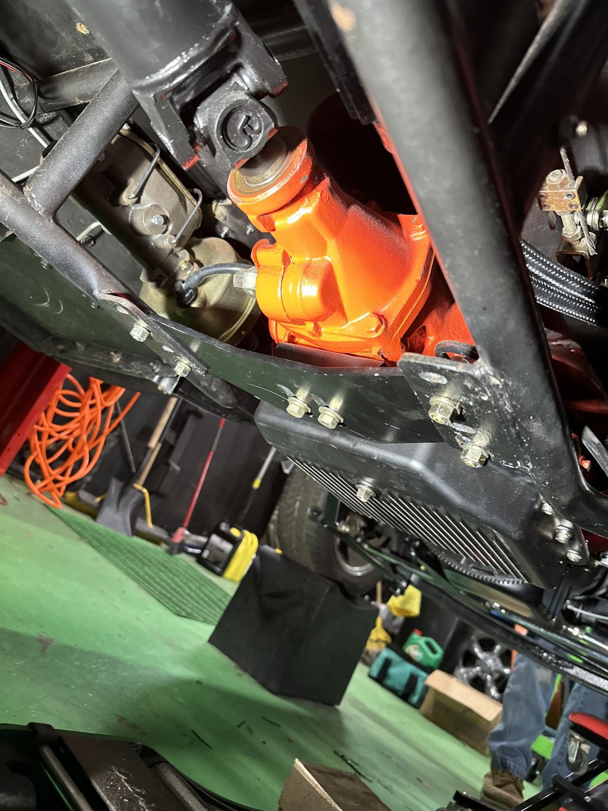

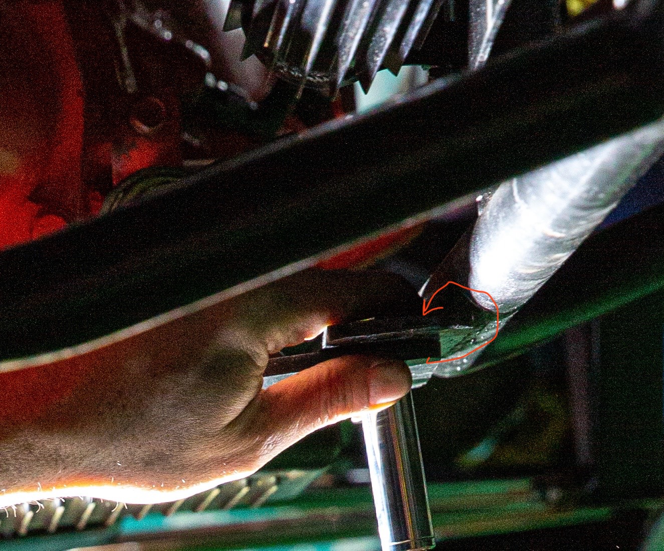

    It’s a Pete and Jake’s frame. The transmission is mounted to a plate that bolts to the frame. We bolted it up from the bottom up to the frame. I’m going to flip mount so it’s getting bolted down to the frame which should give me the space I need. Thanks for the suggestion!

    Hey wicked, before you ‘flip’ the crossmember to the top of the frame mounts you may want to just check your angles and consider what raising the trans rear up 3/4” will do. No doubt that will give you the firewall clearance, but keeping your drive line angles ‘semi-correct’ is important too. That and putting the trans crossmember mount on top of the frame mounts might add some new challenges.
    I’ve gone through this a few times and suggest you start with a 1/4” spacer (floor jack the trans up and slide anything a 1/4” thick in and see what it does). Then something 3/8”, etc, etc. jumping straight to a 3/4” rise might be a bit much and you’ll just end up going backwards (like I do, hahaha).
    Just food for thought and trying to save you some time.

    Thank you, great suggestion, if I remember correctly it was mounted on top when I took it all apart. I may fix any angles that may be off. The original builder of the car drove it every without issue. He has p***ed on and I was lucky enough to by a well built car, he had it all sorted. I have a degree wheel can check all once it shimmed / moved to ensure it’s correct.

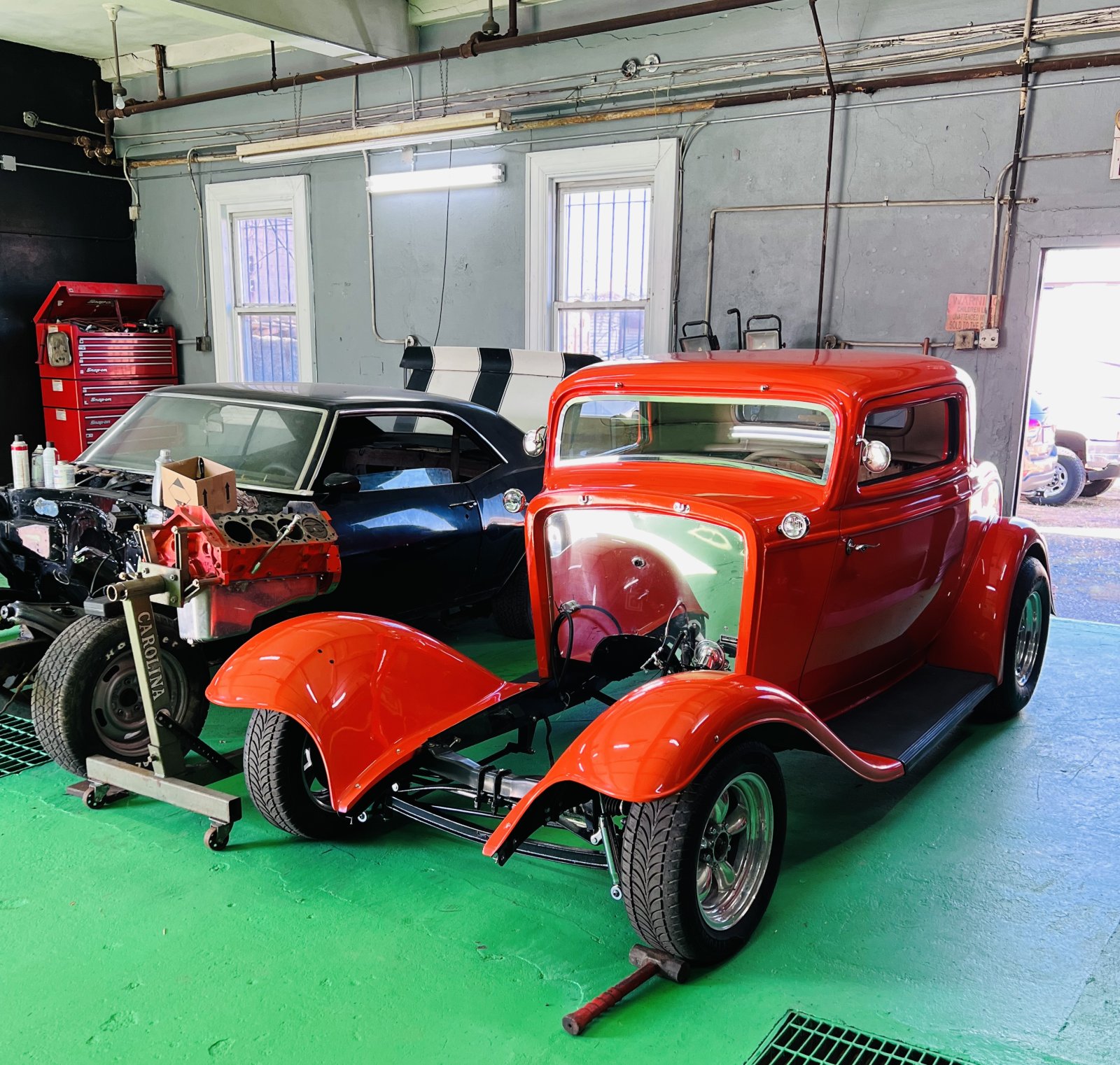

    Before we put the motor in.

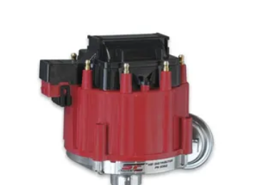

  22. 19Eddy30
    Joined: Mar 27, 2011
    Posts: 4,423
    19Eddy30
    from VA
    yes there is different height sbc solid mounts ,,, all so there is 3 different height rubber sbc motor mount ,
    Between 60 ish somting-70 ,
    MSD makes a smaller diameter distributor than the one shown

    The engine will be ***led forward if I shim Tran mount moving the distributor forward a bit away from the fire wall. All I want is a .25 or .50” of clearance and I’ll be good. The MSD image on the bottom is exactly what I have a ready to run. It just has a black cap.

    I just wanted to thank everyone for their suggestions. I’m happy to report flipping the trans mount plate from the bottom to the top of mount gave the distributor the clearance needed to clear the fire wall. The hot rod community is truly the best. Thanks Again to all.
