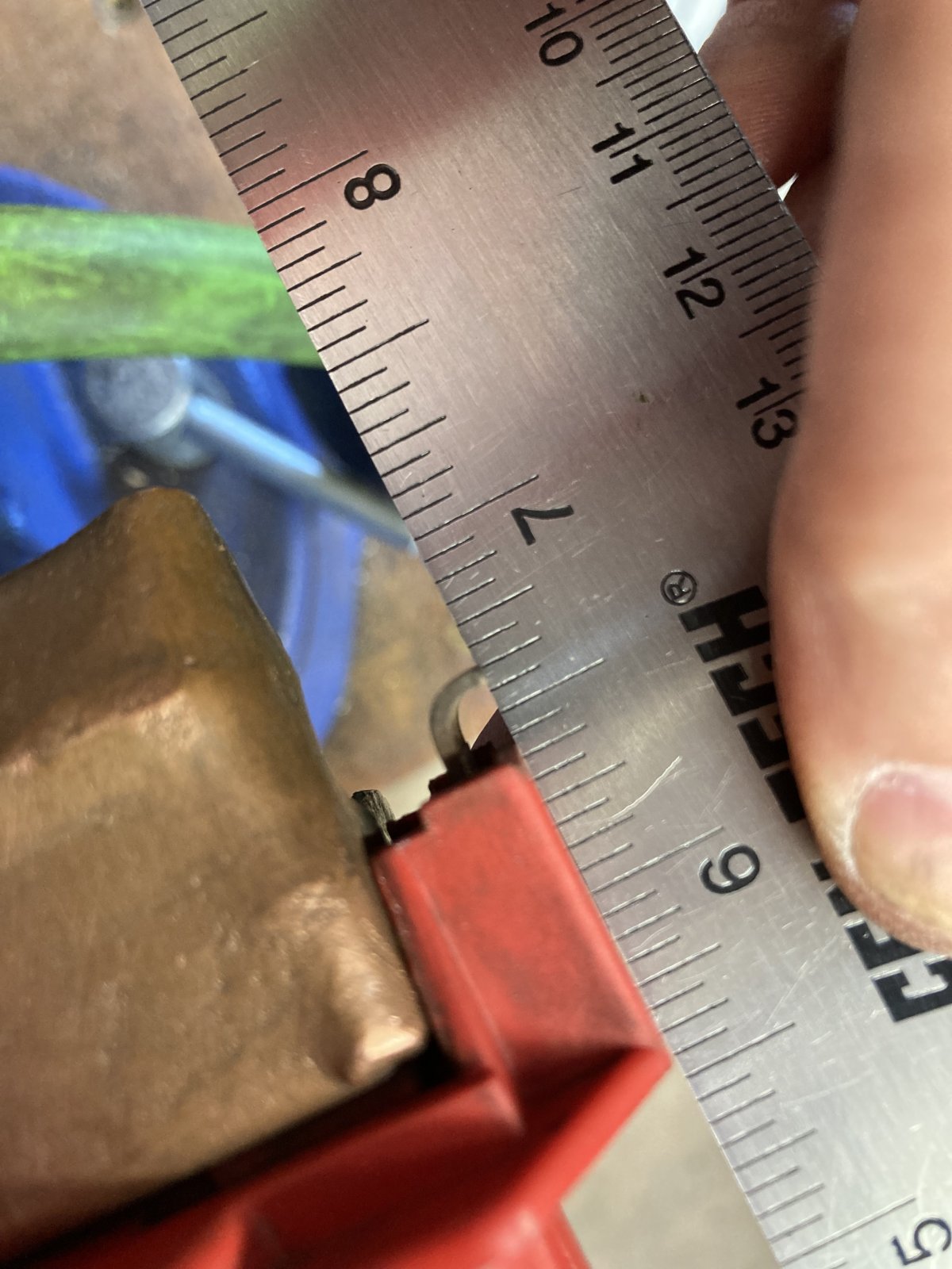

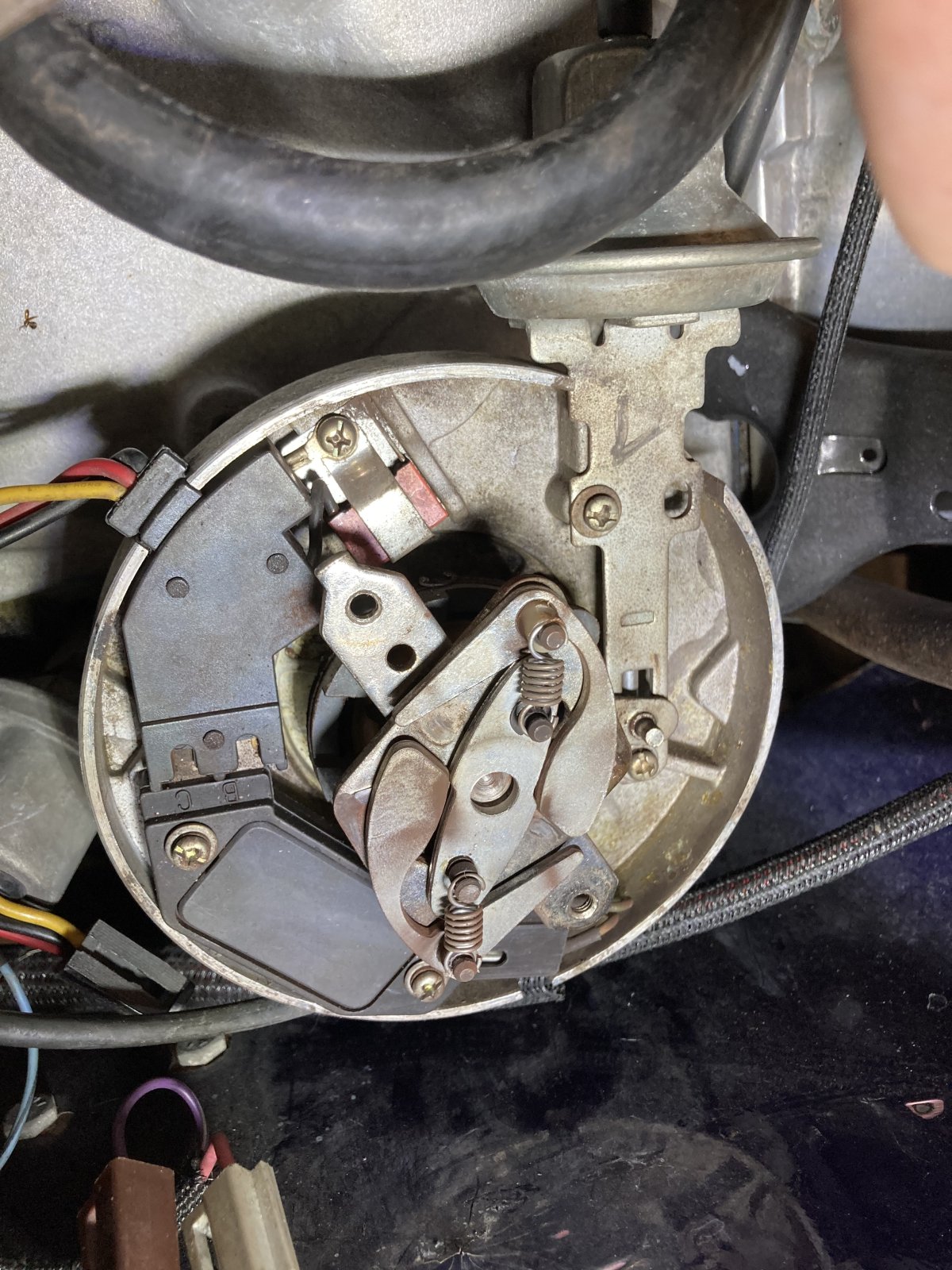

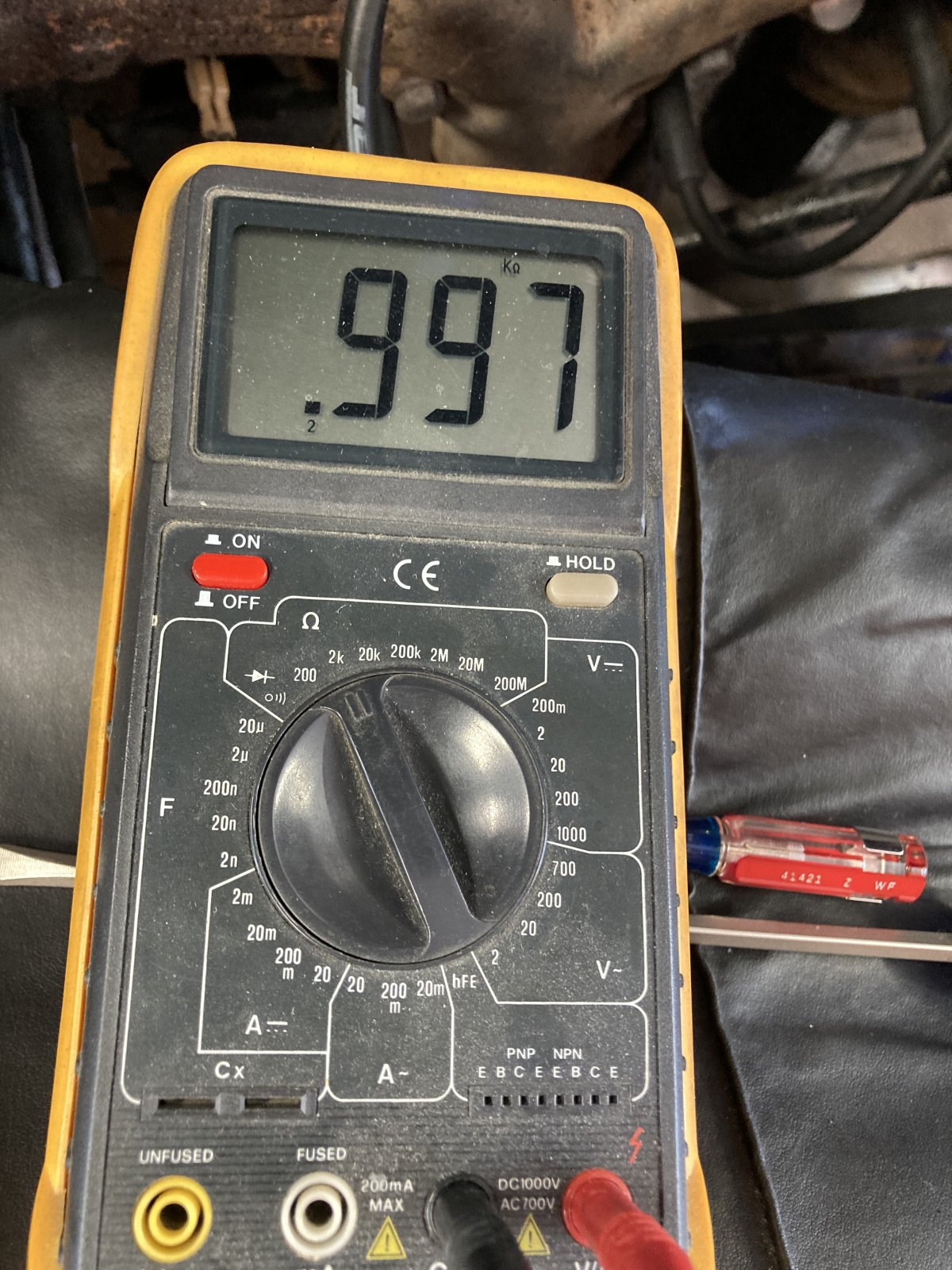

    So it’s “medical stuff for wife” week here, but between appointments and tests and stuff, I got some garage time in yesterday. I don’t have a definite smoking gun to report. Because pictures help illustrate…
    Plugs are R45TS at .045 gap. This is #1, and it looks good to me other than having picked up some gunk because I dropped it getting it out.
    Cap inside, terminals show some wear, but seem ok.

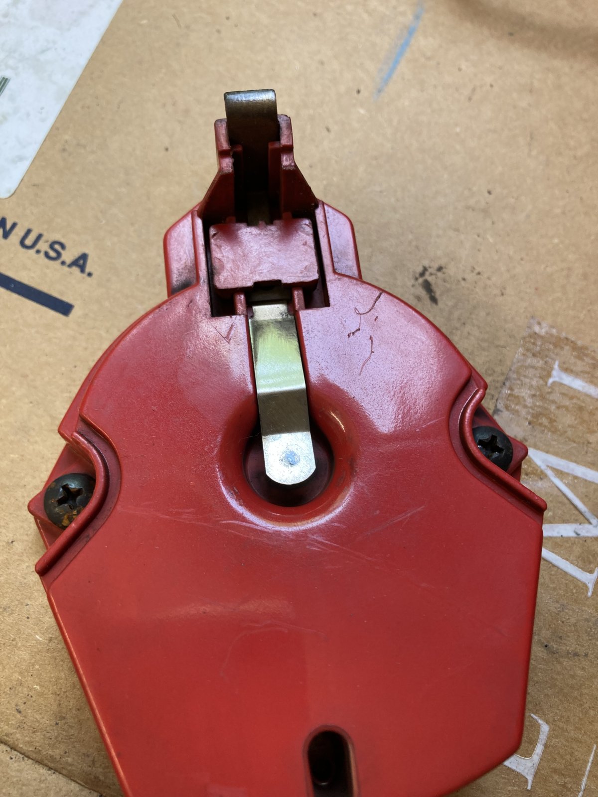

    Rotor doesn’t show arcing to ground through the distributor body. Back side of the centre contact is clean.
    No signs of arcing on the advance weights.

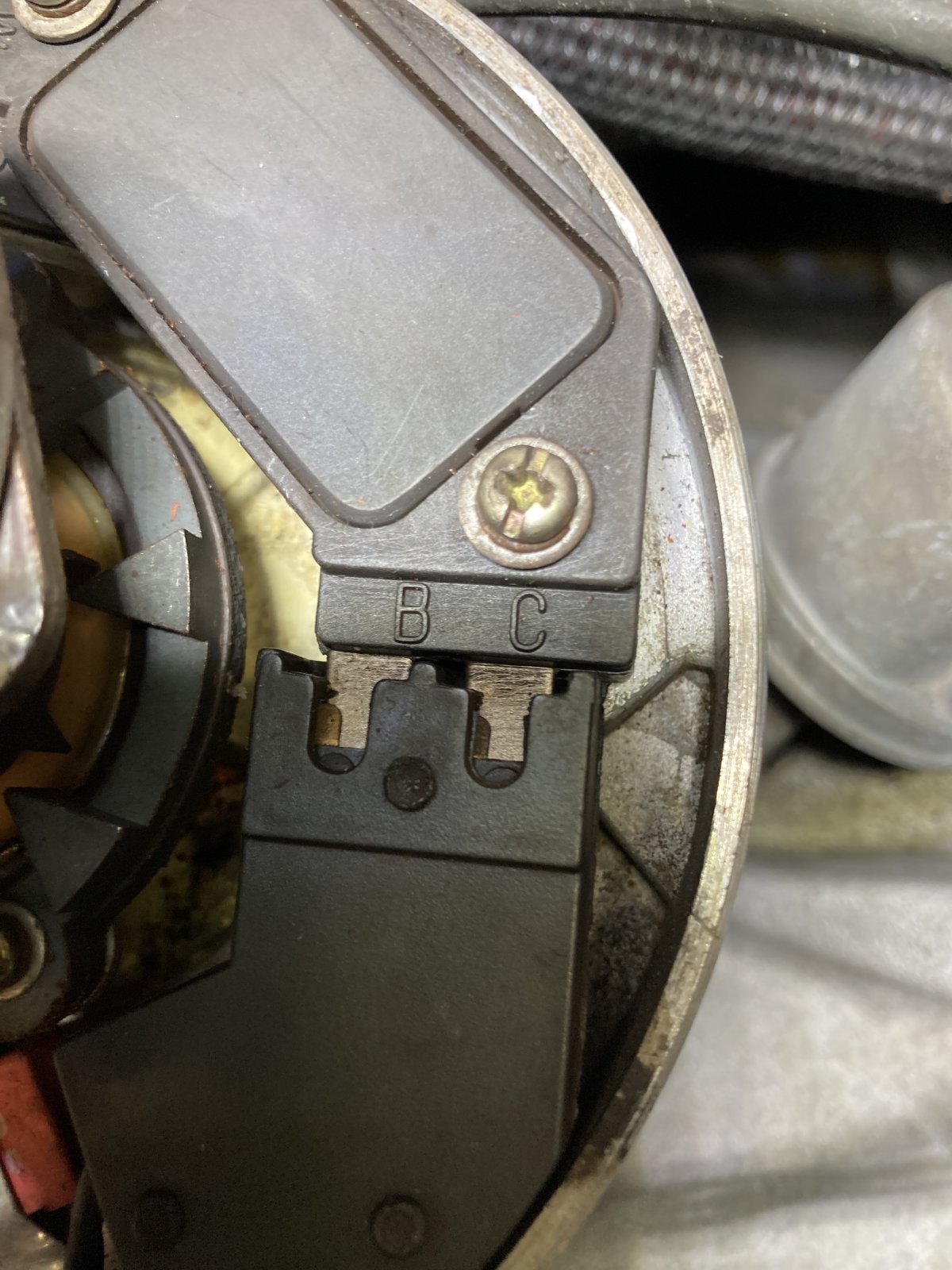

    I removed the module and the three wire harness piece to get access to the pickup coil connector. Meter on connector, got 997 ohms. Specs I found online say that 500 to 1500 ohms is correct, so being right in the middle seems good. Pulling on the wires (gently), they do not feel stretchy or broken. Moving the connector around to the limits of where it will go, the meter never moved off of 997 ohms. I think it’s safe to say that I don’t have a broken wire at the pickup coil.
    Removing the module, this B/C connection to the harness seemed not tight. I used a pick to increase the tension on the female connectors. These are low voltage, but I don’t like “not tight” in connectors. Cause? Probably not, but it’s a thing I didn’t like.

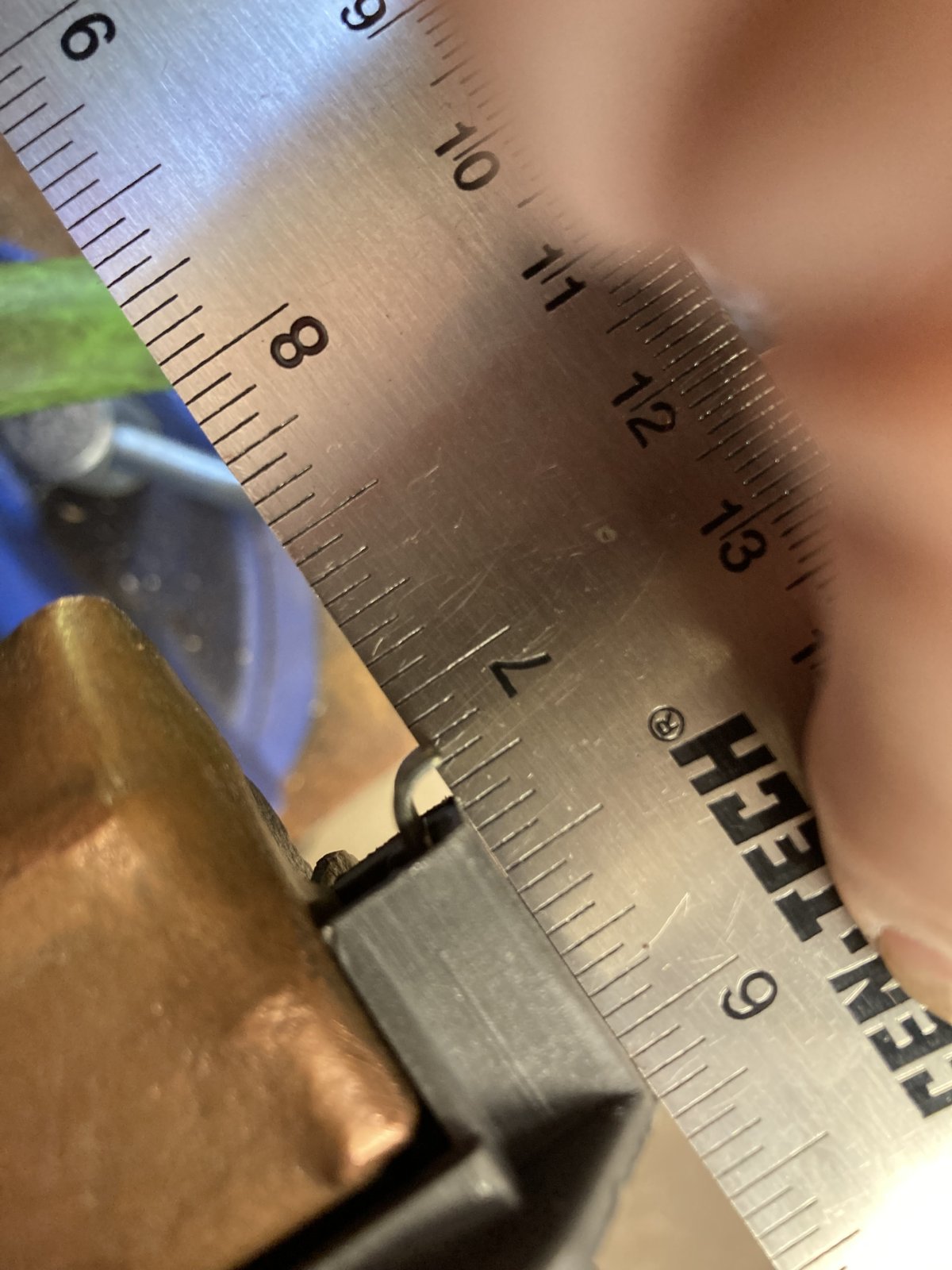

    Comparing the old rotor to a new one, I found something else I don’t like. The tip of the old rotor is about 1/32” shorter than the tip on the new one.
    Not easy to get this in pictures, but the old one, the tip is basically in line with the plastic body of the rotor. Here, with a ruler:
    On a new rotor from NAPA, the tip is proud of the rotor body by about 1/32”:
    I didn’t get an exact measurement, and it probably doesn’t matter if it’s exactly 1/32” anyway. ***uming that the rotor to cap terminal spec is X fractions of an inch, X + 1/32” is probably not helpful. Unknown age on the rotor and cap, so “worn parts” here.
    The cap is a crossfire style, so I’m going to order a replacement cap and rotor. Might parts canon the coil, module, and pickup coil while I’m at it.

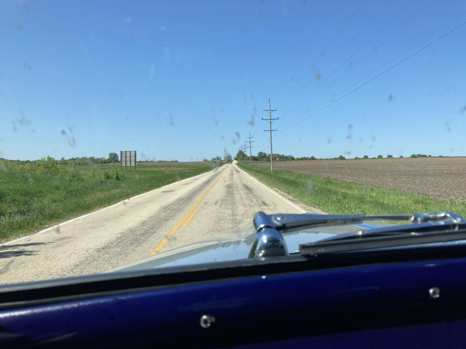

    Also, if you’re not from the midwest, “hill” is any change in elevation. There is a hill ahead here:
    It’s not like a “hill” in Pittsburgh.
