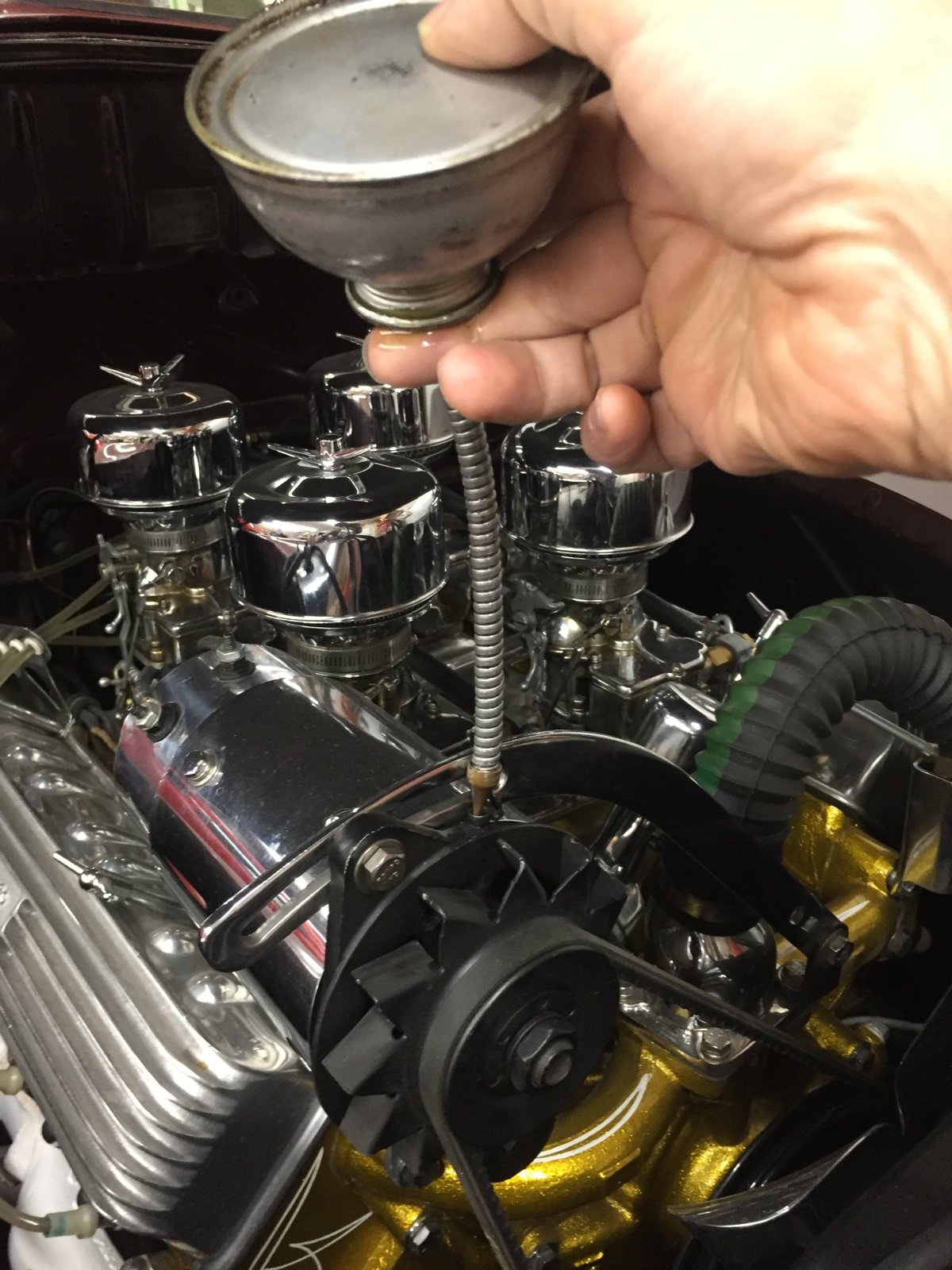

    Yup get out your oil can

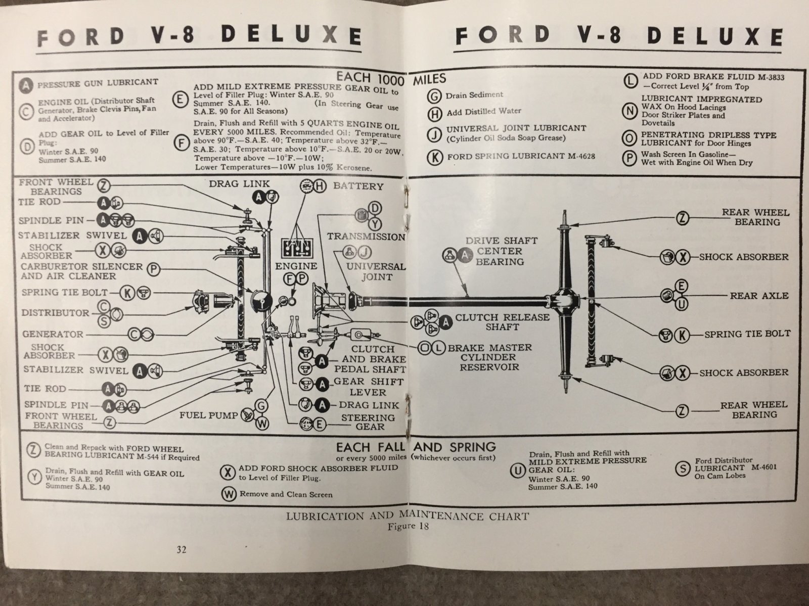

    According to my 1940 Ford reference book, oil pots get lubed every 1000 miles

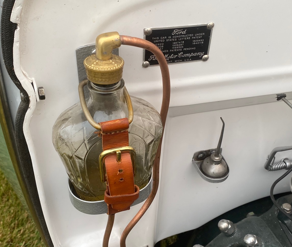

    @Kim Strobeck put an 8BA in his 31. He is running a distributor with the oil cap on it. He built a little mount and attached it to the firewall for a small oil can, just for that purpose. He added a rare earth magnet in the mount to secure the can. Clever and handy.
    I am also drawn to his recovery tank for some reason. :cool:

  19. :cool::cool:
    Looks like an old Crown Royal bottle. :cool:
    Bandit Billy and VANDENPLAS like this.
