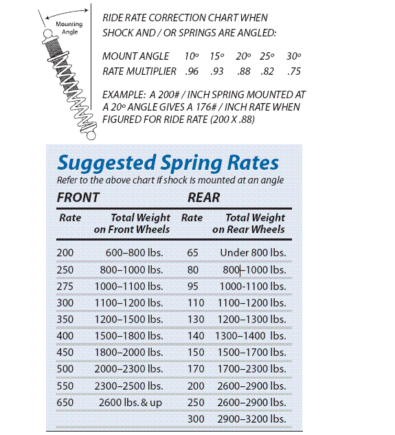

    Set the truck at ride height and measure the distance between top and bottom bottom mounts, that is the compressed distance of the coil overs you require bearing in mind that at ride height, they need to be approximately 1/3 compressed to allow for compression and extension whilst driving.. Next you need to factor in weights front and rear to determine what rate springs you require.

    This is Air Ride set up as well.
