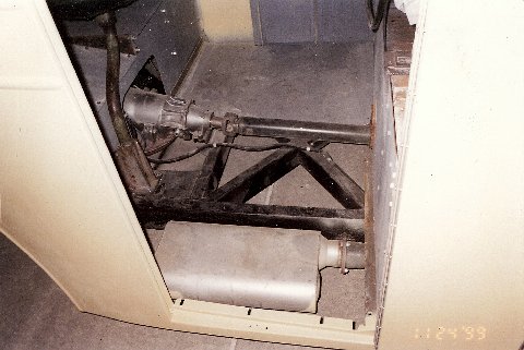

  19. If I may ask what is wrong with the frame on the truck now ?
    My 48 Divco I retained the complete frame. I did box it in one end to the other, added an x in the mid point of the frame. Still have the stock springs, minus 5 or 6 leafs a side. Used a 9 inch ford. Added a set of shocks, since they did not have any on the rear.
    When the factory frame is not retained, you almost always need to channel the body over the frame. Doing that you end up with a very high floor.
    I can sent you pictures, of the rework of my frame.
    The factory is bolted to the frame. The body's are bolted together on the very early trucks. This being said, if your frame is not reinforced, **** going to move later on.
    Look at post # 76 for more frame pictures.
    Bob
