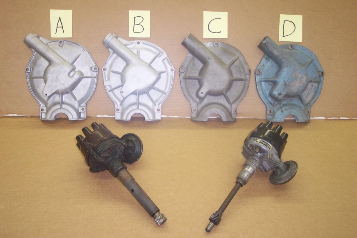

    EDIT: There are 2 different 8BA timing covers one has an additional nub cast into it and acts as a bushing for the lower end of the distributor shaft. Probably best to get the right flathead distributor to match your timing cover as a first point. Then you know you are matching the chev distributor to match the timing cover you will be using

    acme30, I'll have to see if I have the Tex Smith book. I've got a couple older ones. I am aware of the timing cover differences. I believe ford made aluminum and cast iron versions of both, and then they made them all with truck or car timing pointers which makes them 2 vs 4 degrees initial. gets really important to setup your motor on a stand and mark out tdc on your pulley when you are combining a flatmotor from a pile of parts!! I have the aluminum cover with the support on my roadster and this motor has the cast iron one without it. I'd much rather get another one with the support if i can find a deal on it. I just ran out to my garage this am and looked but didn't see a stocker in my pile of junk.... have to look a little harder when I get home.

    All 8BA/8RT front covers have the timing pointer at 2 degrees BTDC. The larger diameter wide-belt sheet metal crank pulleys ('48-'53 truck/'49 Ford-Merc cars) use covers with the pointer positioned higher than the cast iron smaller diameter '50-'53 narrow-belt pulleys. Alloy covers A and B allow the pointer to be placed high or low.
    There are also two styles of late distributors; full-bodied cast iron (used with iron and alloy covers) and short-bodied alloy with the extended shaft, used only with the alloy front cover with the lower support.

    This sounds like the best way to do it to me. I would, however, pay attention to "V8 Bob" in post #8 about proper front covers.
