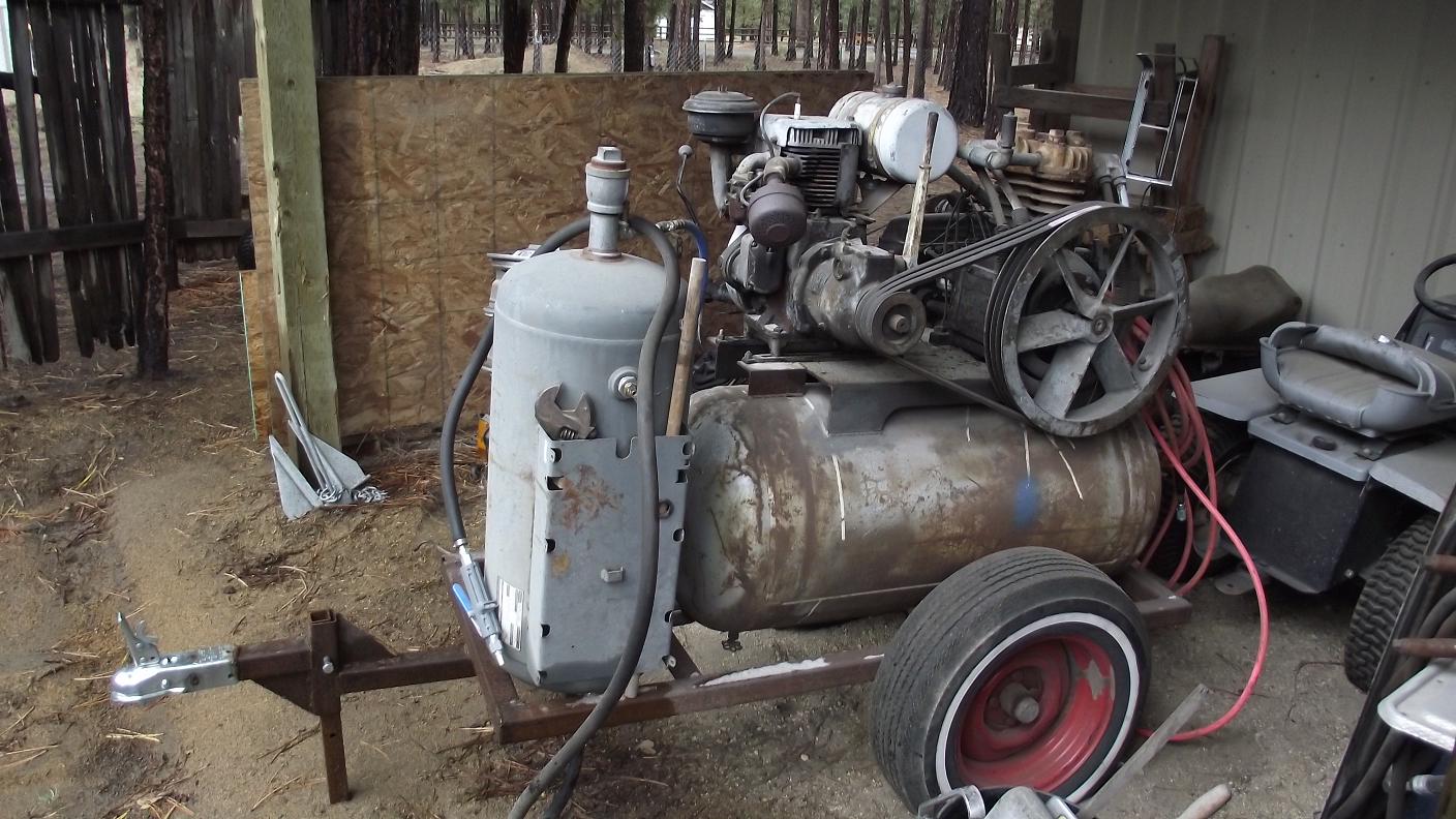

    I use a HF 90lb pressure blaster. My air source is an I/R 80gal 5hp single stage that puts out 18 cfm. I use a water trap a couple of feet upstream of the compressor then run the hose to the backyard which connects to another water trap which connects to this...........
    then a short hose to the water trap built onto the blaster. The I/R provides plenty of air and with the above filtration system, the air is bone dry.
    I setup a 10' square blasting area behind my toolshed. Bisquene stapled to 1-1/2" strapping which is attached to the fence and toolshed. A HF blue tarp on the ground to collect the sand. I scoop it up with a dustpan and strain it through a cheap WalMart strainer. It works great however, if you plan to do a complete car body........take everyones advice and farm it out. My setup would take forever to do an entire car! It's good for large suspension pieces and such.
    I also have a cheap HF blast cabinet but I've been thinking about stepping up to a barrel blaster for the smaller stuff.
