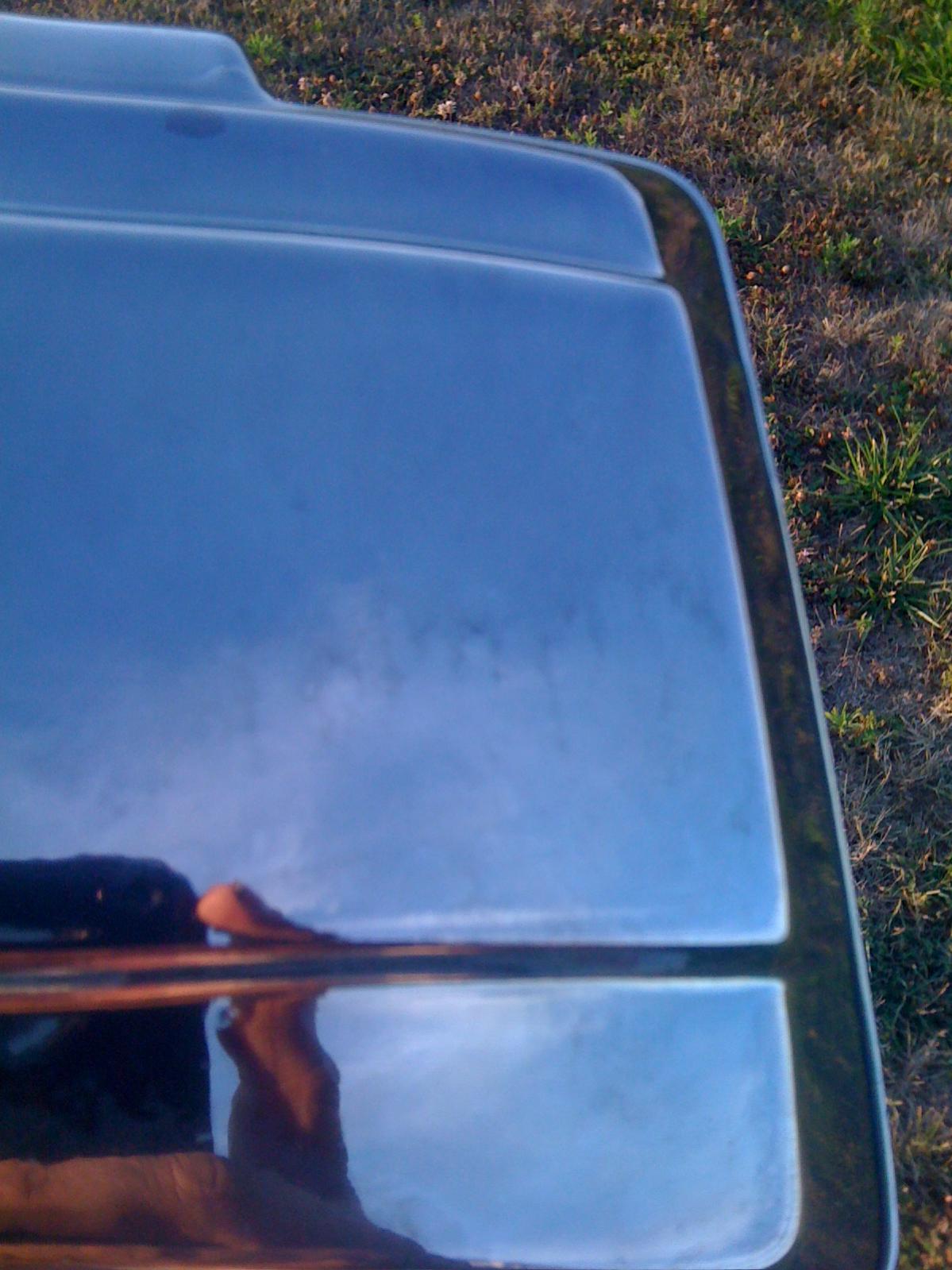

    I cleared it with my violet tint then regular clear it intensified the bad areas that I knew were there can you help me with the cause of these imperfections? I am ***uming sensitizer issues
    pic 1 shows them all the worst is the 2nd picture the staining looks kind of like drips maybe didnt get the sensitizer rinsed well enough??? im not sure ant help is greatly appreciated

    I from time to time have this problem also, whe there is a hole in the piece it will turn darker around, this is caused by not enough sensitizer and rinsing around those areas. rinse the piece very well and blow dry it very well also because if the piece has some quemical left and is driping and you are not aware of it it will cause issues too
