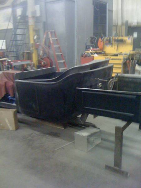

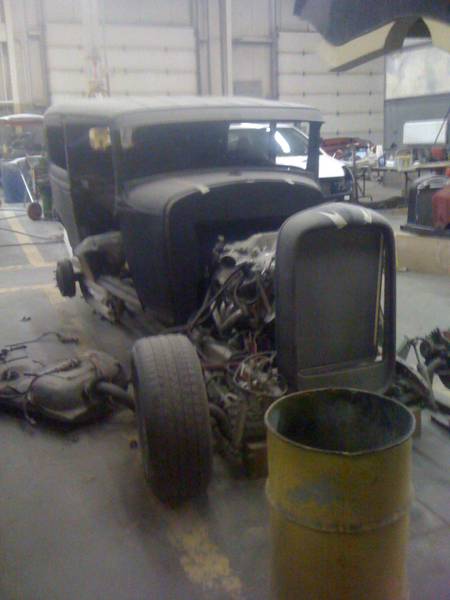

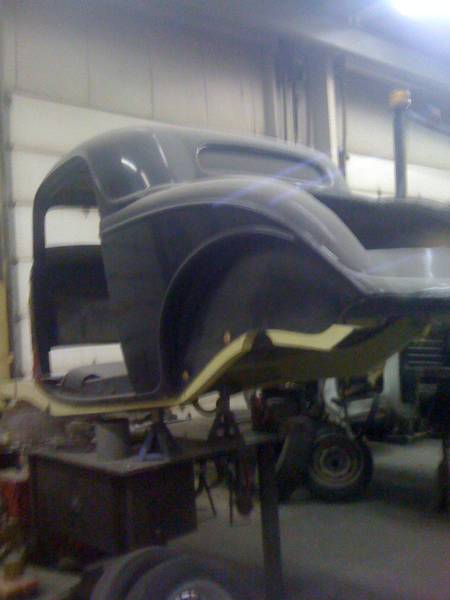

    Just a couple projects we are working on

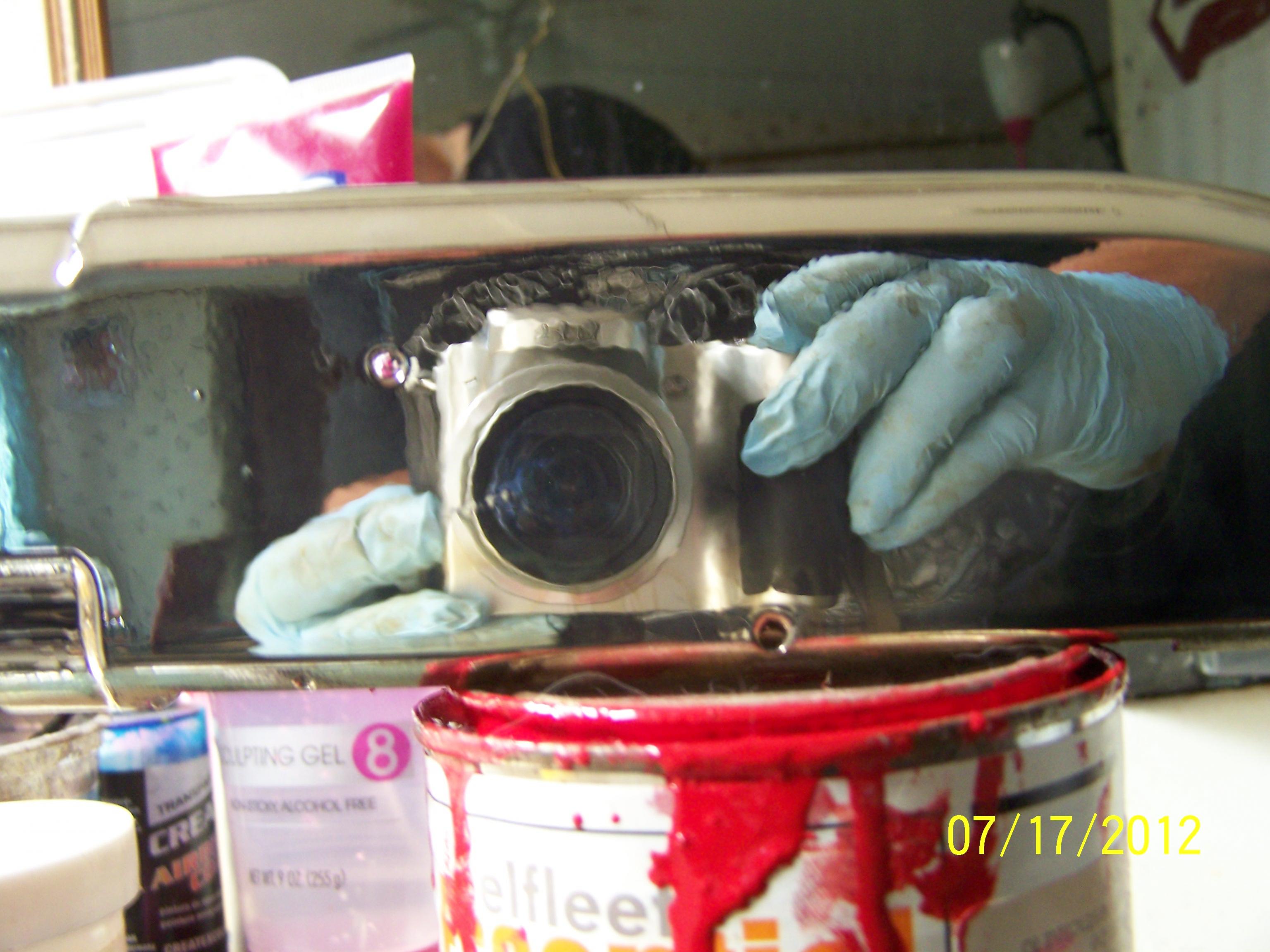

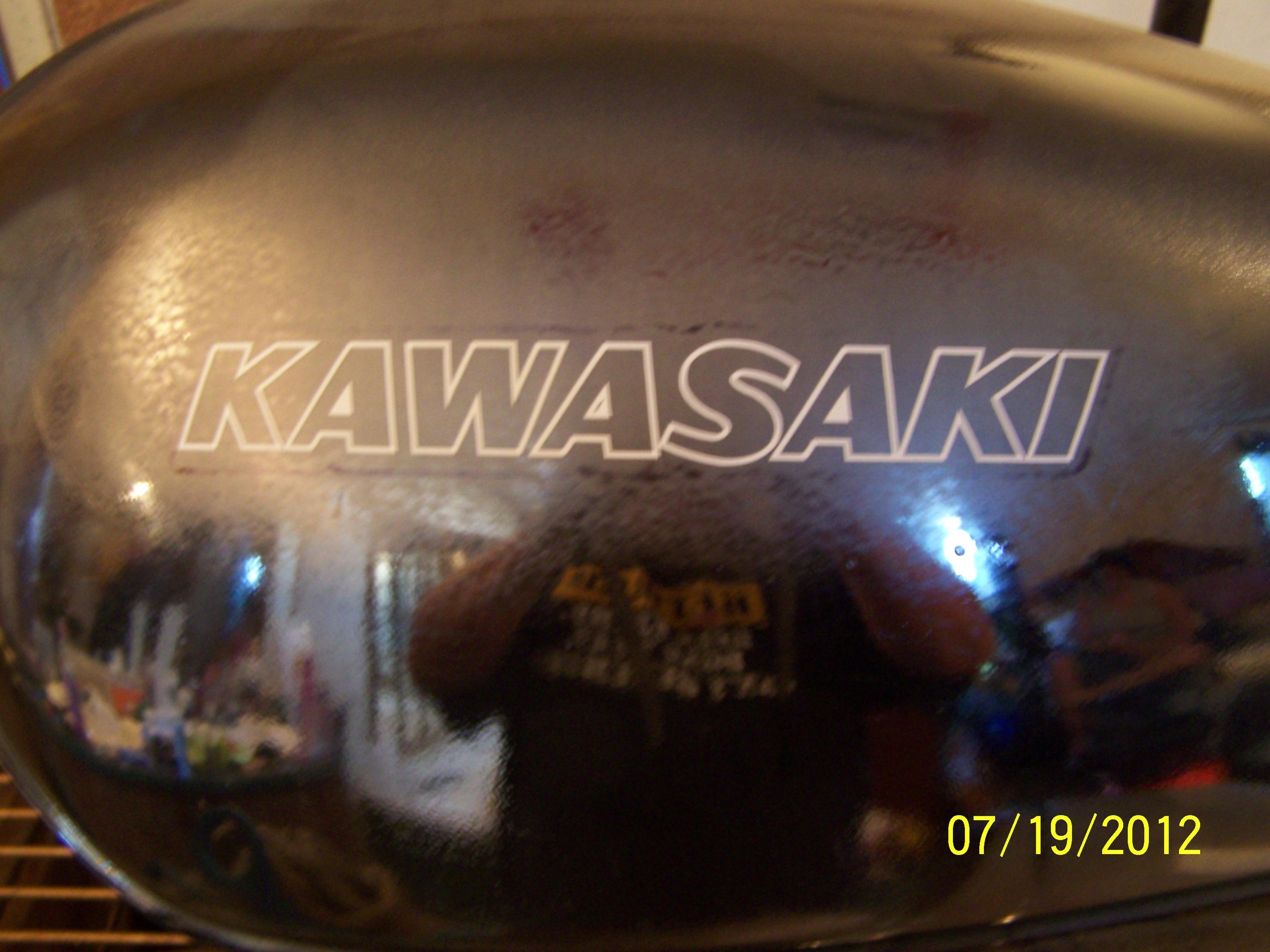

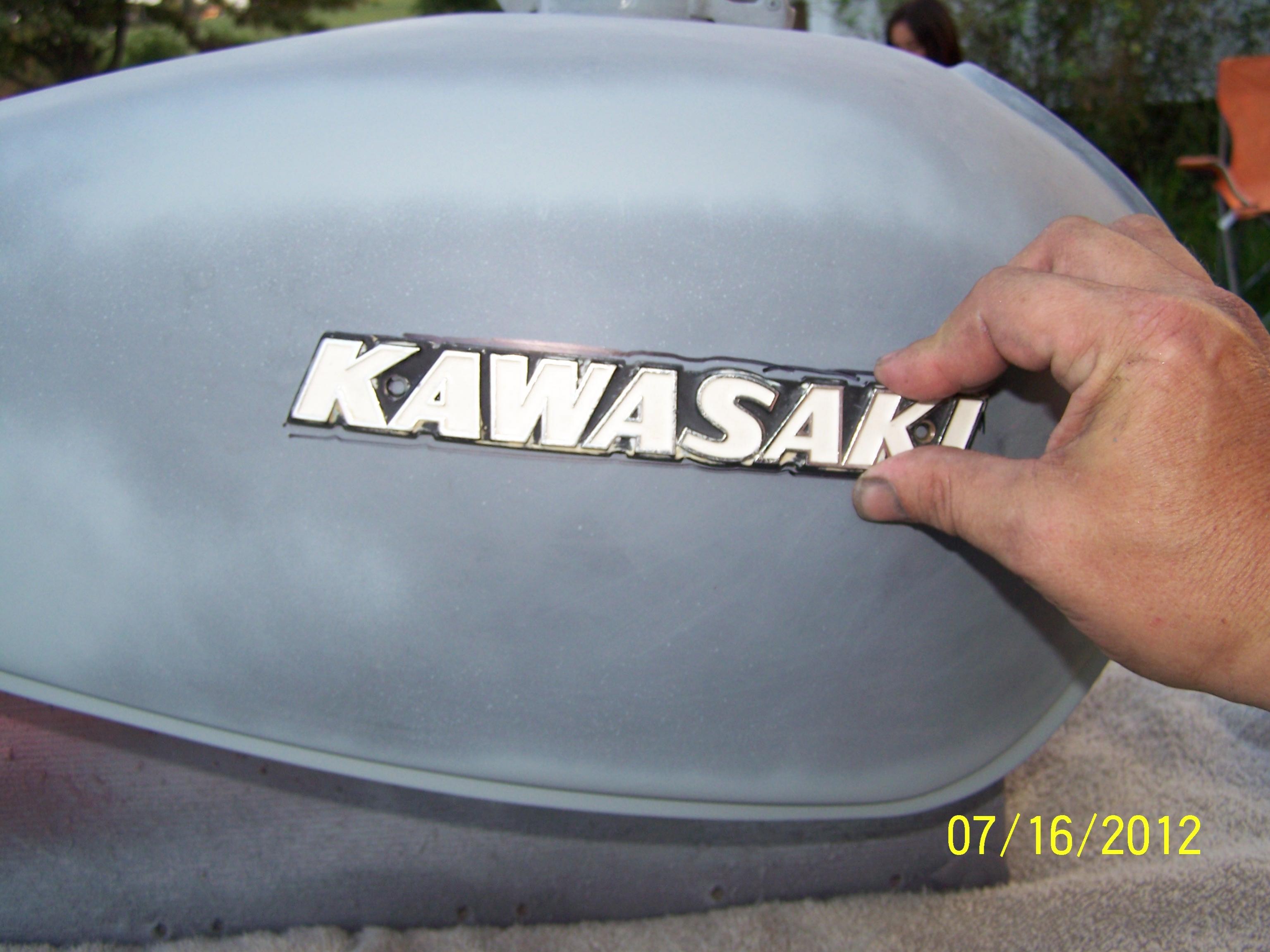

    hey nic got a new sprayer and have had some great results gonna upload a couple projects I have done photography ****s but you get the idea
    wanting to replicate the emblem in
    i had to chome the area for the emblem
    then scuff th the area and mask off what will remain chrome
    the rest will be sanded and painted
    then the additional details of the emblem will be painted in before it
    receives several coats of clear
    I dont know how it will turn out at this point but
    I couldnt have even tried it without you nic

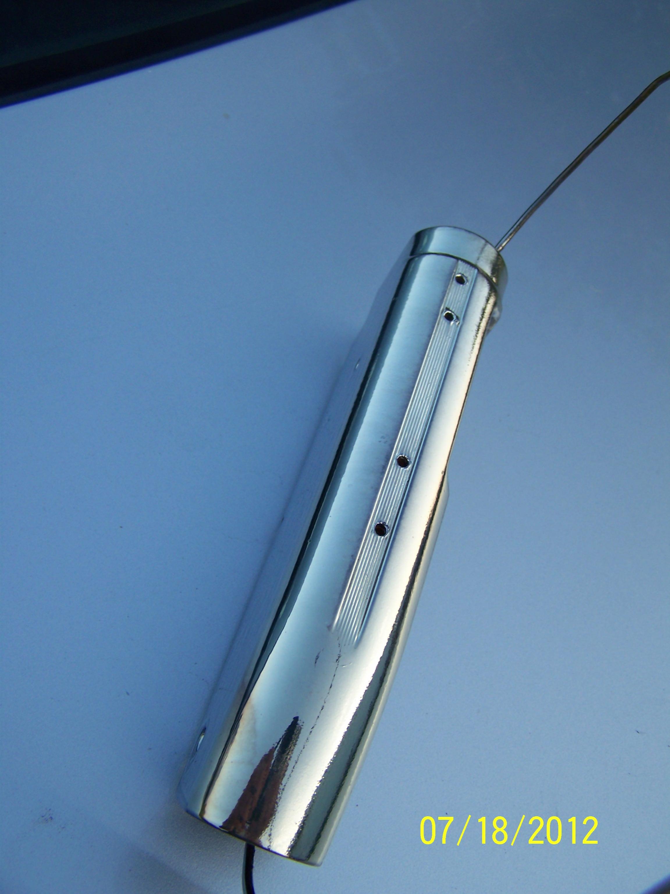

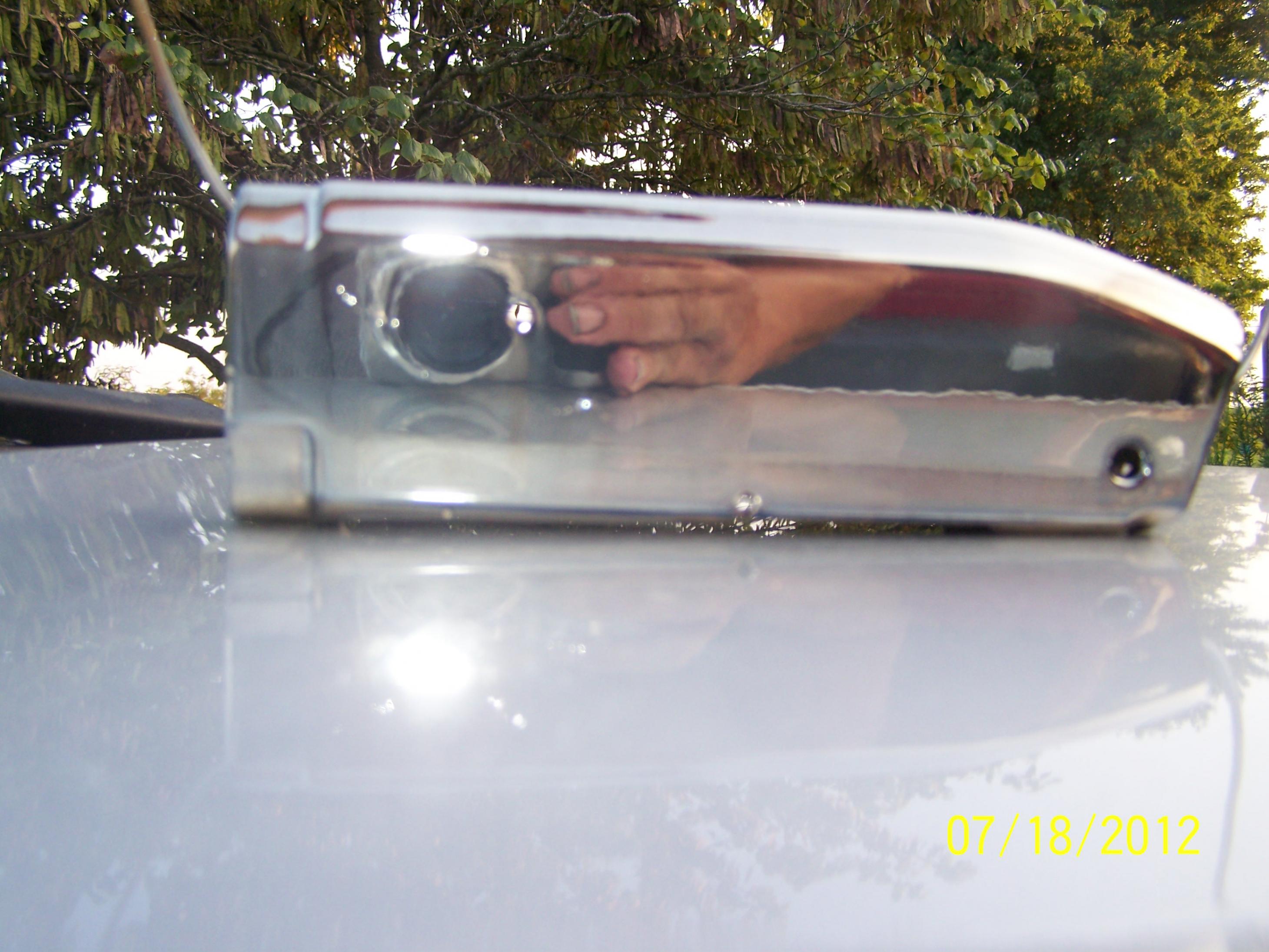

    on my research for Hexevalent Chromium alternatives that includes, the best chrome paint on the market(Alsa and Innate Chrome), chrome like ceramic coating(Cerakote Chromex) Spray On Chrome(Alsa ChromeFx and my own built one using Angel Gilding Silvering chemicas) and last but not least Caswell plating Copy Chrome, I would say the Copy Chrome(nickel/tungsten alloy) is a good candidate for a real chrome replacement on metal parts, and spray on chrome for plastic parts, Cerakote Chromex also has a good shine but takes a lot of prep work to make it shine, Chrome Paint is not really a good alternative but its way better than silver paint, Alsa Stretch chrome has a very good shine but its very hard to get it around round objects..
    here some pics and videos...

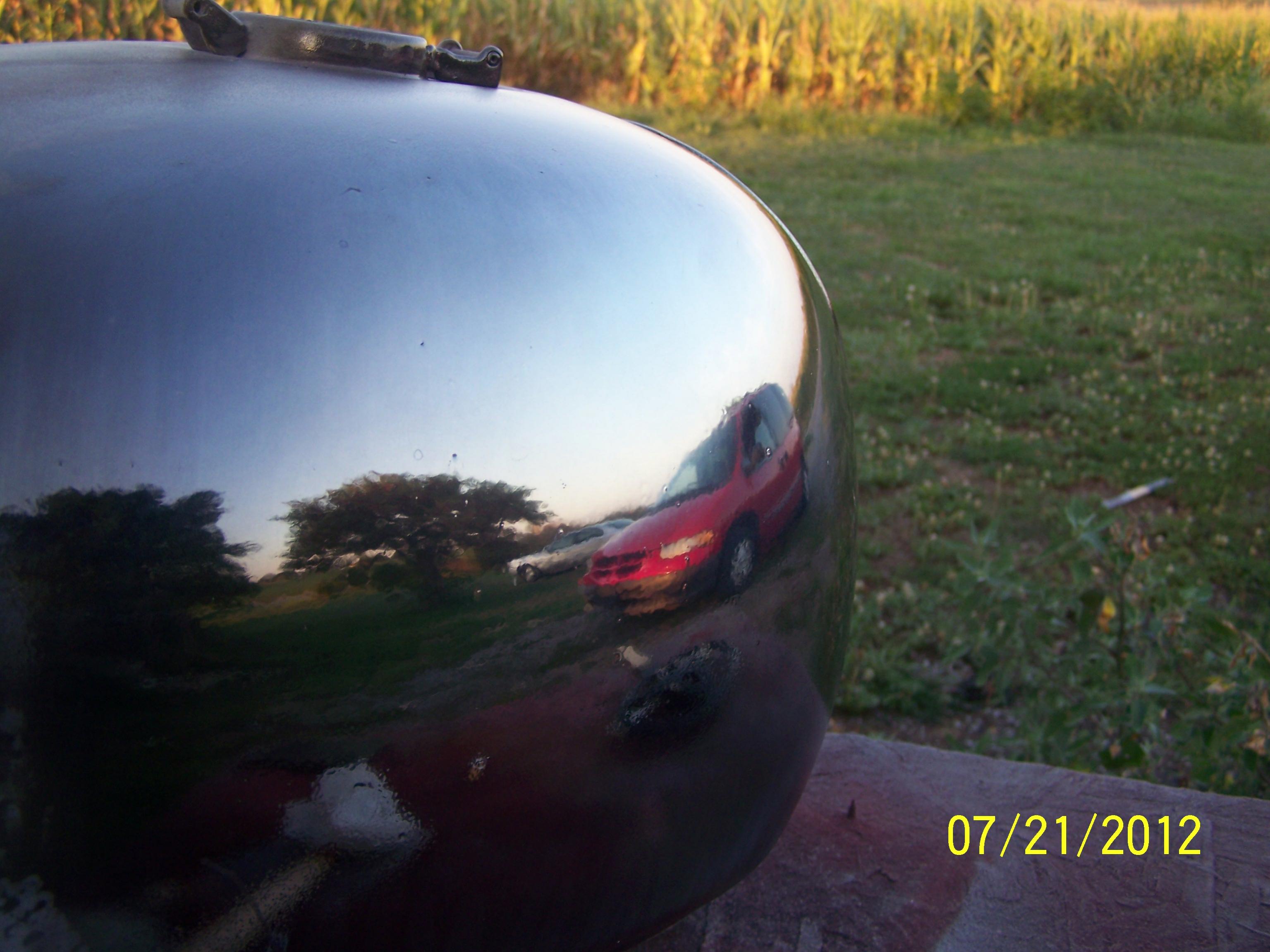

    do guys want to know how can you tell if your tin(sensitizer) is going bad?
    first. it takes longer to see a mirror
    second. it does not look very sharp
    third. when the clear is applied you will lose reflectivity..
    here are some pics and videos of what I´m talking about
    both pieces done, the one on the left is the worst one(but the right one also has this issue).. you can see that the mirror effect is not that sharp..(before clear) after doing this so much times, you get the feeling as to know when the product is going bad on you..
    both pieces done, the one with the chrome coat is the worst one(will be showing how I painted the one with the chrome coat)
