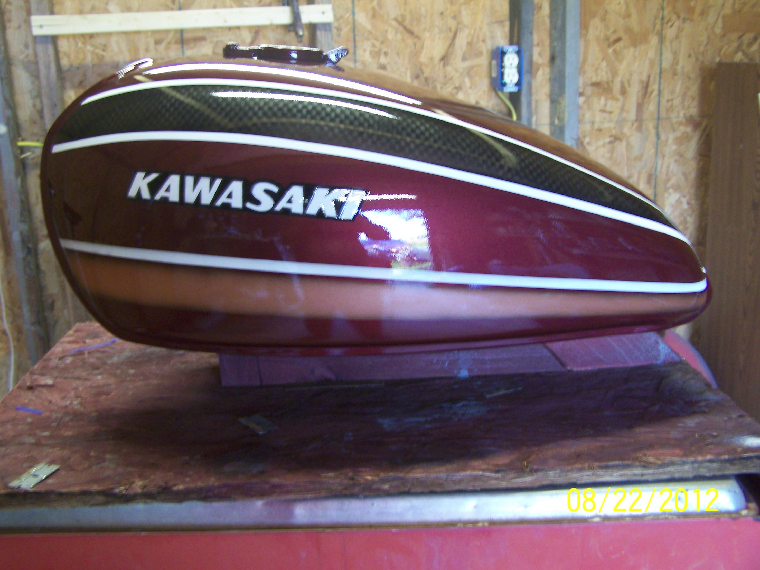

    I been out of the loop lately did some parts yesterday
    still doing the emblems so only had to chrome the face of the side covers the rest will be painted
    The headlight bracket was painted about a year ago and I just degreased it and chromed it

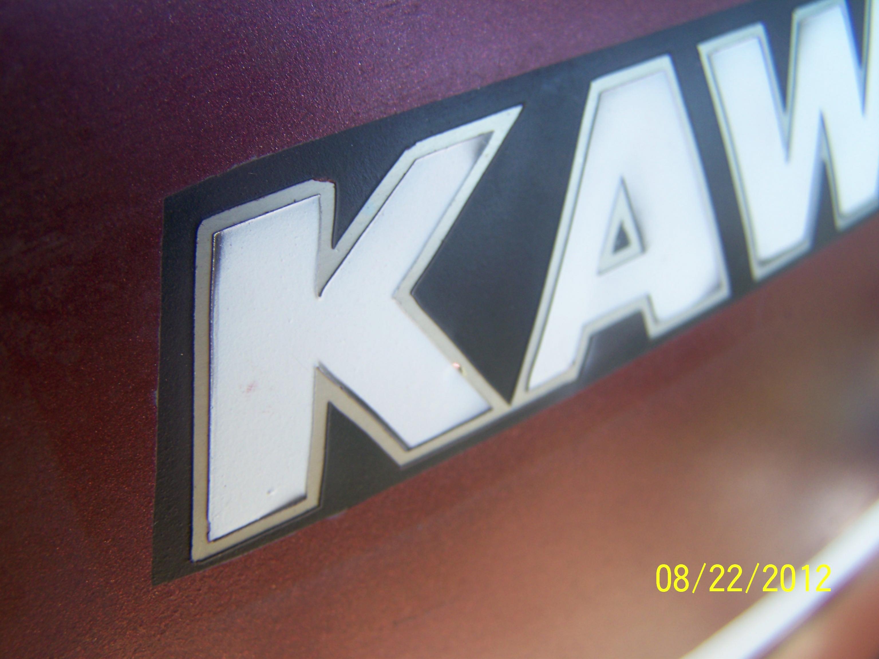

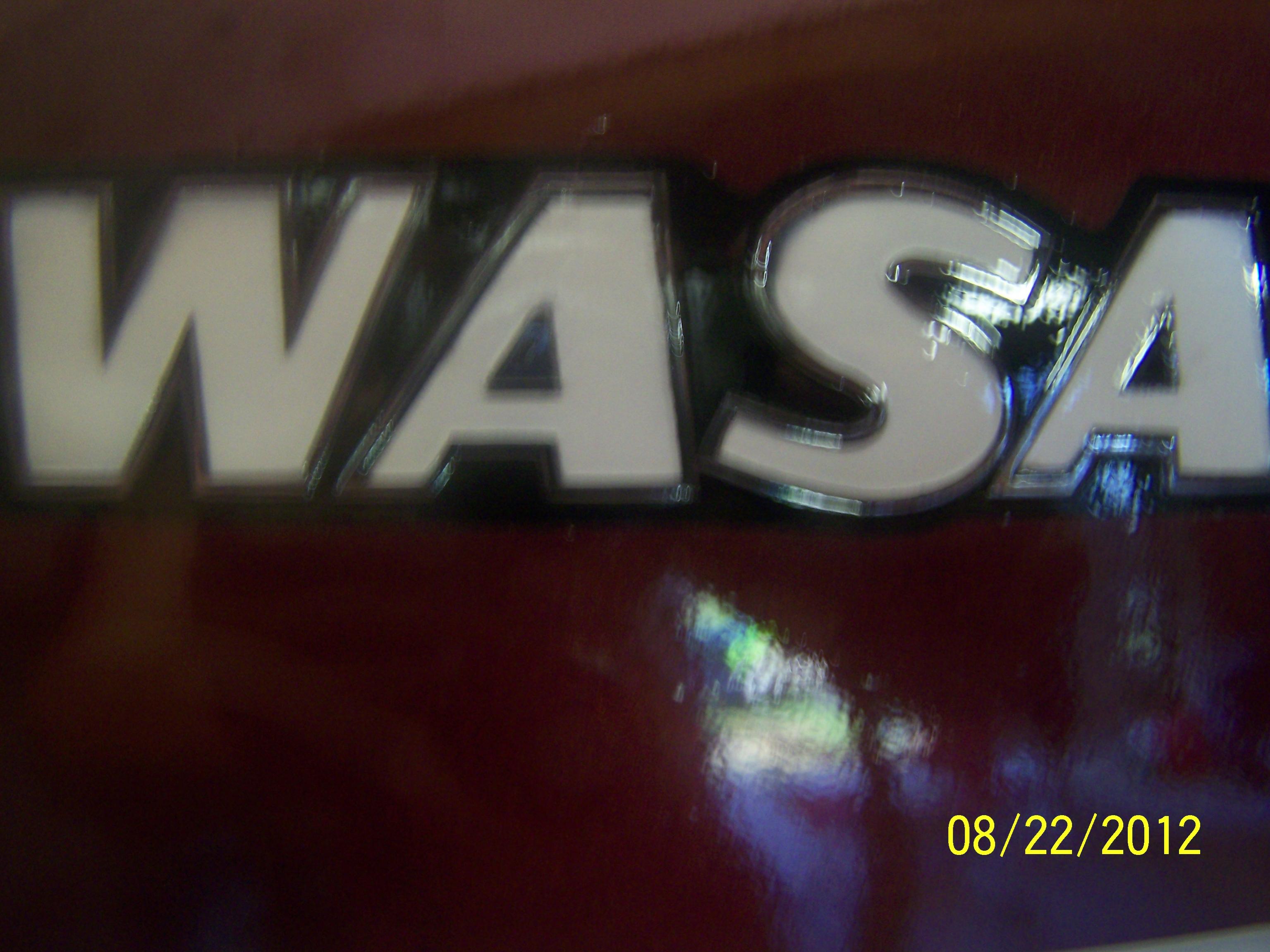

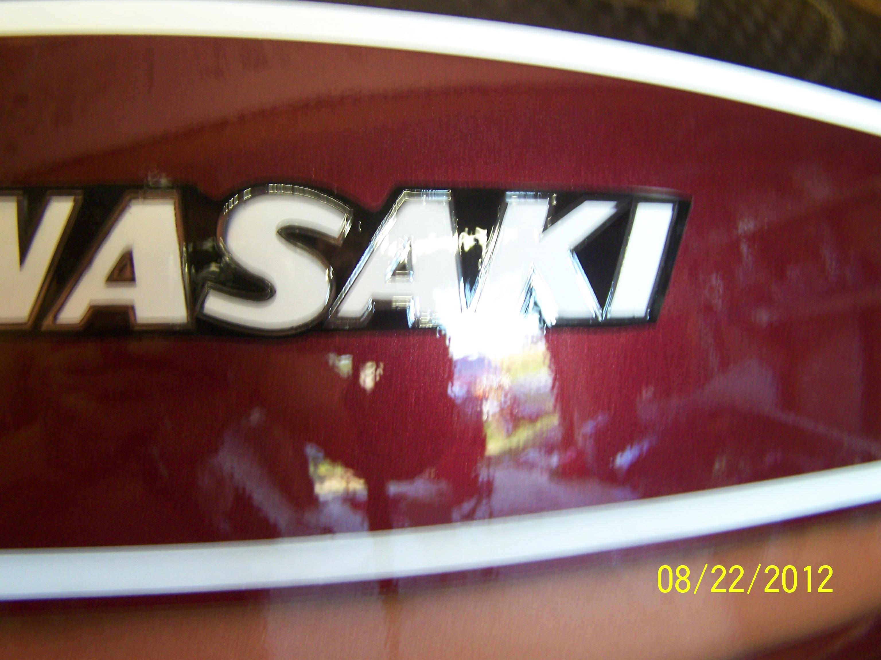

    The chrome on the emblem came out awesome unfortunately the rest of it did to so the photos dont show the chrome very well The entire emblem is painted on
    the largest pre 50"s Street rod event in the US is going on this weekend
    so I will be p***ing out business cards like crazy lol
