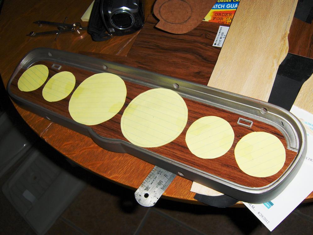

    here is what I will be painting black base coat/chrome once I get the design perfected... still in design stage... hope to move to prototype soon.. Basically, I need to chrome all the silver areas of the dash bezel..
    I actually plan to go into production with this item (for 66 mustangs that want 6-gauge bezel with the most OEM look)... anyone out there who does chrome paint in California wanna make a bid to do the chrome paint part?
    LOL
    No?... guess I'll keep tuning in to this thread to learn the trade.... :)
    www.myrestomodmustang.com
    66 Mustang GT RestoMod Machine

    thats chrome paint, its different from spray on chrome, the best chrome paint could never look like real chrome, they look like polished aluminum, but thats all..
    here check this video.. on the left s**** I used Innate chrome paint, and on the right s**** I used my spray on chrome kit
    while both have the same prep(glossy black base) only the spray on chrome can look like the real deal

    Totally get yah.... I guess I'll just have to knuckle in and learn the damn thing.... My first attempt will be to cast the bezel in black... hopefully my model is smooth and shiney enough to allow the black plastic to be glossy when cured.... then I'll go from there...first trying to silver it w/o having to paint a black basecoat... and one with to compare.. (probably will cast plastic s****s to begin with).... looked into Cosmichrome but they are hella spensive....
