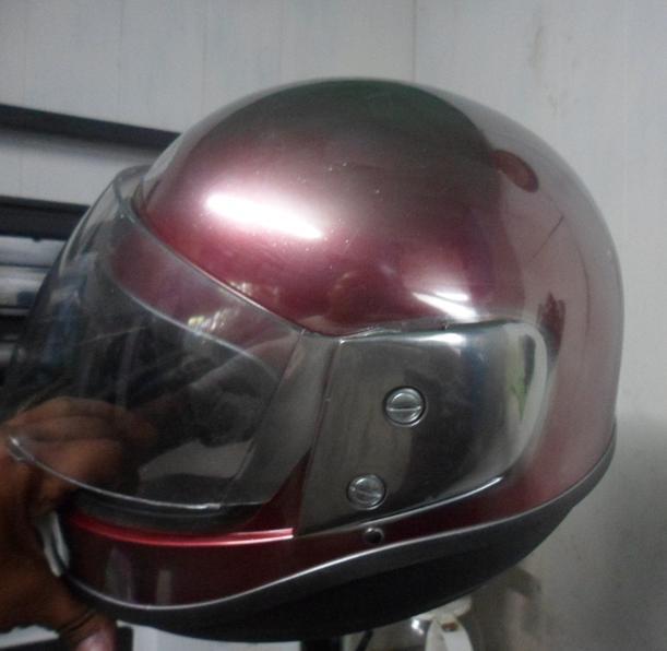

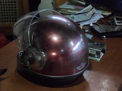

    do you see these beautiful pieces?
    now let me remind you how much effort it took me to silver them.
    this is how they started..
    I use Krylon Fusion paint, this is my glue to plastic parts, I dont need to do any other prep for the paint to stick to it and only a few dust coats are need it, you can apply one coat if you are worried about it, but I have don lots of practise with my s****s and no paint has come off as of yet..
    after dust coats of Krylon Fusion
    after 10 minutes I apply my black base coat
    then I do my clear coat(remember all is in the prep, you want a mirror? then at this step you need to make a mirror out of the thing, if you dont have the shine, no amount of silver will bring that shine again)
    and this is before the complex silvering process
    now silvered..Never seen video(not on this forum)
    <iframe width="420" height="315" src="http://www.youtube.com/embed/8xHllDIvY7o" frameborder="0" allowfullscreen></iframe>
    and now Ruined because I wanted to rush this job. and yes my clear coat was fully dry at 4 hours...But not completely cured
    [​IMG][/QUOTE]
    I had to REDO the piece I ruined. and here it finished with tinted clear..
