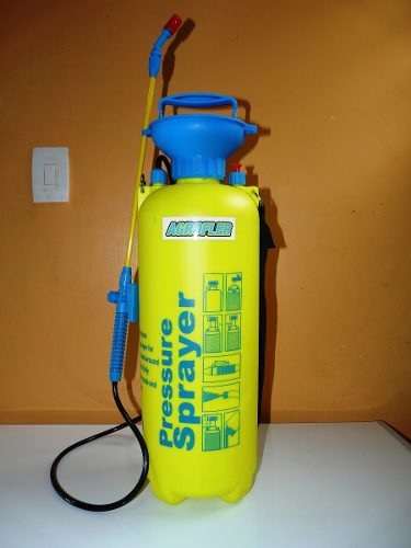

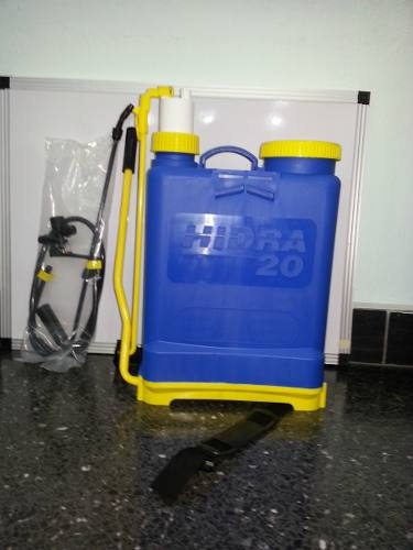

    Nicamarvin that chemicals do you think that is good for this project?
    I know that no can use dual pump hand with this project but I can build a super gun with 2 hydrojet how the gun of alsa (my little friend is how call alsa to this ) is easy for me build please see this http://m.youtube.com/watch?v=p8SleY7Eans
    I know that is some expensive I can spent a couple of thousand in this project This is my sunday car with 400 hp in the tail subaru engine turbo 2.5 with thousand of dollars in electronic transmission etc http://m.youtube.com/watch?v=5mJLUBvGu-s I no want buy a equipment of 8000 usd for use a times paint no is my business is a hobby,
    The car is outdoor do you think that the clear coat no save the silver? I see in the post a dirt bike off road of nicamarvin.
