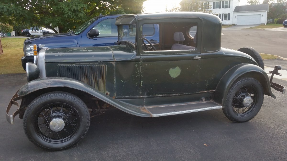

  6. Rickybop
    Joined: May 23, 2008
    Posts: 10,646
    Rickybop
    Straight and solid.
    Stored since 1970.
