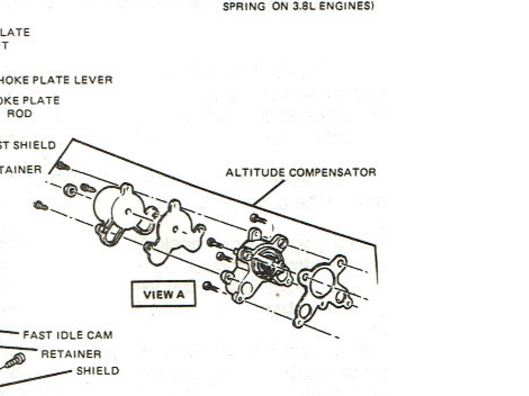

    2150 Motorcraft 2 bbl had a high altitude compensation valve on some models.

    This is what I was going to say. I have had a couple on some FSJ's.
