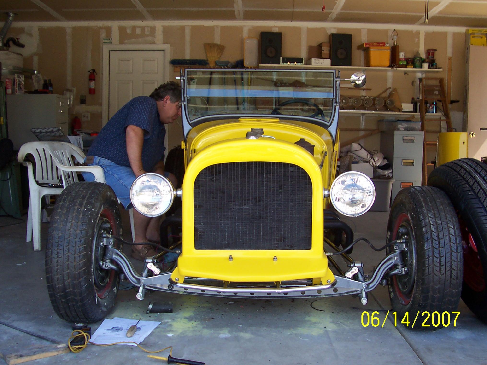

  5. designs that work
    Joined: Aug 29, 2005
    Posts: 411
    designs that work
    First picture is of my home made friction with UHMW used as friction material, no spring, steel plate welded to chassis UHMW, the arm and another UHMW and a aluminum plate with a 3/8" bolt with a nylock nut. Second picture is of original Hartford friction shocks. It does not ride like a new car but rides fair.

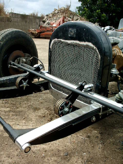

  7. simon g-s
    Joined: Mar 1, 2009
    Posts: 116
    simon g-s
    Fitted Hartford shocks on the front of mine. Persuaded as to how well they worked after a ride in a Buggatti. Look the nuts, well I think so ! Got a load of pics from a vintage hill climb if anyone wants more .
    They were pricey and need some attention to make them work well. I soaked the wooden discs in trans fluid ( tip from an old guy with a bentley )and used a torque wrench to get equal pressure on each side, too little pressuer and no control at all, too much and very harsh ride, you need a big bump to make them move.
    At some point I will move the mounting points closer to the wheels to make them work better, need to find a way without welding the chromed axle.

  9. 28dreyer
    Joined: Jan 23, 2008
    Posts: 1,166
    28dreyer
    from Minnesota
    I agree, "they look the nuts".
    I notice you have the large 506M style made for cars up to 4400 pounds with the two blades into three and the four 4 1/2" diameter discs. Also a rather healthy spring showing in the photo.

  10. simon g-s
    Joined: Mar 1, 2009
    Posts: 116
    simon g-s
    Merlin, I wish !!
    Pontiac 400, soon to be blown (up says my son )
